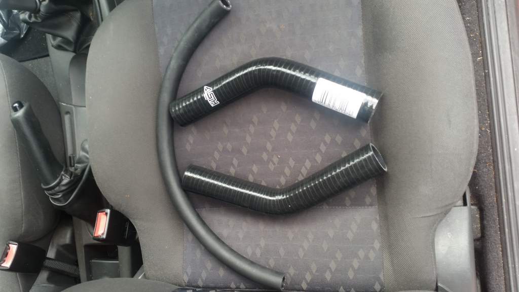

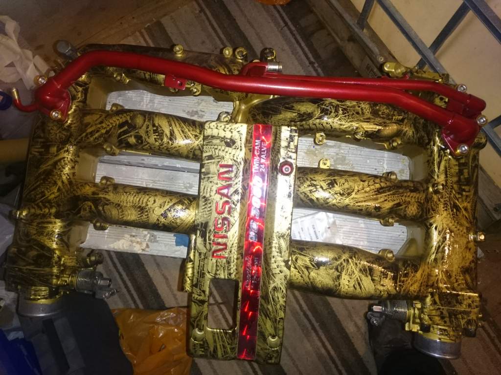

Anyway, took the balance bar off the plenum today and managed to split the hose to the brake vacuum unit.
I've got a silicone replacement I think, so will install that when I put the balance tube back on.
Finished spraying the balance tube and waiting got it to harden overnight before refitting tomorrow.

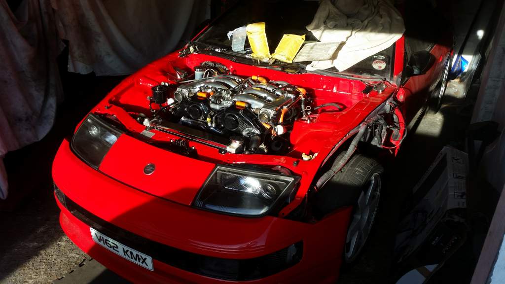

Things are nearly all there and ready for doctor dent on Saturday when he begins the surgery beneath my bonnet.
Getting quite excited now :dance:

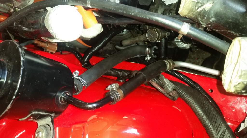

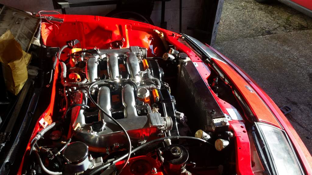

Some hose has finally arrived so cracked on with putting the recircs back in and ps hose,. Plenum on and bolted down. Most of the loom is on the engine.... stumped with a couple of connectors lol...
Painted and fitted the bonnet catch. Maf back on. Very productive day

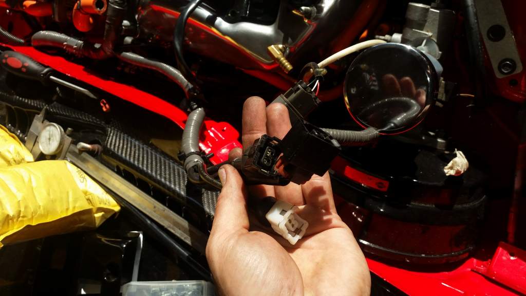

Looks like prv and boost solenoid gaz, not sure what the third one is. I'd guess AIV but I thought there was only one solenoid.

Those plugs you have in your hand look like the three that are usually held by the plate that fits to the side of the plenum and are secured by the balance bar nuts.
I believe one goes towards the drivers side of the bulkhead and the other two plug in to connections along the inner wing somewhere..
I'll see if I can get a decent photo of mine to help identify them for you
