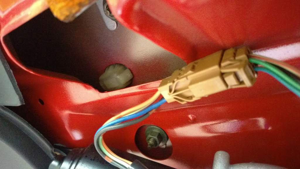

Nothing done as such but I think I've located the leak. The spoiler clip pictured below has been dripping (middle of the picture).
I suppose the first thing to try is some silicone around the base of the spoiler. Could also do with replacing that rusty retaining clip from the trim but I assume that's not available on its own?

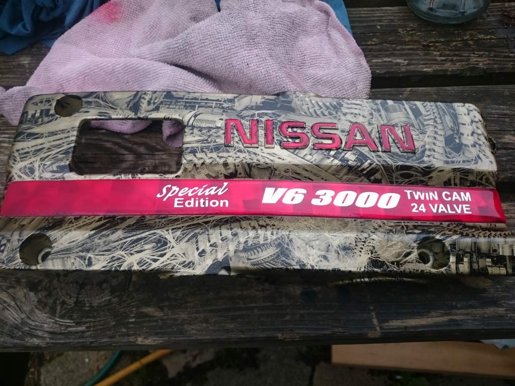

As I can't drive her and ihadthe throttle cover off, I got busy sorting the dip for the throttle cover..
I must say I'm extremely pleased with the results.[ATTACH=CONFIG]98320[/ATTACH]
Does look awesome!
Are you able to clean a bit of the dip around "Nissan" to make it a bit more prominent or was that the style you were going for?

I think the photo doesn't reallt show it so well but the red lettering is holographic and does really stand out.. I masked it off around the lettering so that the dip would cover right up to it so there's no gaps.. Dip can be a real pain to get clean lines around taped areas aswell so I'd aimed to cover right up to the lettering Evaansss.
Very happy with it and I'm hoping I've ironed out all the bugs with the plenum dip. If it comes out as good as this has then I will be one happy guy!
It's all going off to be fitted very soon so I have to get the plenum finished and the hard pipes. I'm starting to gather all the engine dress components together now ready to transform my engine bay in to the wonderful creation in my head... I'm sure it's not going to be disappointing when I see her again after the transformation... Very exciting times for me!

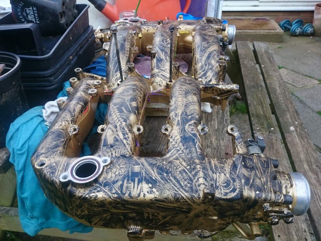

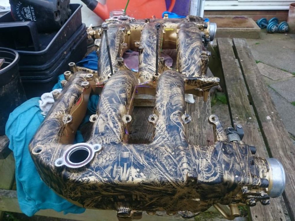

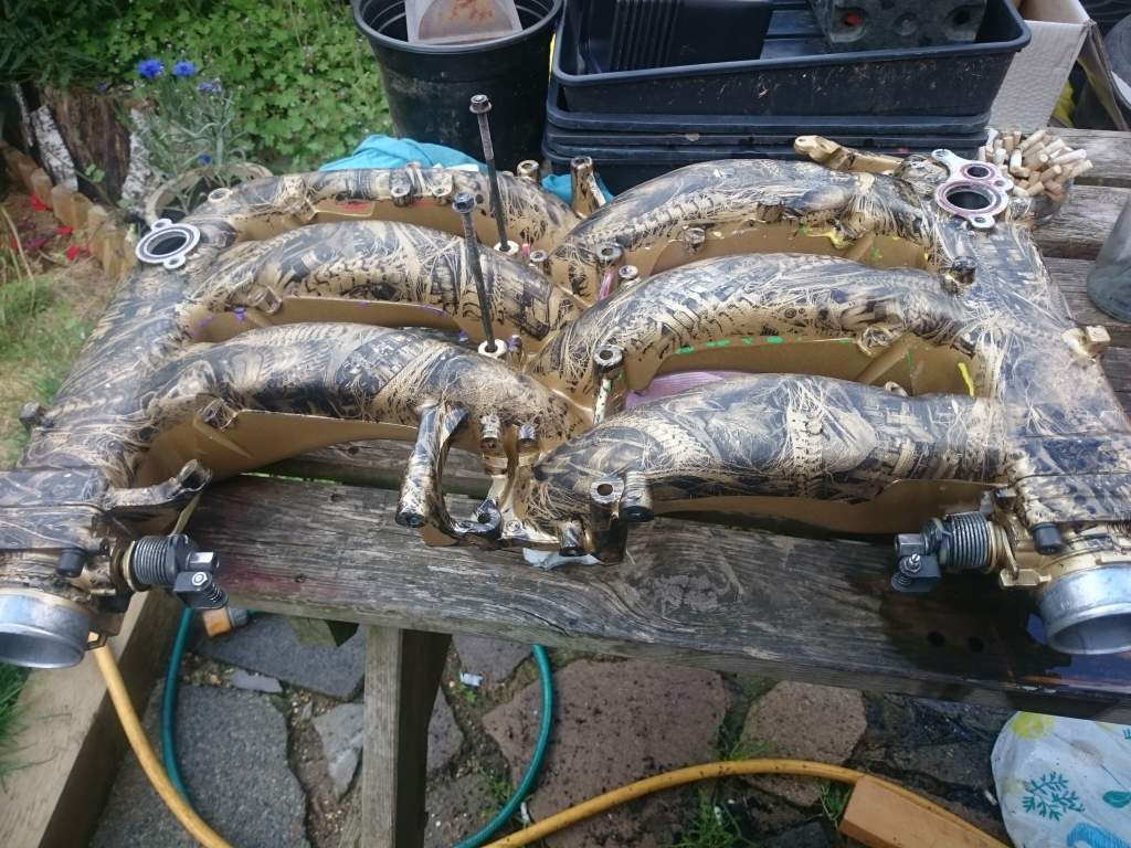

Well, the plenum was dipped today and I have to say that the results are pretty damn good.. A small amount of touching up is required mainly due to the complexity of the shape causing the film to break around certain parts but all in all its a great result.. So I say to the pro's that say it couldn't be done... Put that in your pipe and light it!
This was taken just after being dipped and still needs lacquering which will be done tomorrow after I've finished the touching up.. Tomorrow it will be All shiny.
Hate to be picky but I believe it would have looked nicer to start from the other end so that the gaps from the film breaking would be on the other side, which you wouldn't see as often.
But the pattern came out good, you should be happy with the result from something that fiddly :)
If you look closely Alic, the gaps where the film broke are on the other side.. The small bits of colour you see are bits of plasticine which was used to block off the gaps between the plenum manifolds. The film stops exactly where I taped it off which is along the casting line naturally present in every plenum. Once the plenum is in place, the rocker covers and everything else which fits around the plenum will fit to that line..
The breaks in the film were caused by trapped air due to the complex shape. The part must be dipped at an angle to allow the air to escape naturally but the shape of the plenum doesn't allow for this. The result you see in the photo is about as perfect as you can get, believe me I have done an awful lot of homework on this project before taking the chance of ruining the plenum..
Once the touch up has been done, you will only notice the small imperfections in the print if you are seriously looking for them..
To be frank, I'm over the moon with the results considering the top hydrographic dipper in the USA said that it could not possibly be achieved..
It wouldn't have mattered which way the plenum was dipped, the angles of the plenum would have caused an imperfection somewhere along the line.. I believe I chose the correct way and ended up with as little touch up work required as possible given the complexity of the job..
So yup, well pleased!
[ATTACH=CONFIG]98364[/ATTACH]
[ATTACH=CONFIG]98365[/ATTACH]

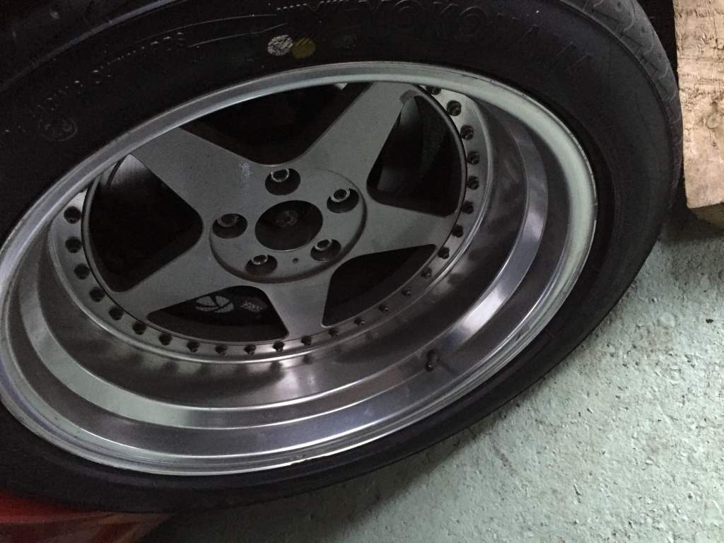

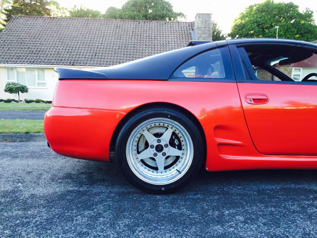

Had some new rear tyres put on today. Yokohama 295/35 (x18) I previously had 275/35 and I knew that the rolling radius was going to get larger, but I didn't bargain on the quite so much extra tyre overhanging the wheel rim. Oh well greater rim protection I guess. Will definitely need to adjust the coilovers as they are rubbing on the fibre glass wheel arch/lip a bit.
I need to post some better pictures as it was a bit dark, and it doesn't really show the excess tyre I'm on about
