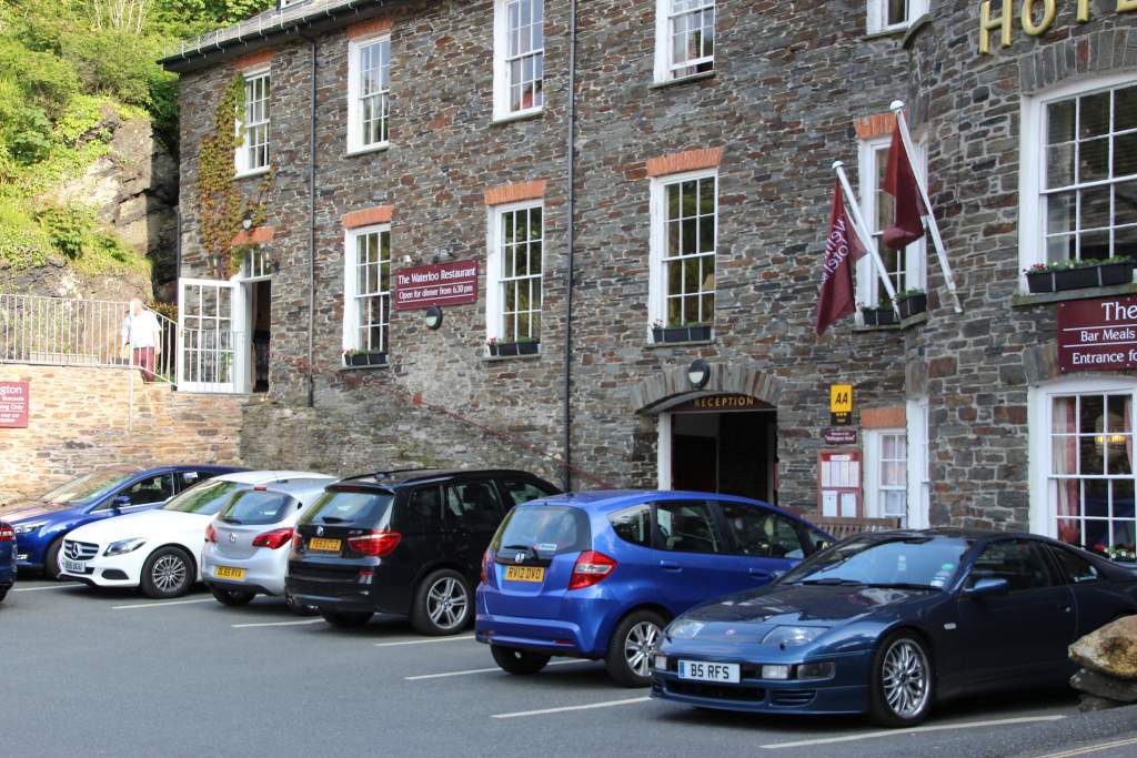

Ahh the "Welly" in Boscastle! Stayed there on hols many years ago. Guy Gibson's
(of 617 Sqn The Dambusters) “favourite hostelry”
Yup - and we often have "his" room; either that, or the Thomas Hardy room....:cool:
It's amazing how that place has been rebuilt after the floods.
I saw Boscastle before and after the carnage and the rebuild is amazing.. Beautiful place...

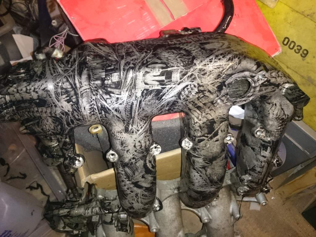

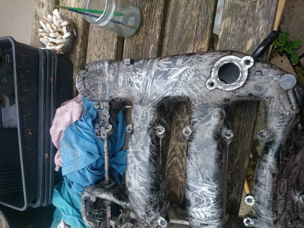

Well here's a pic but i didn't bother to rinse the pva last night so it's a little messy.. Shows how dirty it was when I dipped it too lolDSC_0276.jpg
if you powder coated the it first then dipped it it would look bright.
Yes I know danoo.
I didnt even clean that plenum before I dipped it so it's very dark cos the plenum was filthy.. The plenum I posted that is coated in gold is the one that is going to be dipped in this film.
It will look stunning against the brightness of the gold coating.
I have to wait now until the silicone rubber arrives as one of the reasons I dipped the old plenum first was to test the process and find out what effect the shape was going to have on the way the dip laid on to the plenum.
As the dip does not turn completely liquid in the process, it actually has a very thin layer of pva that remains beneath the print, so as you push the part through the film, the water pressure presses the pattern against the surface and acts like a mould and a water barrier to prevent the actual design being washed away during the dipping process.
Due to the shape and size of the plenum manifold, the depth of the gaps between each branch is far greater than the width between them.
In order to understand the process or explain it in a way easier to understand, if you took a piece of cling film and layed it on the water surface, then pushed a part through it, the water pressure will press the film against the part and take the form of the part pressing through it. If the gap that the film is trying to fill is of a larger surface area than that of the film, it will stretch until it tears and any part of the ink that becomes waterlogged will not adhere to the surface.
Due to the results of the test dip, I have backfilled the gaps between the manifold branches to seal them off and forming four pools if you like. I plan to fill those pools with liquid silicone until the surface area that remains is close to being equal in order to keep the surface tension on the film low enough to prevent it from breaking and get full coverage of the visible parts of the manifold.
