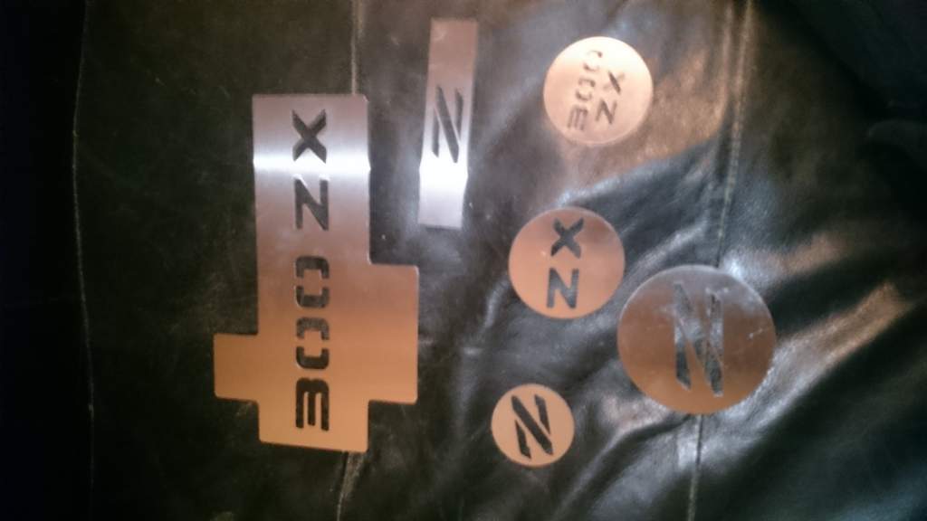

Received a package today with some engine bay bits in it..

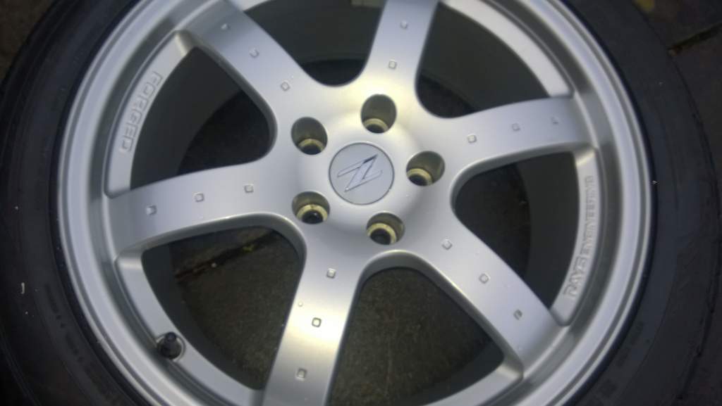

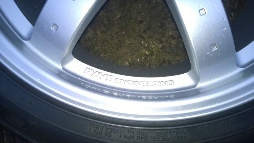

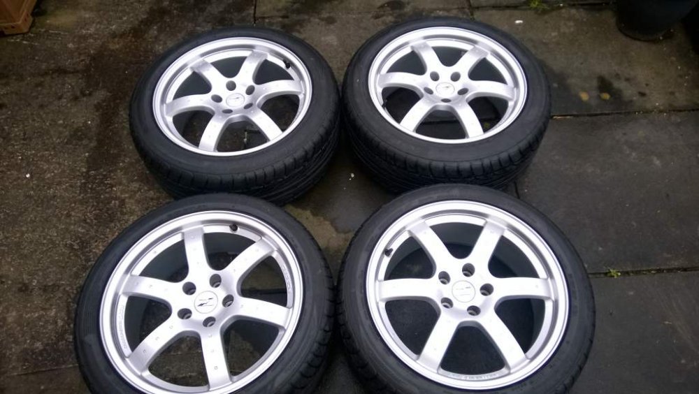

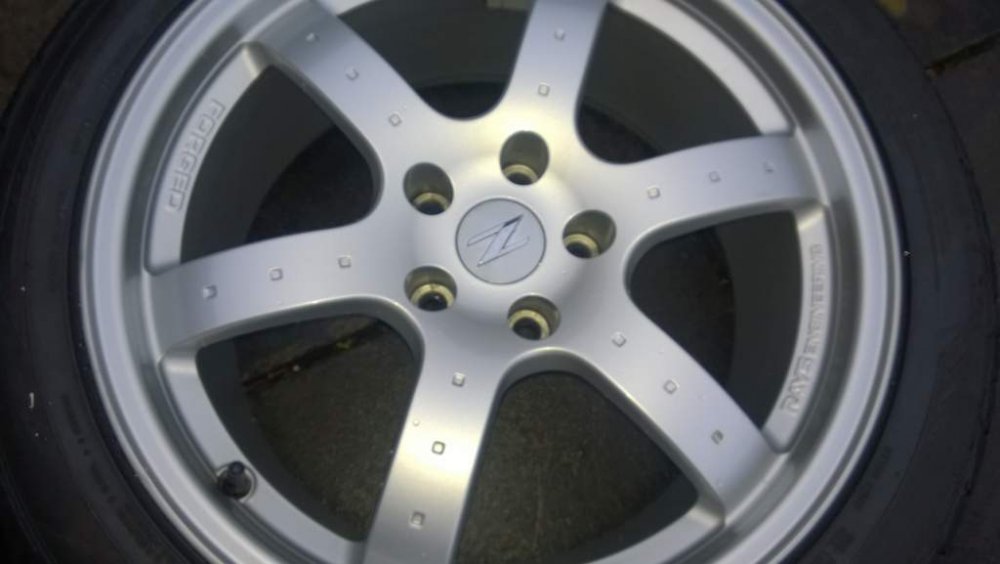

After picking these 350z Rays track v1 wheels up the other day, I've finally managed to give them a good clean and got a nice thick coat of Wax on them ready for putting them on the car this week when I pick it back up from Keith's. The last pic I the most upto date pic I've got from Keith... Getting very excited now, think its looking pretty good!
Really happy with the wheels though... They came off a garaged 350z that had only done 14k miles... Near perfect tbh... No curb marks what so ever;)

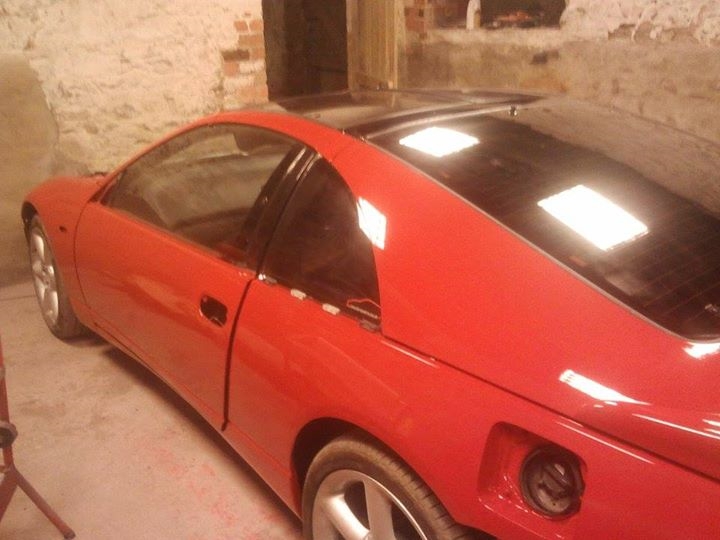

Today, I gave the Zed a wash - it was looking a bit dirty after I had used it all last week...... It's tucked up safe and dry in my garage, now that the rain has started....:cool:
Plus I fitted my new "hybrid" windscreen wipers (thanks for the link Si....... :thumbup:) Oh, and replaced the OEM rear wiper for a brand new Laguna Mk2 item; granted, it's a bit more "chunky" but it does make a nice 21st century upgrade!

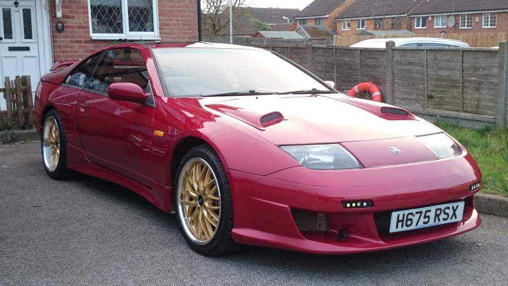

Finished all the cleaning and she's gleaming again...
And now.... It's raining again... :cursing:

I can't for the life of me understand why you'd want to fit a big ugly Veilside bumper to this car. Strange bonnet vents aside, it looks really nice! :)

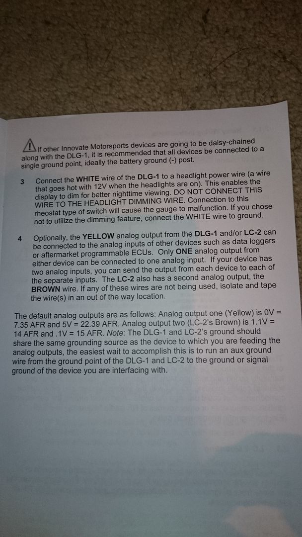

My innovate dlg-1 is here now, what information did you want on it again? Looks like a good bit of kit, cheaper then 2 separate units too.
All I want to know is the 5v out put, when is it triggered and how. Ie does it send out 5v constantly unless you run lean/rich then take the bolts away or vice versa.

You'll be happy to hear that I'm not fitting the veilside front end Si.. At least not for the foreseeable future..
I'm sure Alic will smile also when I say I've removed the Z32 from the perspex strip..

No offense but you have fake hood scoops :rofl:

Not implying you're stupid but
Fake vents = same thing as fake nos stickers (IMO)
