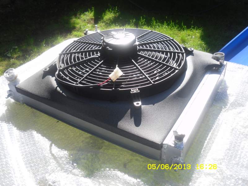

Finished the Fan shroud for my electric fan conversion.... sat in garden for 30 mins and imagined the Z was on the road and I was driving with the t'tops out.....lol
Nice work Joely P...... looks like you have been enjoying the sunshine in essex as well.......lol

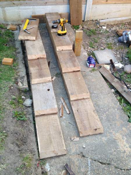

Got some reclaimed wood from a local timber yard and knocked up some ramps. It was slightly more 'reclaimed' than I hoped to be honest as a good 30% of it was spilt beyond use, more than half of it was warped and twisted and all of it was a mixture of widths in and around 9" but I made it work! Should help a fair bit as jacking can be a right pain in the hoop on my driveway...

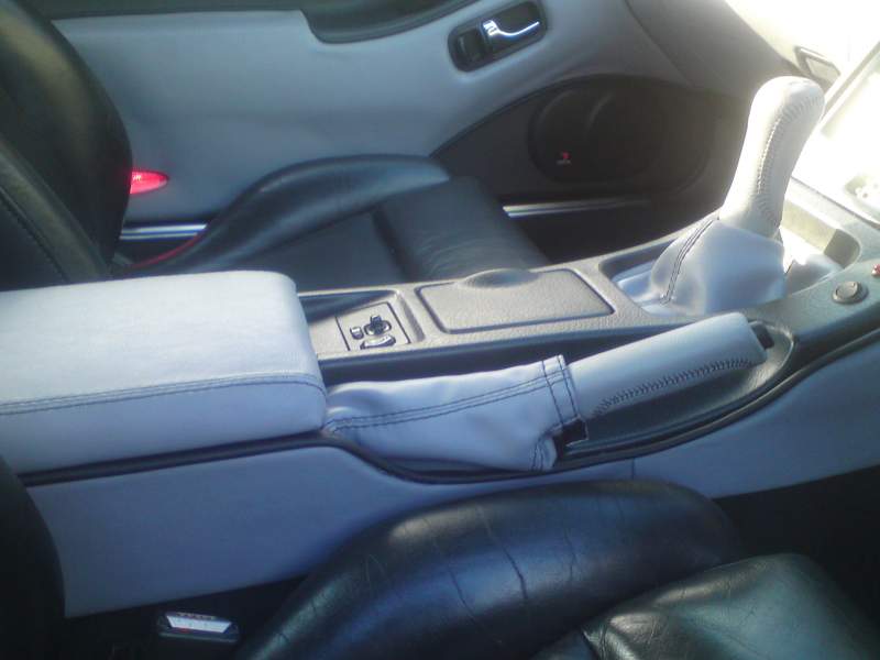

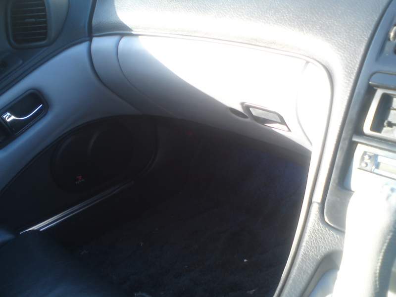

I'm not a trimmer but I take care and time with the jobs I do and having done the doors the other day, I got more made up and have done the piping all around now including under the steering wheel :yes:.
Took my inspiration from the great mondo for the doors but the rest I aint seen before done and I think it's turned out very well :thumbup1:.
I like that Andy, gives it a nice sense of depth and finishes off really nicely. Did you get the piping made then glued it on or did you buy a roll from somewhere?
I think it turned out extremely well Andy :clap: very professional mate:yes:

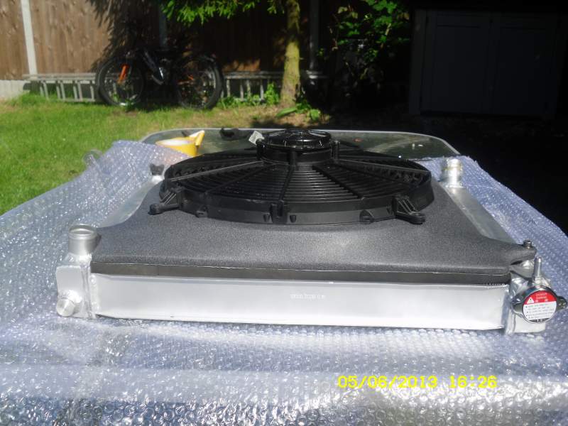

I finished making my electric fan shroud and it is all ready to fit....SDC10165.jpg
Initially I was looking to buy some cord or rope from ebay but I have an upholsterer friend so went asking him, they make it up by just cutting out a 2 inch or so piece of fabric and folding/stitching it around a length of like cotton wool tubing. You can see it clearly as it runs down the top sides of the center arm rest. In the other areas I forced this 'flange' under, the only bits I hot glued were on the roof of the glove box and a bit under the handbrake.
So should I need to remove some panels it will just be a case of forcing it back under again.
On the doors I cut this flange off as close to the stitching as possible and used hot glue to hold in place :thumbup1:.
[ATTACH=CONFIG]70930[/ATTACH]
brilliant work sir
