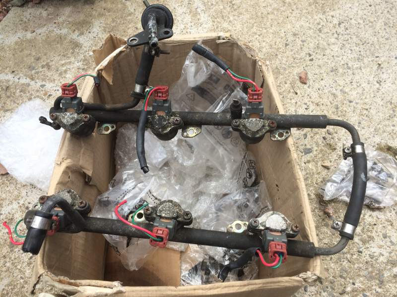

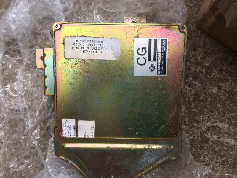

Went rooting around the shed to get parts out from 5-6 years ago, Z is hopefully going in next Monday so I've to get everything up to the garage..
555 injectors and JWT ecu

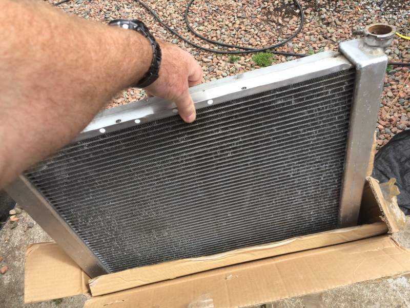

Koyo Racing Rad, I got this off Slick Pete in 2009!!

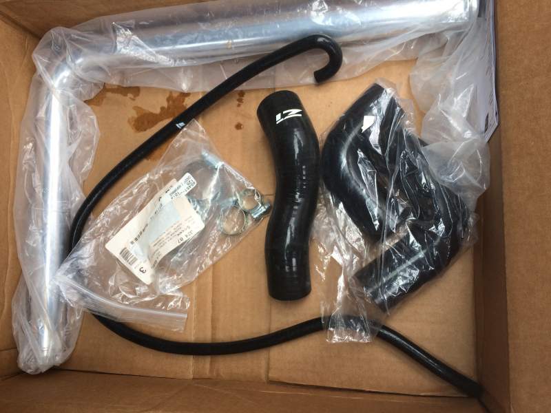

Z1 performance Rad pipes
[ATTACH=CONFIG]89881[/ATTACH]
I'm going to have to do a build thread

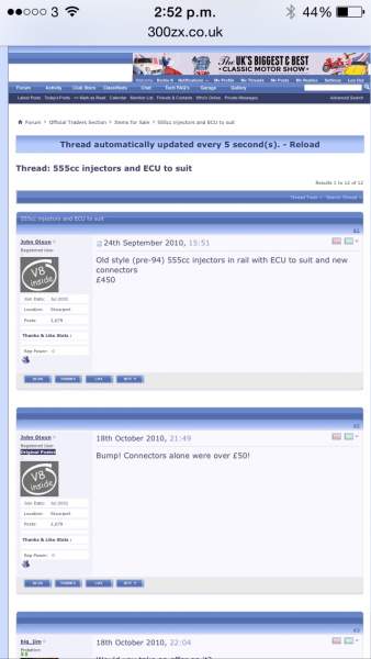

What make are them injectors ? Looks like stock
God I hope they're not, I paid a lot of money for them after being ripped off for a set once already!!!
John Dixon would have been a straight up guy and I trust he didn't shaft me..

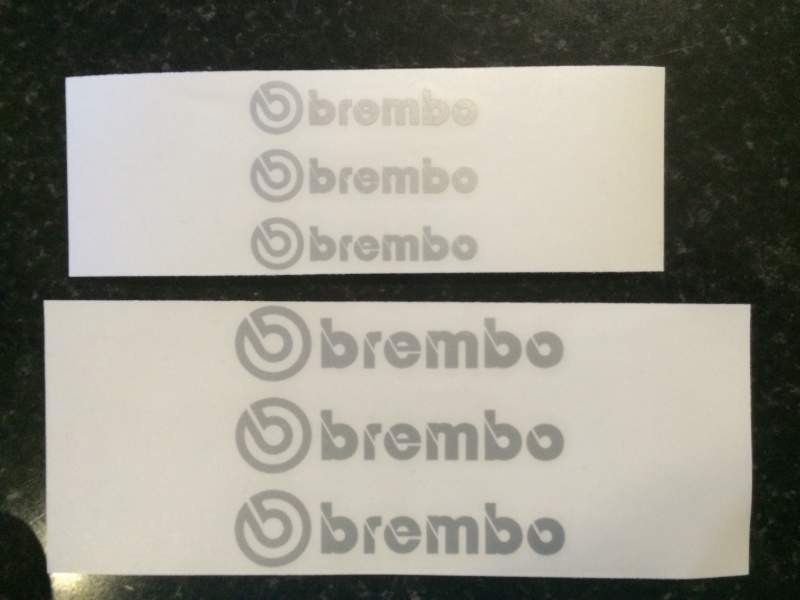

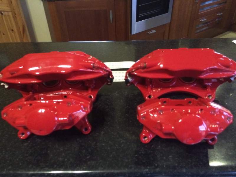

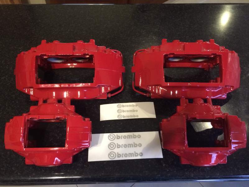

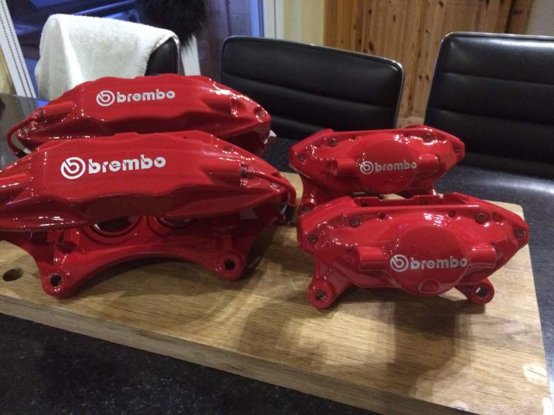

Got to work on the Calipers, gave them a good clean and applied my new Heat resistant Logo's. I went for silver rather than the usual white logo's.:thumbup1:
Before
After
Think they look totally different and really classy with the silver breaking up the red.:bow:

Makes a difference that. I'm going to utilise some Nissan logos on mine, to match the rear and have a more subtle look.
Caliper porn! Do yourself a favour with the injectors Richie, get the flow tested and (if required) ultrasonic cleaned.
Thanks Joel, yeah, I may get them tested. I don't think John Dixon was the type of guy to shaft anyone, but I'll be well pissed if I've been F*cked over again especially since the last time was over a fuel rail and injectors also:whistling:.
I'm going to be fitting the rear Evo's also Steve, so they'll all match up nicely. There are two places designing brackets for these rears which enables you to run bigger discs without interfering with the brake bias much. In fact it will have the same bias as the R34 GTR's.:punk: Should have some news back on these in a month or so:thumbup:

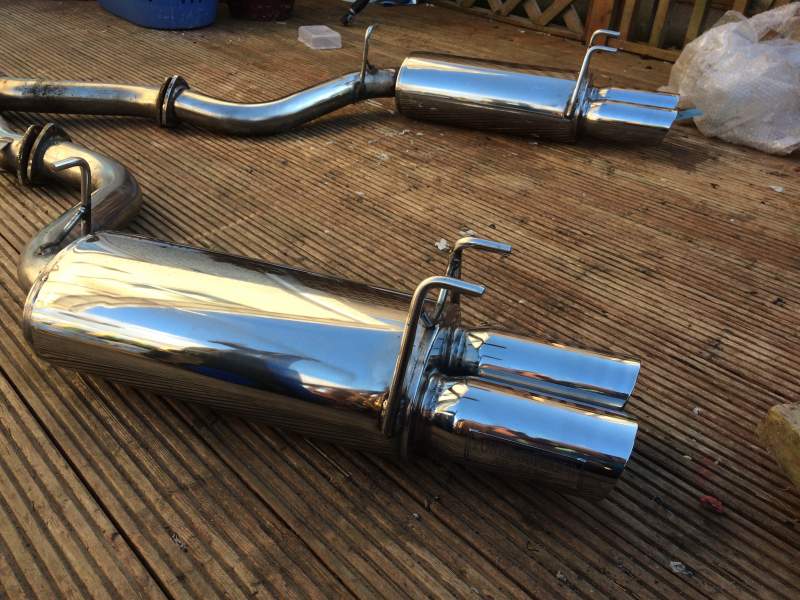

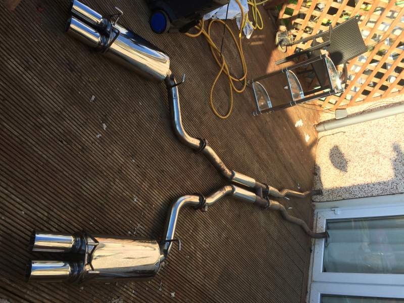

I collected a possible new exhaust from Jimmytt yesterday and met with the guy's who built his one off exhaust system for him..... Nice and very talented guys down in Orpington Kent.....
Their welding is gorgeous and they pay attention to detail......
Here is a quick before and after when I got home and started to clean off years of oil and muck.....
Top one is degreased and quickly wiped over with fine wire wool and the bottom is the caked with dirt and oil one......
Thanks again to Jimmytt for this to help me get to JAE....
Tonight I did clean the other one, just need to clean the centre section and plug the threaded hole up......
I don't mean necessarily to see if you've been shafted, chances are they'll be grand, but as they're used injectors and have not been used for sometime, it makes good sense to ensure they're performing well. A flow test will cost around £30 and if they need cleaning, you'll be looking at paying around £90 total, a small price to pay for piece of mind of such a critical component.
