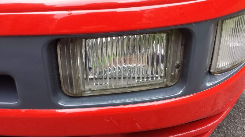

The paint is cracking just below the corner of my passenger fog lamp opening on my front bumper where a previous small crack repair was done. The paint shop is going to scallop out the area and do a proper repair whilst the bumper is fitted so it's in its settled position. There's also some slight crazing in the paint under the lacquer in a small spot on the rear bumper just above the number plate so they're making that good too.

Are you missing a screw cover on the fog light Joel?

What a pain in the ass. Mines got a few of those, there in again mine wasn't resprayed in the last six months. I believe Hoover said he has the same issue.

It looks as though they aren't originally covered - https://conceptzperformance.com/Cart/description.php?II=2641
Hmmm, are yours covered Gary? As Dutchgold says, they don't come with covers as new lens assemblies and my old ones didn't have any fitted...

Ah, you're referring to the end pieces that go from top to bottom each side? If that is the case, mine are all present [emoji106] I guess the picture I deceiving.
Ah yes I see them now :thumbup1: Now on my laptop and the bigger picture helps my poor old eyes lol

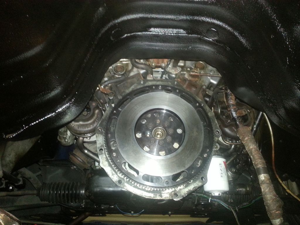

Jwt 500 turbos done. Knock sensor. Rear crank seal. Light weight flywheel. Underseal. Not waisting my hollidays :)

did you fit turbos with engine in ?
Easier then i though :)
I've eyed the job up a few times. I didn't think it looked that bad. I'm guessing you undid the four bolts that bolt the turbo rob the manifold rather than removing the manifold?

Passengers side removed with manifold. Drivers side just turbo
