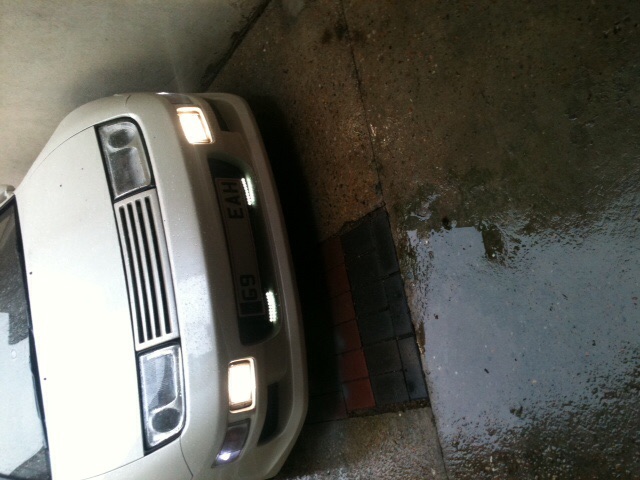

Changed the near side main fog bulb!
Maybe no big deal but it now shines brilliant!:biggrin

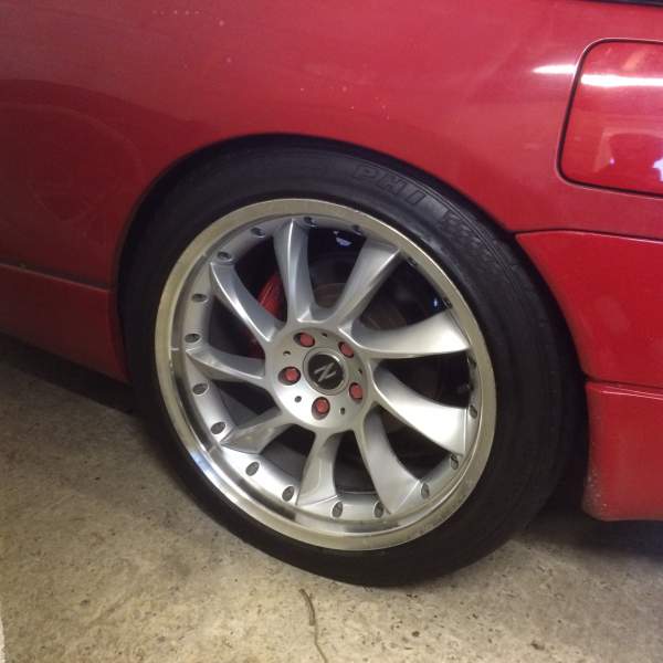

Hi finall got my second hand wheels from Osty1 fitted look nice.

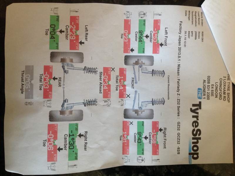

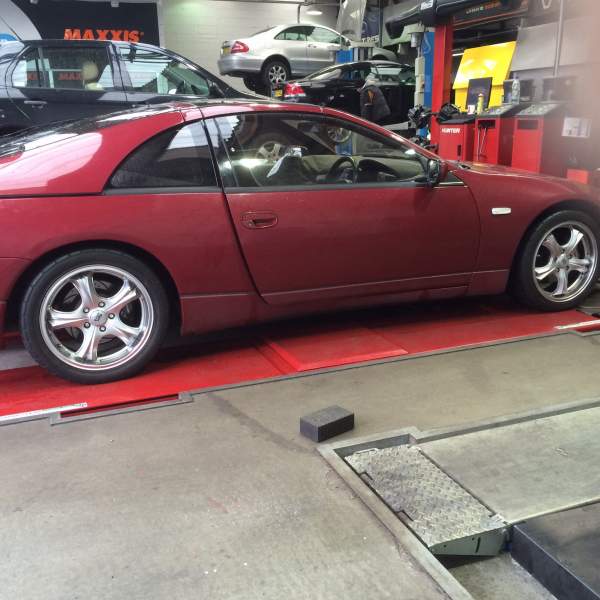

4 wheel alignment, seems like I need to do some work on the suspension.

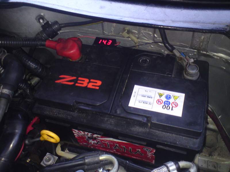

I fit the voltmeter at the start of last week, when running/charging it's in excess of 14v.
About Weds it was on 11.9v and the car started no bother, ran it for a bit then locked it up until when i look today and it's on 12v exactly (thought it might be on less with the alarm set, etc).
I was worried about its 'dark current' but i like the little thing and it gives me a very accurate glance charge indication :thumbup:.
Fyi, car is sorned hence no battery clamp currently fitted.
Where did you get that?
£2.77 from the far east on ebay, there's loads on there.
Just crimped ring connectors on and stuck it on the battery ledge with some silicone, so when i lift out the battery it comes with it.
Looked just now and from yesterday's 12v it's now on 11.9, expected drop after central locking several times and lots of courtesy lights switching on/off briefly.
