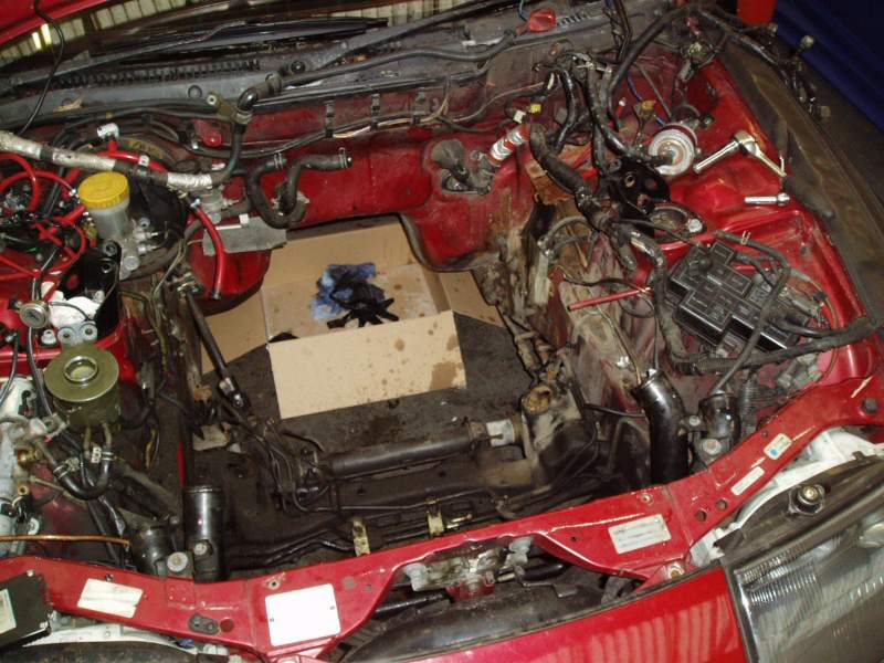

So case in point, this zed presented with a very smokey drivers side exhaust, in fact quickly filling the workshop so something was well wrong, the owner had recently ( 2 weeks previous ) removed the engine with the help of a couple of mates and fitted a pair of new turbo`s following the complete failure of the drivers side turbo.....erm yes same side again! Having spanked the best part of £1k on the turbo`s oil gaskets, ramp and tool hire , butties and beer for his mates this was a very unhappy owner, having covered just 10 miles before the smoke returned with avengeance.
So with the previous trouble been recent and ongoing the engine was whipped it for a looksey.

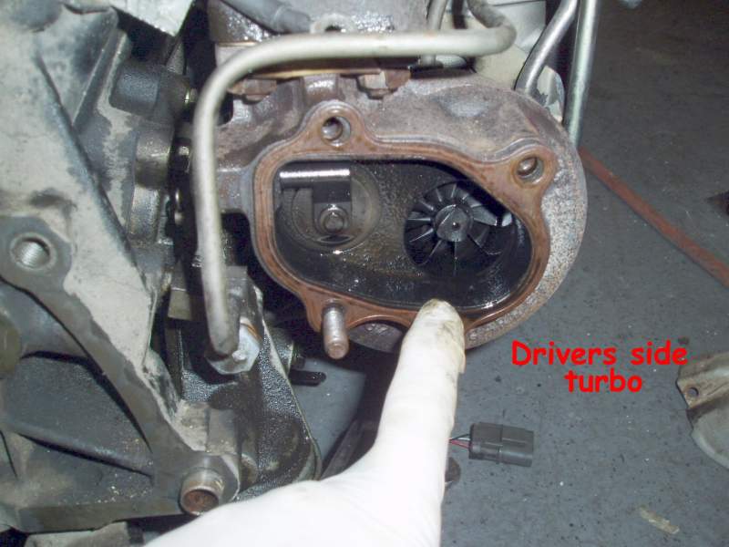

The new turbo`s were well.... obvious and seemed bolted up reasonable well, except for a few clips and bits ( the loose bolt in the pic is a bit of a slip up though)

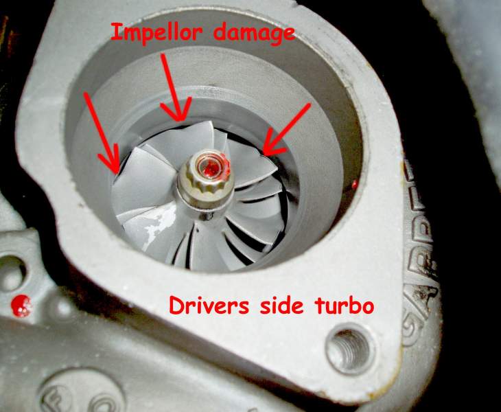

The clearly damaged o/s turbo was removed and returned to the turbo supplier and we set about looking into what had happened at engine level whilst we waited for the report on the turbo unit.
We rotated the engine and performed leak down test on all cylinders, the results were not great but not looking in anyway responsible for the turbo damage.Oil lines were removed and blown out and all seemed clear, the sump was removed and the pick up checked, and all seemed clear.

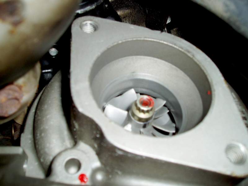

The report came back from the turbo company and was very detailed, the unit had been stripped and all parts inspected and the part damage was detailed, the shaft bearing had been electro scanned (?) and the results were conclusive, the bearing damage was done at the original start up! the ownder had been adamant he turned the engine over with the fuel pump fuse out etc several times, so what was the cause? back to the engine, the suppy tubes were all ok but we looked at the feed from the block a little closer and by blowing back from the gallery could see little strands of orange......yep silicon sealant.

Sorry to see this, how did the sealant get to the turbos? the pickup has a gauze on it does it not? that should stop any large items from being taken through the oil circulation system. Unless the oil tree or something post oil pickup has had sealant put on it? bit confusing that. I suppose the failed bearing caused excessive shaft play which was the cause of the impellor damage?
