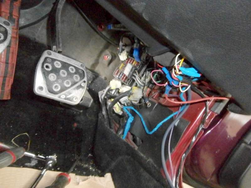

To anyone who has done a fuse box removal knows well the rather un-natural neck breaking , back cricking, arm and hand wrenching position you have to work in, but when the result clears two issue`s in one go it has to be worth it.
Todays workshop folley was presenting a rather strange habit of loosing all of the volty sparks from the battery after two or three days, the owners had tried a couple of new batteries and alternator checks passing with flying colours, the thing that made this even trickier to find was that occasionally such as when owner went on holiday for 2 weeks upon his return the engine fired up with no problem?
Leak testing for stray battery sparks was made several times and with out any real issue been found, with something like less then 0.07amps when locked and the alarm on which is perfectly acceptable.
So it came to us for a longer four day test, this was done with checks done at 3 hour intervals and over the four days and surprisingly when all the data was put together it was found that when the drain was worse during the daytime! and was also raising and lowering through the test period on one occasion raising to 0.75 amp which is way too high and would leave most batteries dead within 90 to 100 hours or 3 to 4 days. however this figure did only display once.
So as the fuse box is often the culprit behind most of these kind of issues it was removed and inspected, however as it was removed the connectors were revealing the all to often nasty green colour and when the fuse box was actually removed completely all of the relays was removed and everyone of them were very corroded.
Been within reach of the targa drain it was checked and you can guess the rest, disconnected from the drain point meant water had been pouring over the fuse box for goodness how long, now I know the targa drain and fuse box issue is a well documented having done a few threads myself but what makes this one stand apart was the fuse box was working 100% with no obvious electrical problem it was only the flat battery issue that prompted looking into it, so just because you zed seems to be working in this area does not mean all is ok, so said before I know but check the targa drains by pouring a small amount of water down the drain hole to check it comes out of the sill area.
The carpet was not that wet however there was a sense of moisture in the area and the extra drain during the day may well be due to the daytime sunlight slightly warming the interior so raising the humidity of the air within the car which would increase the conductivity of the green mess on the connectors and relays, ventilating your car when ever you can should help.
