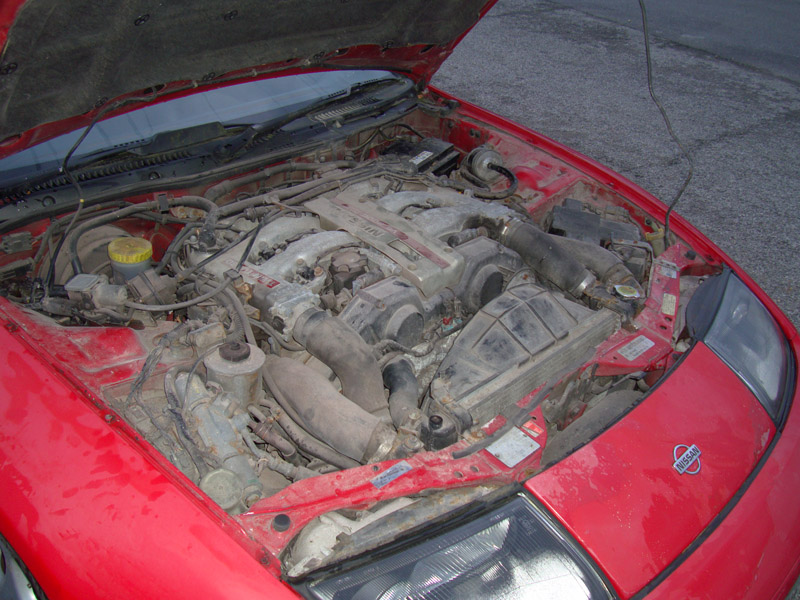

thats the engine bay lovely aint it
Thats what im hoping i can supply all the tea and biscuits needed lol
[ATTACH=CONFIG]68981[/ATTACH]
I think its fair to say thats one un-loved engine bay:no:
lol i was think along those lines as well, or more the case of holy sh*t have they been emptying the ashtray and hover bags in there!
meant hoover bags
