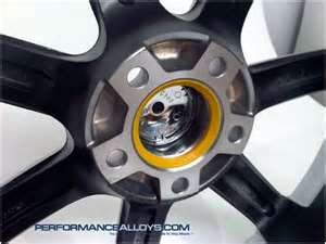

OK...I'm thick, Ive got same problem and its been diagnosed as prop shaft centre bearing, where the fook are the spigot rings?? :)
They go inside the center of the wheel, they take up any slack between the hub and the inside of the wheel.
Paul
Paul
OK thanks Paul, if any one has a piccy to post that would help. Had the vibration with stock wheels on, when I changed the wheels I cant say I noticed anything unusual??
Here you go, the yellow part is the spigot ring. You need 66.1 to what ever you wheels are.
Paul
