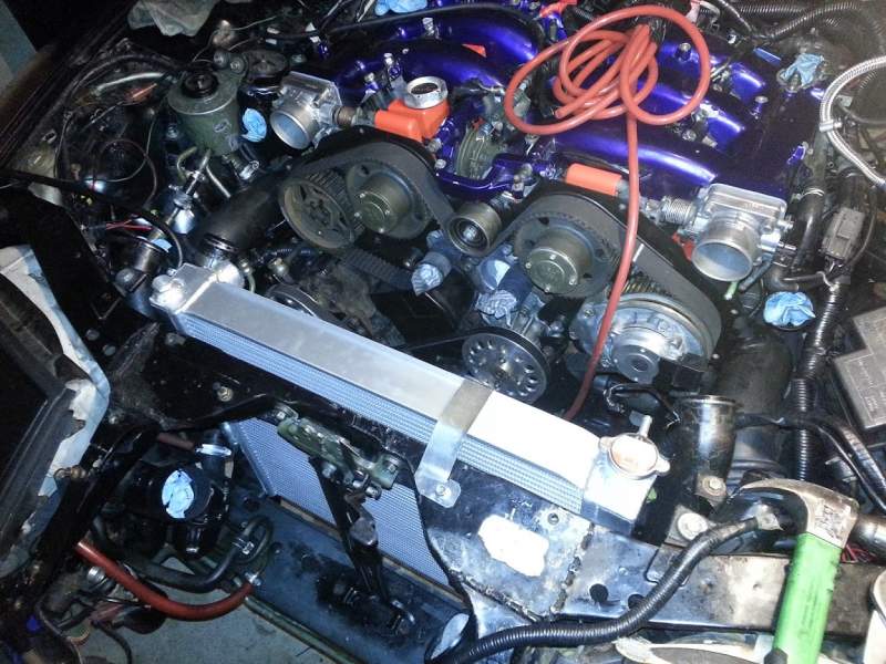

Ok, got a lock out bar fitted and i am now looking to remove the rest of the gubbins from the inner wing. Now could someone just verify which of the pipes need cut and joined? Here is a picture of my set-up:
Seems slighty different from some iv seen.
Cheers in advance
hope this pic gives you an idea its with the Z1 bush fitted.
dan.:cool3:

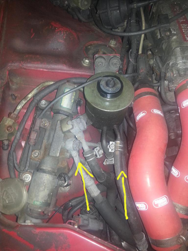

Just do it like this :
(i know its not a good photo but dont have anything better now :/ )

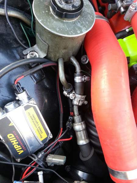

Dont know if this helps but I cut these pipes and joined them together.
Cut the rubber one so theres couple inches of rubber pipe coming from pot,
Then cut metal one with saw slide it in the rubber one and jubilee clip round it.
Mines like this never had a problem, then throw all the crap in the bin..

There how I have mine, when u throw it all away your be left with one pipe going nowhere so return it to the pot.
Maybe join hicas pipes together if u leave all the crap underneath.
I've removed everything.
If u look at draxan his done the same has me too.
Also if your car is uk spec or has a power steering cooler u either remove the cooler like I did and do it like above or u will have to loop the cooler in.
