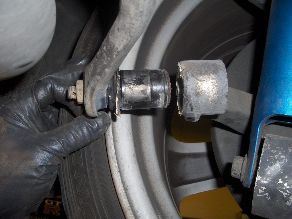

Its called the Hicas Rear Ball Joint Part Number 55154-30P00
And for future reference, heres a picture (pinched from the net)

Its deffo the bush Jeff, there is lateral movement in the wheel which is coming from this ball joint (not the inner one), it just the first thing I noticed when looking at it was the cover for the bush was split
AH HA!
Found the bugger!
How long has Batman been working on Zeds
black gloves are or winners :) those ball joints are about £80 bucks each for genuine ones, pretty sure theres a chap on the bay that does repros but I dunno what the qualities like. or you could fully delete it with the driftworks kit for £200
