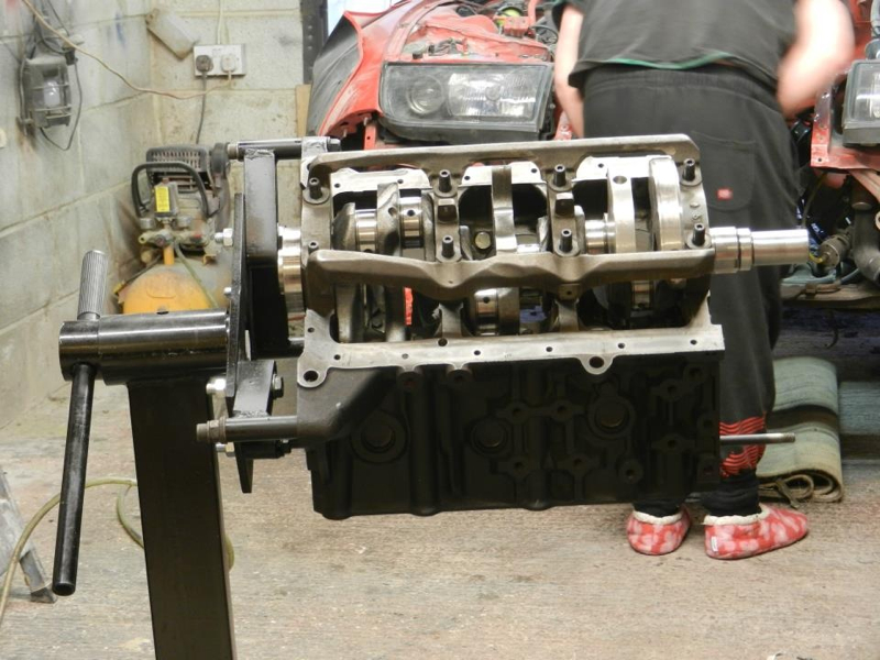

engine block and crack is bk from the machine shop :)
Time to start building the engine
The Build has Started

Are you using TT oil squirters or NA? I've read about the NA being better if using aftermarket pistons not sure if there is any validity to the claims.
That guy looks like he's getting a bit excited over your empty engine bay in pic 9
And he's wearing some very attractive pink slippers :)
Yep NA Oil Squirter's is a Must with After Market pistons
That is my Lad being nosey
