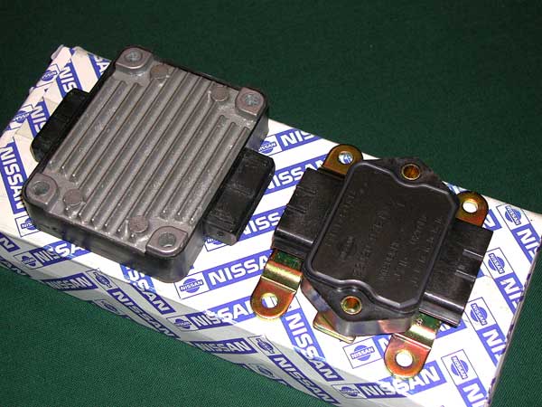

Yup! simply look at it, if it's Grey alloy colour with what looks like fins it is series 1, if it's Black and hard plastic, it's series 2.

Yes it does. If you flip the S2 PTU over you will see a metal plate. That and the mounting bracket forms the heatsink.
