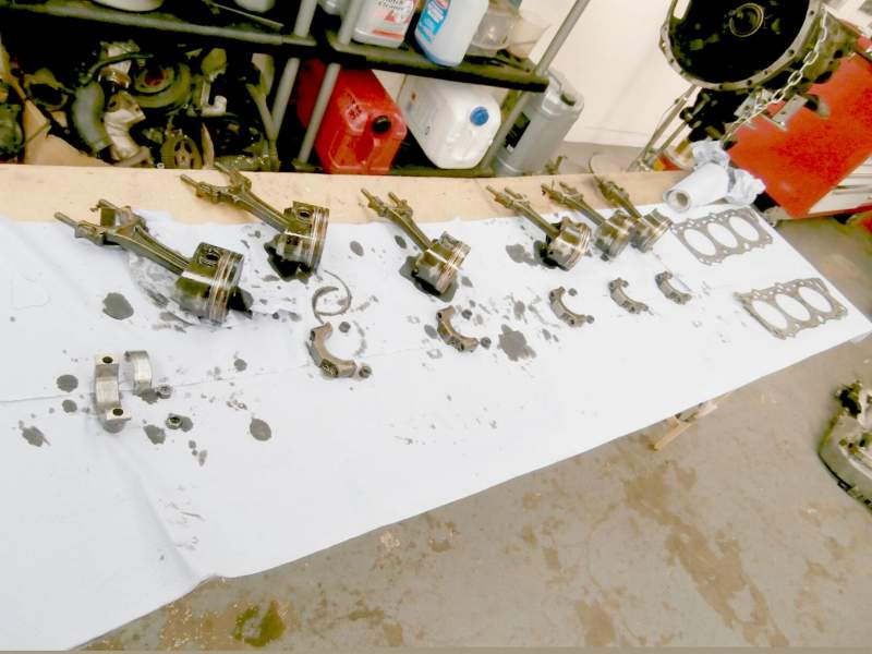

Before we even pulled the engine yesterday due to the oil / water mix in the radiator, the smoke from the exhaust and the general fit of engine we knew there was troubl e ahead, but add to the mix that this was once rebuilt by Ztech ( now a defunct outfit ) and was one of their famed "Forged variety" the reveal was well no surprise,

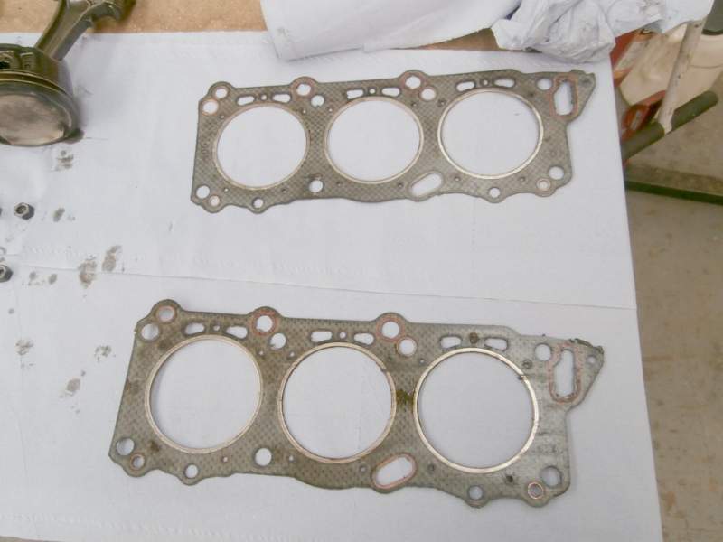

Standard pistons, rings rods, bearings, and nice standard head gaskets, trouble is the car had been set up on the understanding it was strong biggger injectors, bigger turbo`s and boosted etc. but the build was poor, the amount of excess silicon sealant was a joke, the mixed up bolts and missing brackets etc. was plain lazy, but to charge for one thing and delivery a hold lot less is unforgivable, this is one of many engines from the same bunch that were rebuilt with standard parts but charged out as Forged.
Why do this? if your getting work and been paid accordingly then why cheat? they were never in it for the long game, just a quick buck and off in to the sunset.....
So under pressure the standard parts had let go with broken piston rings and worse heavily marked bores, one bore has a sort of roll in the metal!
Be warned about any engines from this bunch.

Judging by the lines that far up the bore those rings were broken on assembly,they could never score that there other wise,ive seen cleaner pistons in high mileage diesels,thats a mess.Its awful to find piss poor workmanship like that.I did another re rebuild on another one of said specialists engines last year,that was scrap too,crank and block got binned.No forged rods,broken rings on second hand pistons.Thank god they are gone.At leat you no now and can get it done right.
