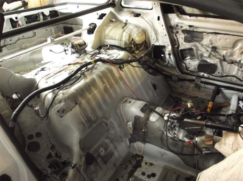

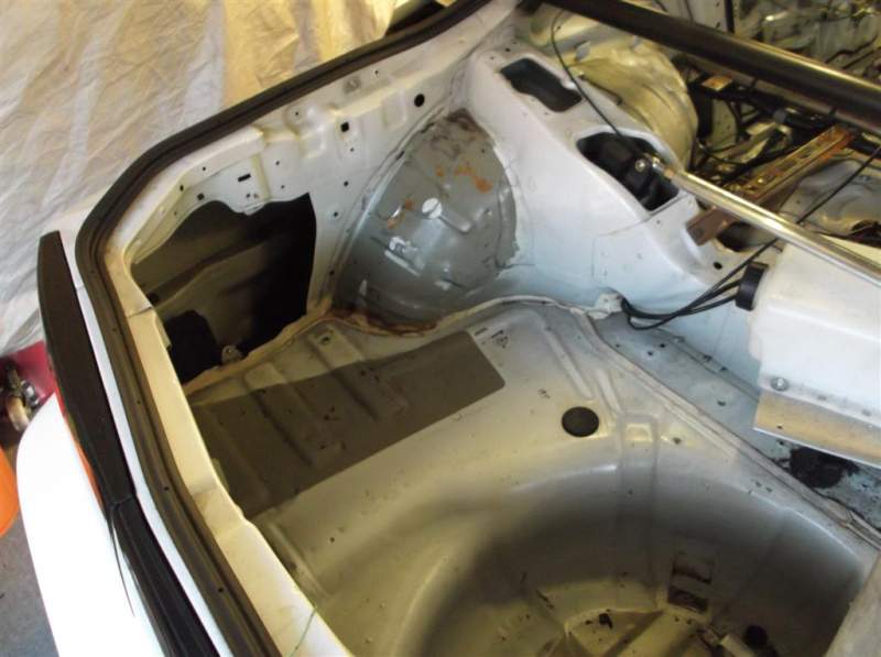

I decided to start the worst jobs first, so today I have spent several hours removing the black sound deadening, all excess metal brackets have been cut off too.
It doesnt get more boring really.

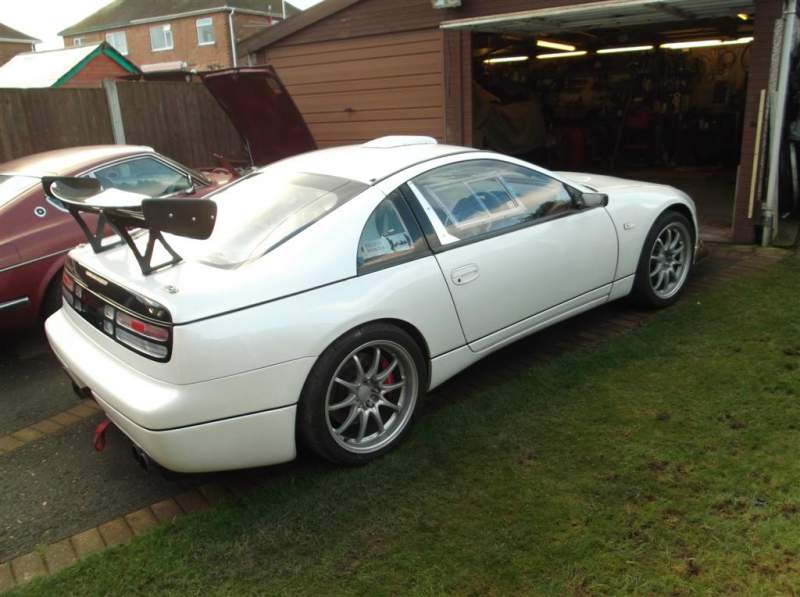

I have just been informed that there will be a Sard rear wing coming later to fit.
Its huge I think:1eye:

So another day of graft.
I'll let the pictures do the talking.......
I know its a mess but I do have a plan... Honestly:smartass:

Not much left to strip now Pete.
Still loads under the dash to come!
Yes I know!!!:detective:
