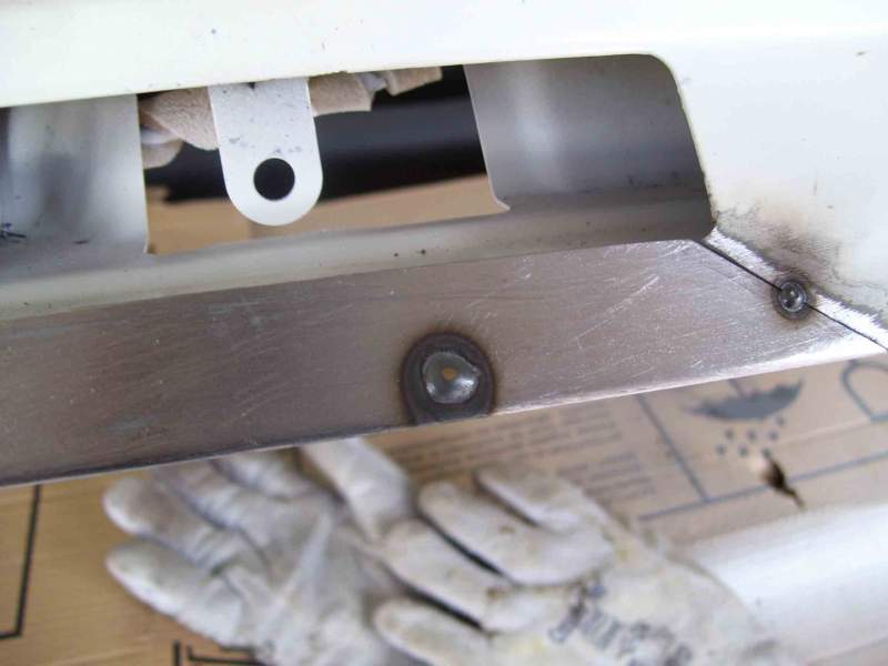

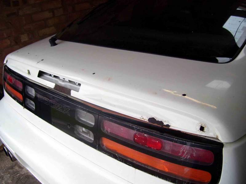

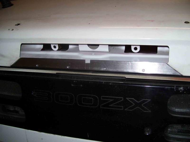

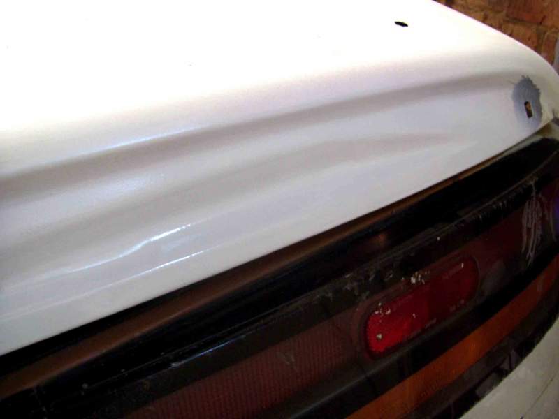

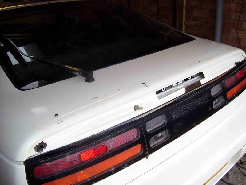

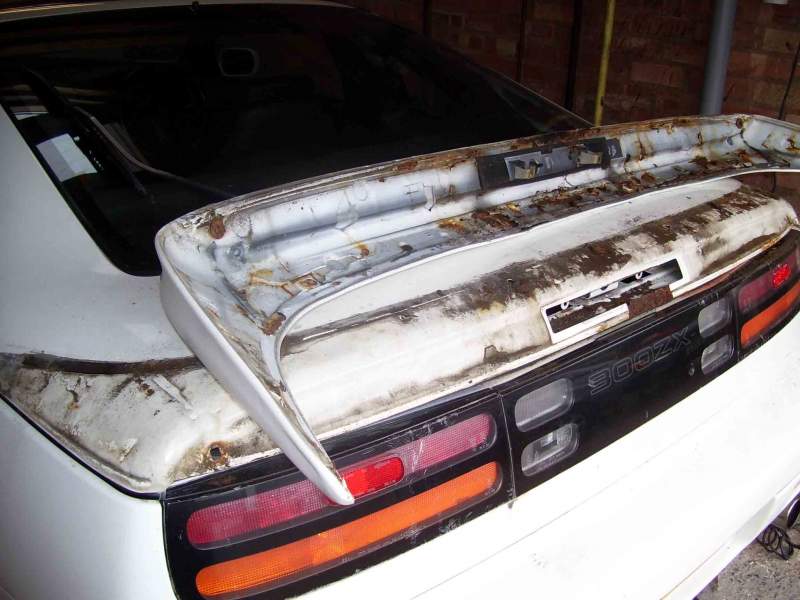

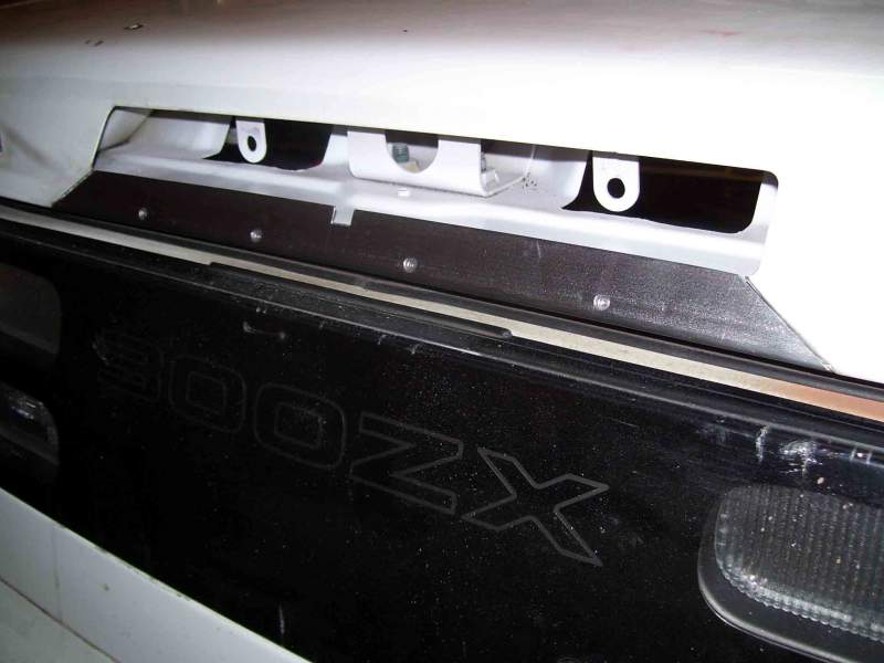

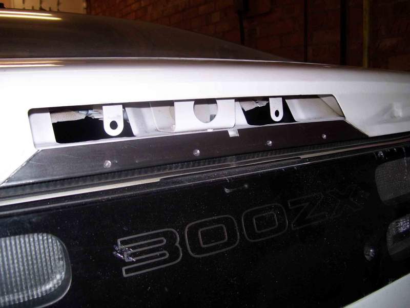

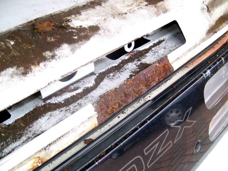

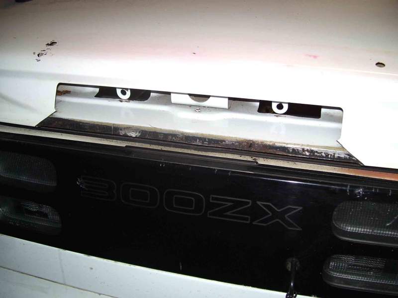

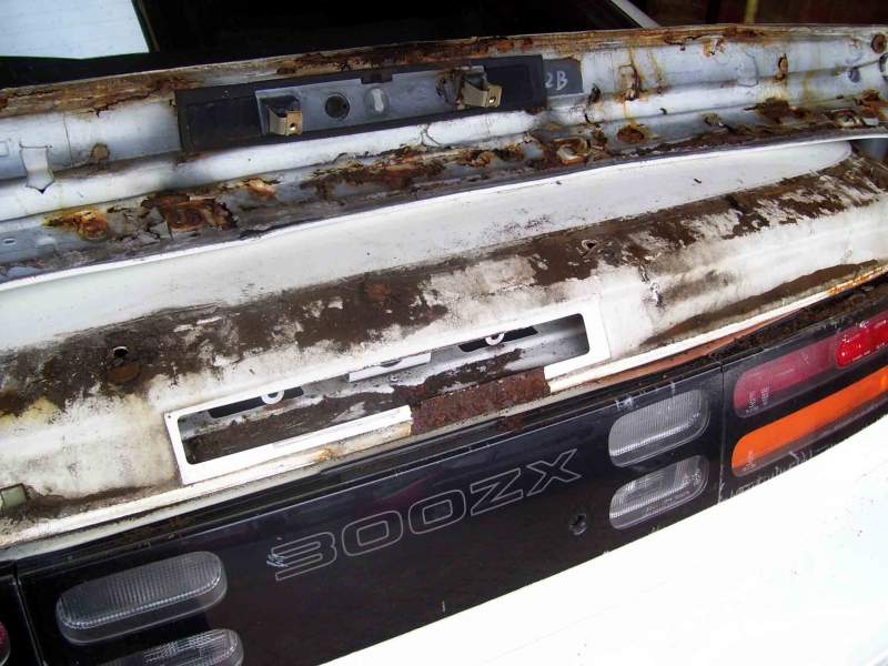

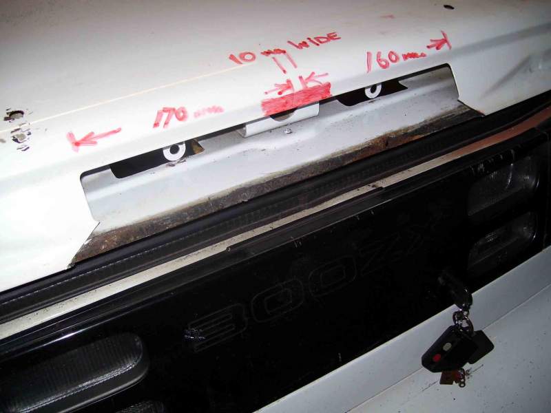

Finally decided to remove my rear spoiler today, not as bad a job as first thought.
Corrosion was not that bad either. Bit of repair work to do with the old mig welder but all in all, not that bad.

A must do job on a zed!! looks like you caught it well in time, not bad under there at all :)

Well, thinking of cutting out the tin worm and making good. Toyed with making up my own spoiler, something like the original sierra cosworth whale fin type. Along the lines of the escort cosworth.
But in reality, I will probably go for a standard replacement.

Hi Ossian, I must admit, I had heard that it was a bit of a daunting job, so I kept putting it off.
In reality, it was quite straight forward. Once I had understood where all the fixing were, it took me less than half an hour to get the thing off. If there is anything I can pass on from my experience, I would be happy to share.

I took mine off recently and had the same rust areas as yourself, quite easy really barring all that silicone.

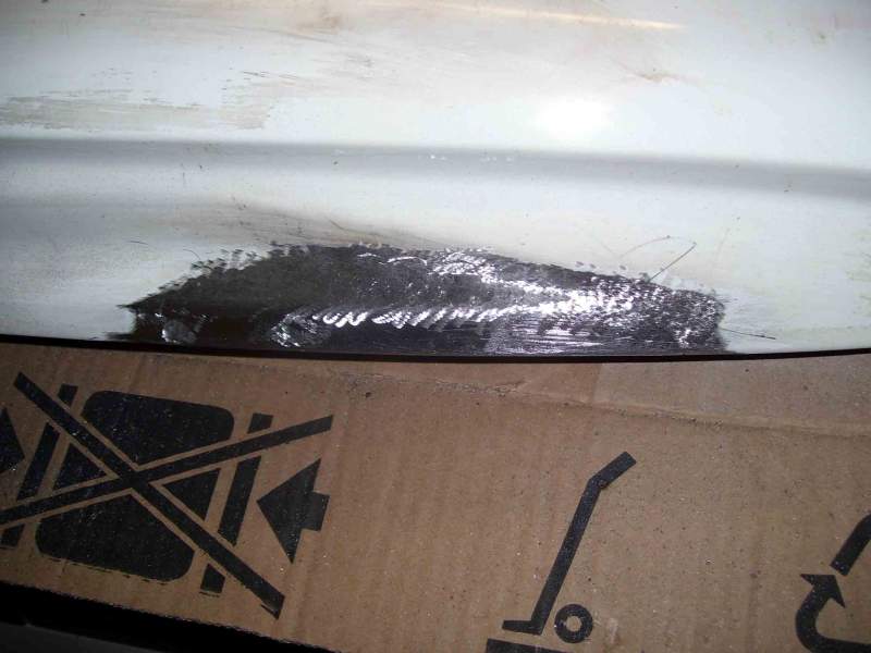

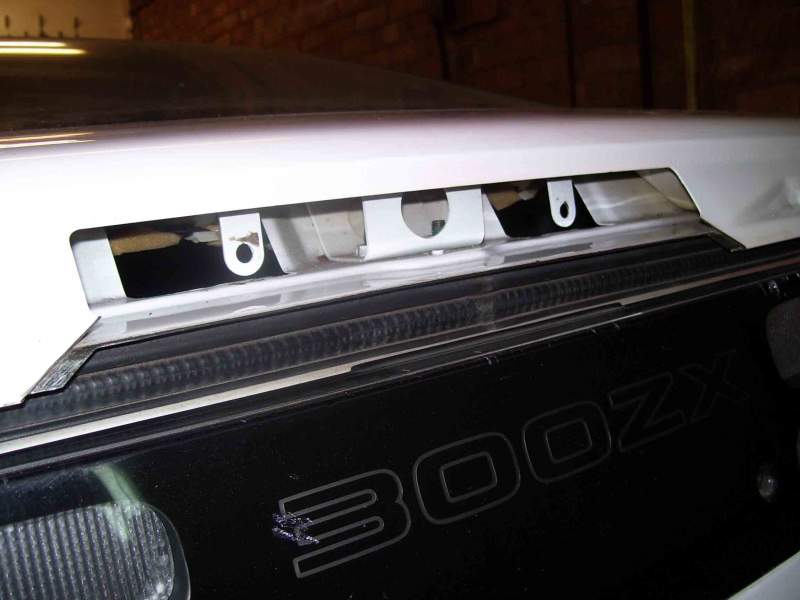

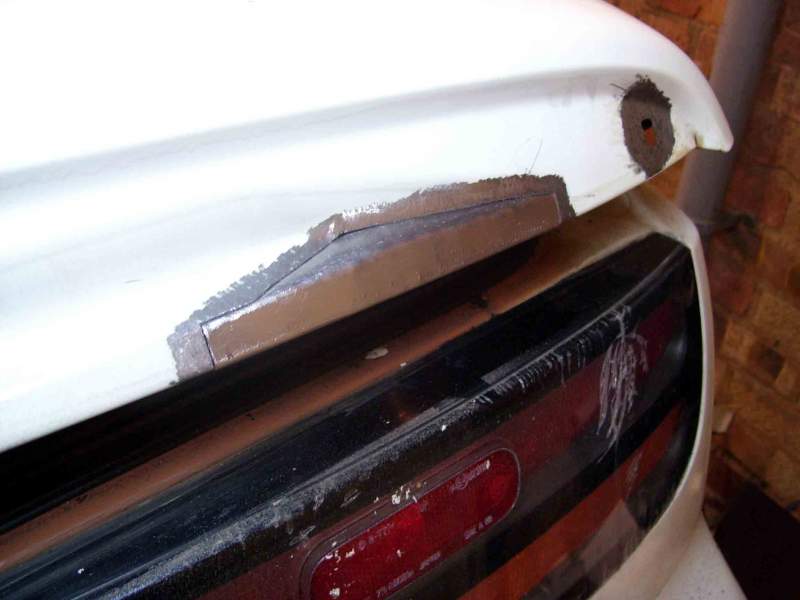

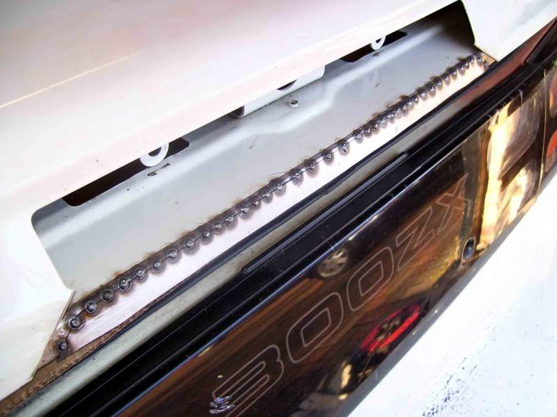

Decided to bite the bullet and made a start on cutting the tin worm out tonight.
Mind you, cutting the metal out is the easy bit. Now I have to put some good stuff back in!!!

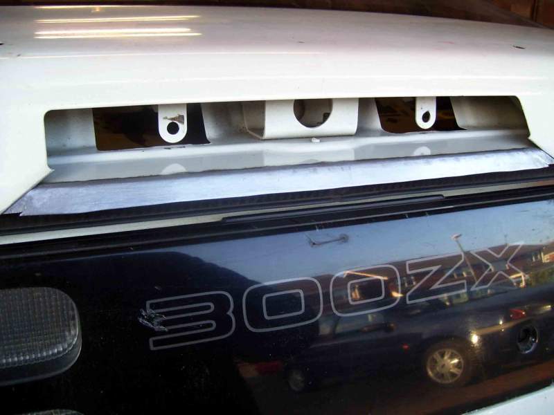

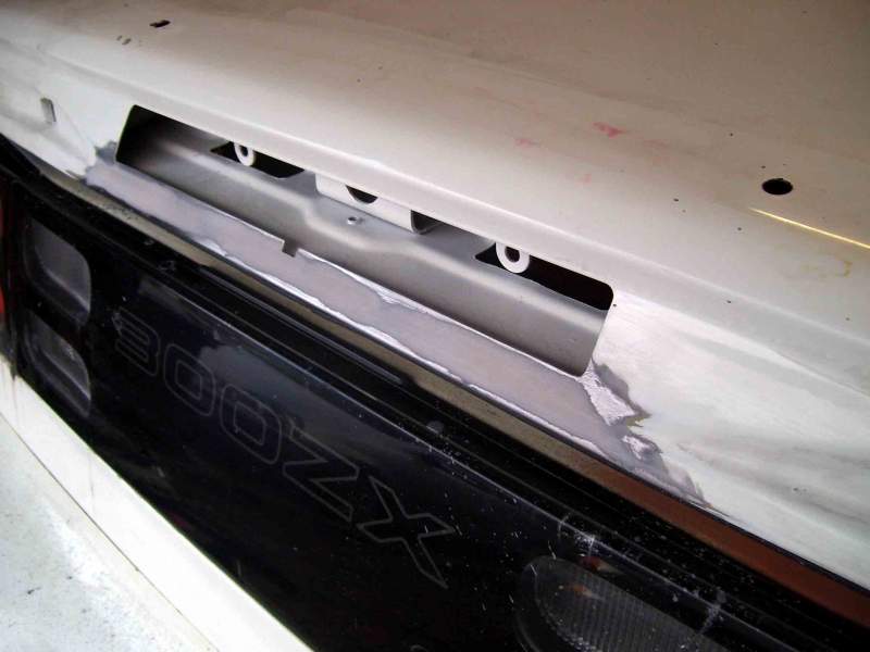

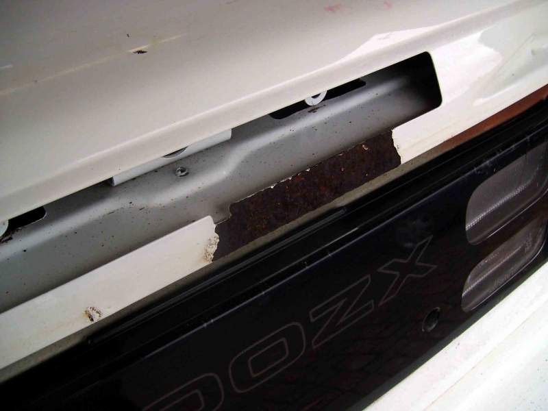

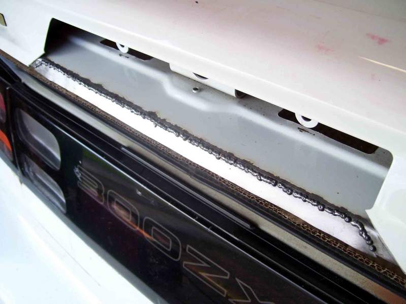

As a bit of an up-date. (thought people might like see my progress)
I managed to weld in a repair piece today. Just got to trim the bottom edge before I prime.
After that I can then add the outer skin.
There are a couple of areas still to attend to before I can say that the thing is rust free mind.

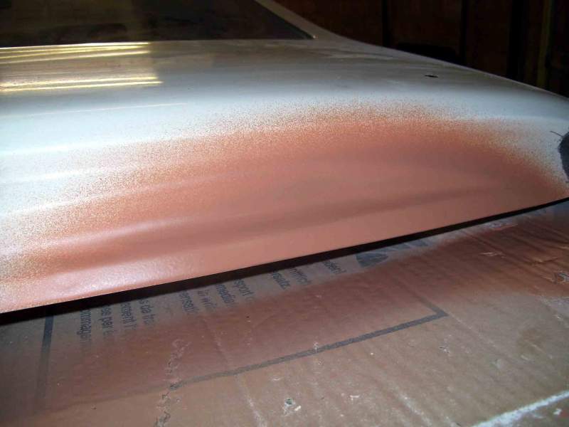

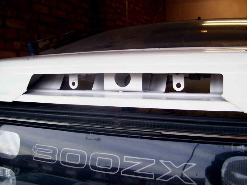

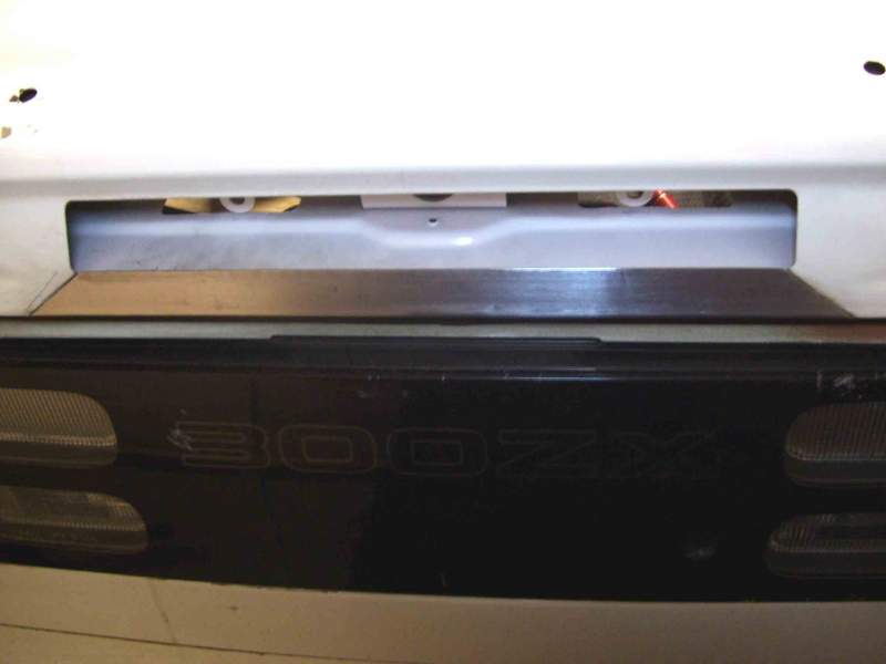

Not much in the way of progress today.
Only managed to trim the edge and get some paint on.
Still, every bit counts I suppose.

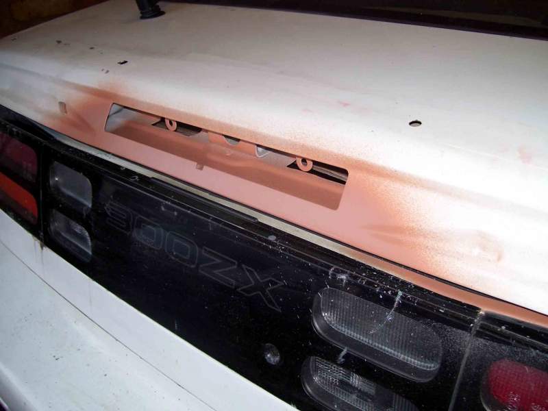

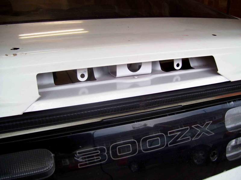

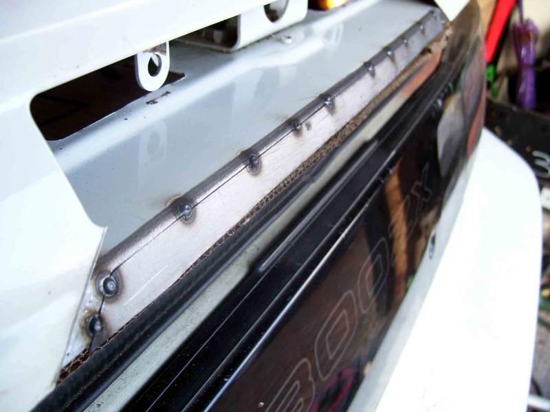

A little more done, managed to get the outer section made up.
Just need to get it welded in to place.

very nice job ,wouldn't even know it had been done
Cheers mate!
