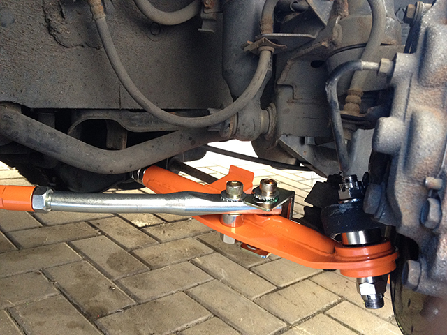

more orange goodies
Went to install these today and now the bloody bolt with the cotter pin just spins in place !
It seems everything i do to this zed over the last two months is just a pain in the ass.
Does it not know i'm giving it quality upgrades or does the lady think i'm cutting her limbs off

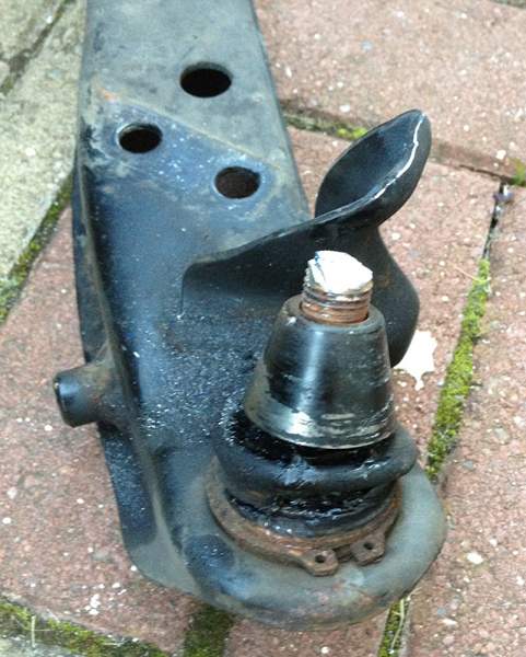

Well this is the bolt i mentioned and it just spins in place !
Any ideas ?
Theres no pin in it any longer and the whole bolt spins with the nut.
I dont really want to take the front discs and hub off just for this, only thing i can think of is to hack saw
the bottom part where the rubber boot is.

Well the issue i've got isn't with the aftermarket parts; its the old worn bits just wont budge !

I use mole grips on that just above the rubber.. set them so tight so you can just about squeese them.. let the grips lock against the back of the disc then plenty of heat and job done
Well took some advise from above and got hold of a nut splitter : no luck :huh:
Bloody nut has a tapered bottom part and of course the tool doesnt fit over it and stay on so
i was back to square one again, then tried the vice grips idea and even wth them stuck on it still wasn't strong enough hold.
Finally after no option left i spent a good hour per side with a hack saw and then a grinder and finally got both sides off.
Out with the old :

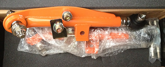

And after the struggle paid off in with the new :
