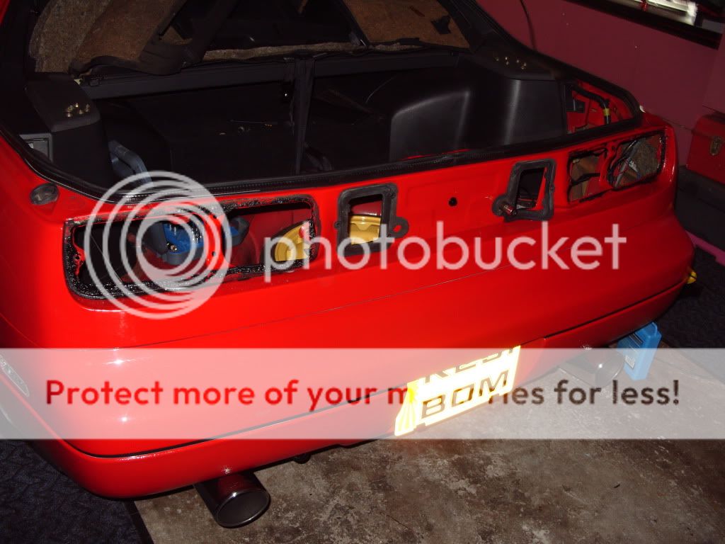

Im convinced it is! Becuase its in the same place as my LWB was! Im away from home until friday so I cant actually physically check. But busting out the photobucket account you can see the filler cap on the drivers side.
To compare here is my LWB

Is yours SWB? If so:
-Open boot.
-Remove the big plastic screw from the inside centre panel on the passenger side.
-Remove the cover of the passenger side rear light and remove the screw holding the panel.
-Pull the carpet back.
-Follow the bottom edge around and there are 2-3 10mm nuts to remove.
-Get your fingers in under the boot seal above the washer bottle and grab the panel in the hole where the rear light access is, gentle pull it away toward the centre of the boot. There is a clip holding the panel next to the water bottle on the inside, you are trying to disconnect this.
-With that removed you can see all the bolts holding the water bottle in place. Remove them, disconnect the water pipe and push the rubber filler tube down through.
-I would use something like bleach in hot water and shake the bottle to loosen all the algae. If you have a flexible wire brush you can shove inside that would be good.
-Rinse thoroughly.
-I would then replace the bottle, fill it, disconnect the washers at the splitter under the bonnet and flush a load of water through to clear anything lurking in the pipe so it doesn't get into the washer jets again.
-Put it all back together
Should take an hour tops, if you need pictures ask but it's all pretty obvious once you get started:biggrin:
