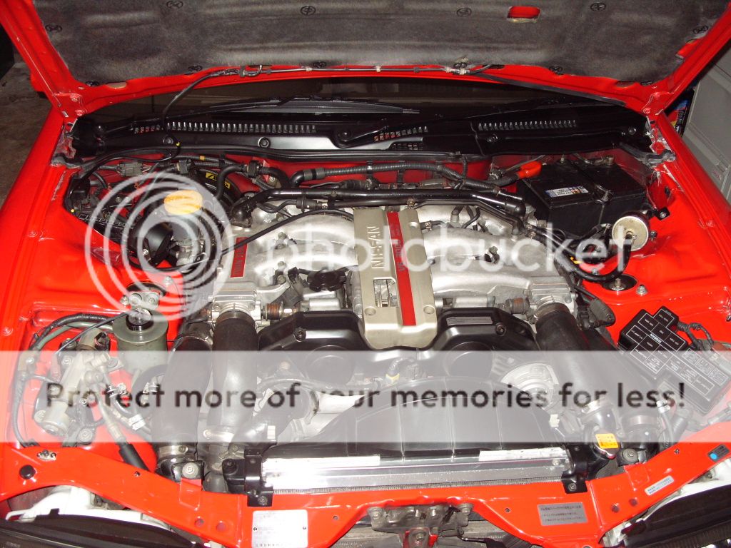

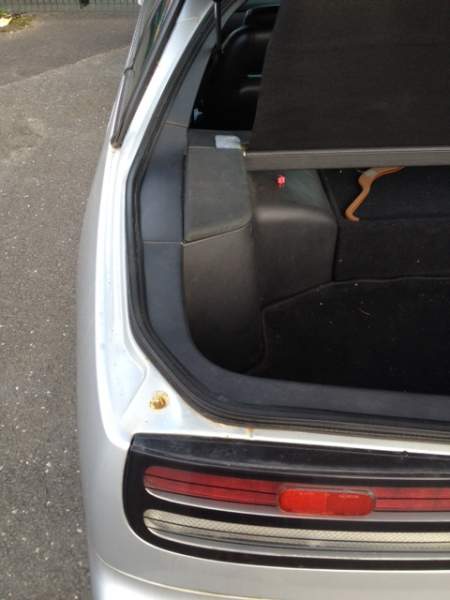

Better pics of swb water water bottle location in rear boot and not in engine bay.
I dont doubt it hehe, just different to mine. What year is that car Gary?
Lol everyone says that, nope its a shorty
Ah! Sorry dude must be the angle of the photo. What year is your car?

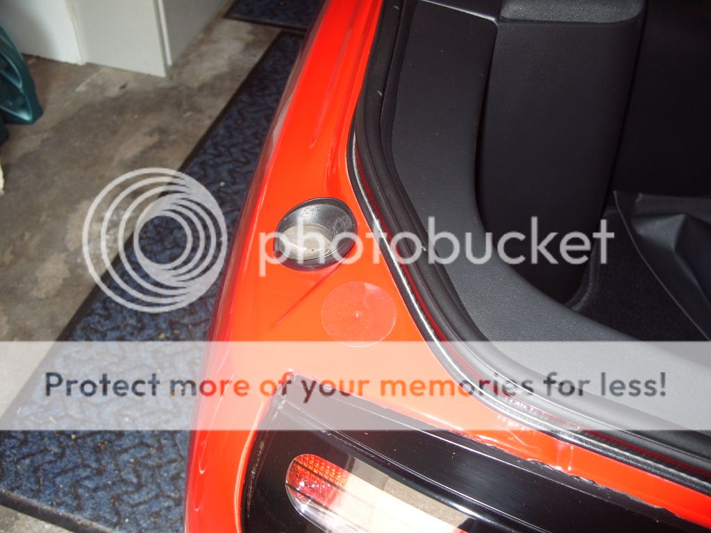

This is the back end of mine... The dirty/grubby mark is where the boot rubber touches. I notice yours has a clear plastic pad there.
