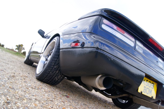

standard tyre and wheel combination tbh i have it no probs at all
Edited by hellraiser
i've got pretty much the same on my car 235/45/18 9j on the front and 265/40/18 10j on the back and my z is lowered and i have had no problem at all except excessive wear on the inside of the rear tyres. But that is nothing that a set of camber adjusters can't fix.
