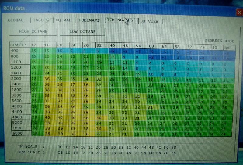

Dealing with zeds all day every day we get to see a large amount of ecu maps, mostly they are conservative but on the odd ooccassion an unusual one turns up, the one below is a case in point
anyone fancy guessing the spec and type of zed?

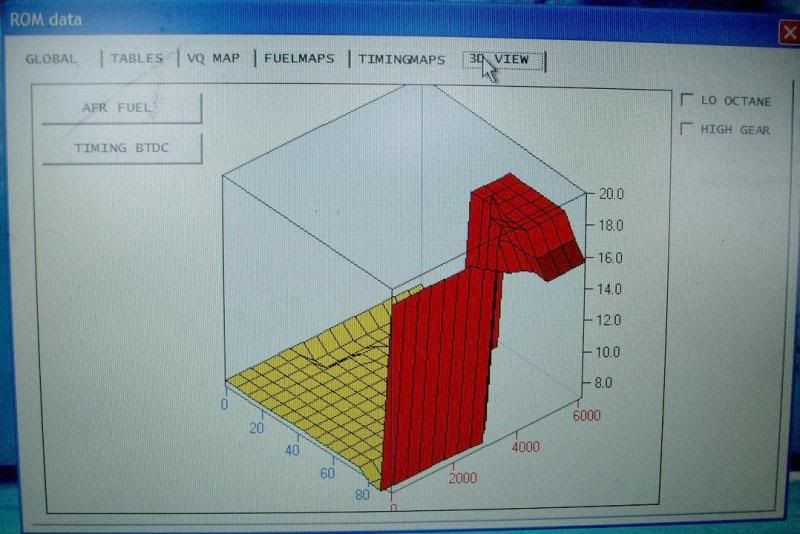

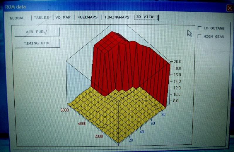

big jump in the advanced timing around 3k rpm from 15>20+ then back down to 16 around 4k+

Did Nissan build in a kind of nanotechnology that comes to life after approx 22yrs and effectively grows another cylinder. Therefore keeping the Z competitive with the latest 944 or Boxster?
Love the idea of that!! well its odd because it was a totally standard non turbo with no other mods ? it ran ok, in fact not particular differently...... sorry no Nano technology here!

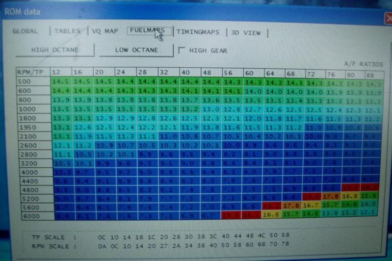

Can you put a turbo ecu in an n/a car? Coz that's silly rich for an n/a 7.5 is rich even for a turbo car!!! Then leans up like crazy at the top end, looks like someone's had a crack at mapping it at home lol
