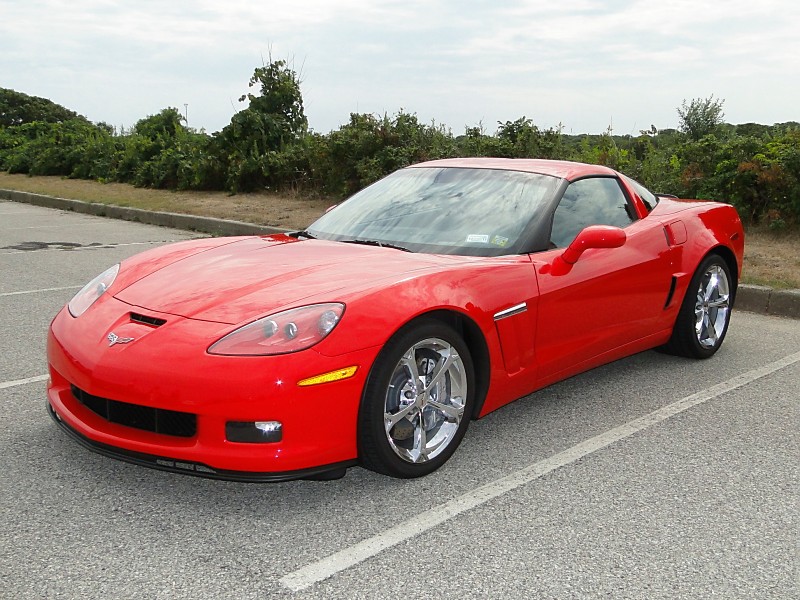

Corvette Grand Sport has 19s on back and 18s up front but it was designed to sit on these. Only cons I can think of are calibrations between front and back abs etc. I guess Unless you do the mod and test the specific car in a variety of conditions who knows ?
