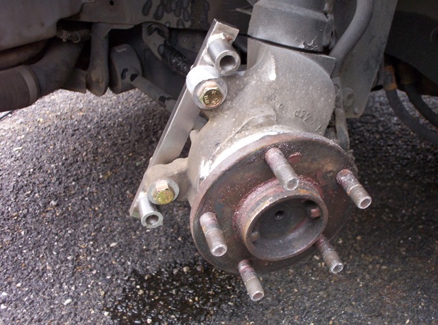

I have some, Ill dig the brackets out tomorrow and post some pics.

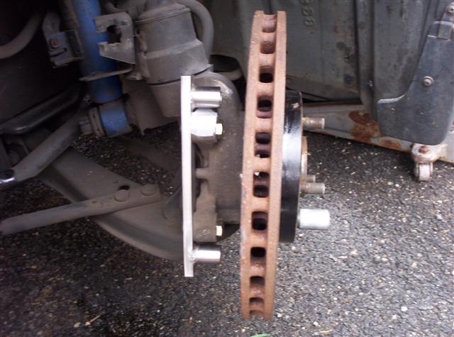

Get yourself some evo brake lines as well as the 300 ones don't reach. Also youll need an angle grinder to shave off part of the hub, no big deal.
dazvert has done this aswel
Only done the fronts though, not the rears as Rob was asking :)

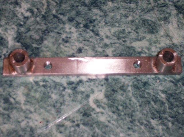

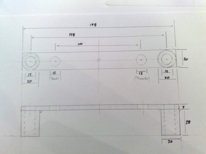

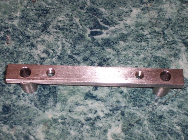

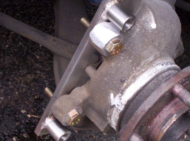

Big apologies matey, they are in the garage burried I did have a tidy up yesterday but ran out of time (literely), tomorrow definetly bud.
Right Ive found the drawings I went off you'll need a straight piece of ss 20mm x 10mm mark the centre, measure from the centre 100mm each way. Weld 2 spacers 28mm long on to the bar and drill 2 holes for the caliper bolts. Can't be certain of the distance from the centre for the position of the z hub (100mm?) but this hole is tapped to take a bolt.
Cheers for the pics mate, but correct me if I'm wrong thats a front hub. I'm after details on rears.
For the fronts I've got a set of Maserati 4200 Brembos to go on.
Sorry matey, my mistake I must have been scanning, yep I did the fronts only.
