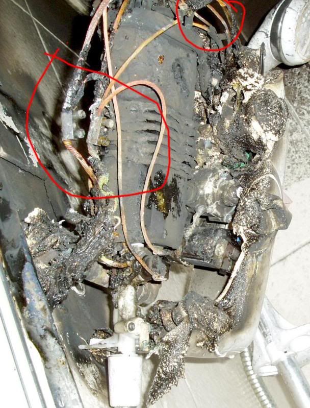

Looking closer at the shower the cables have clearly overheated that caused the insulation to melt and then flash across sparking the fire, oh I did forget to mention Danni was actually in the shower when this started!! lucky girl me thinks.

fookin hell jeff. Looks like the installer is at fault there :(
Very very lucky!!!!
I actually wonder if there was ever anything between those 2 metal blocks that the cables bolt into, wouldn't suprise me if the landlord fitted it himself.

I gotta ask, do you know what make and model the shower was ?

Shower was a Tritan not sure of exact model, I did take a quick look at the breaker board and could not see any electrical test labels?

those wires look the right gage for shower the insulator could of be cracked or even chafing

I bet this was a new type shower which is rated at 9.5kw, and the cable was only a 6mm2, rated for 8.5kw. I can this is becoming a common problem, people fiting new showers, and not thinkng about the updating of the supply to a 45amp RCD and cable replacement to 10mm2 Jeff it would be worth checking the cable if you get chance at the dist board end.

being an electrician id go with this as being the cause also. i make it standard practice to just install 10mm cable on all my showers now also even if it was the right cable ect something as simple as a loose (even if it doesnt look loose) live or neutral in the conector block can be enough to cause that due to the ampage it pulls, doesnt have to be a loose conection on mains can be a loose factory conection
also if it was rented house the landlord should have periodic testing certificates which would highlight any defects in wiring even if he hasnt acted upon it
