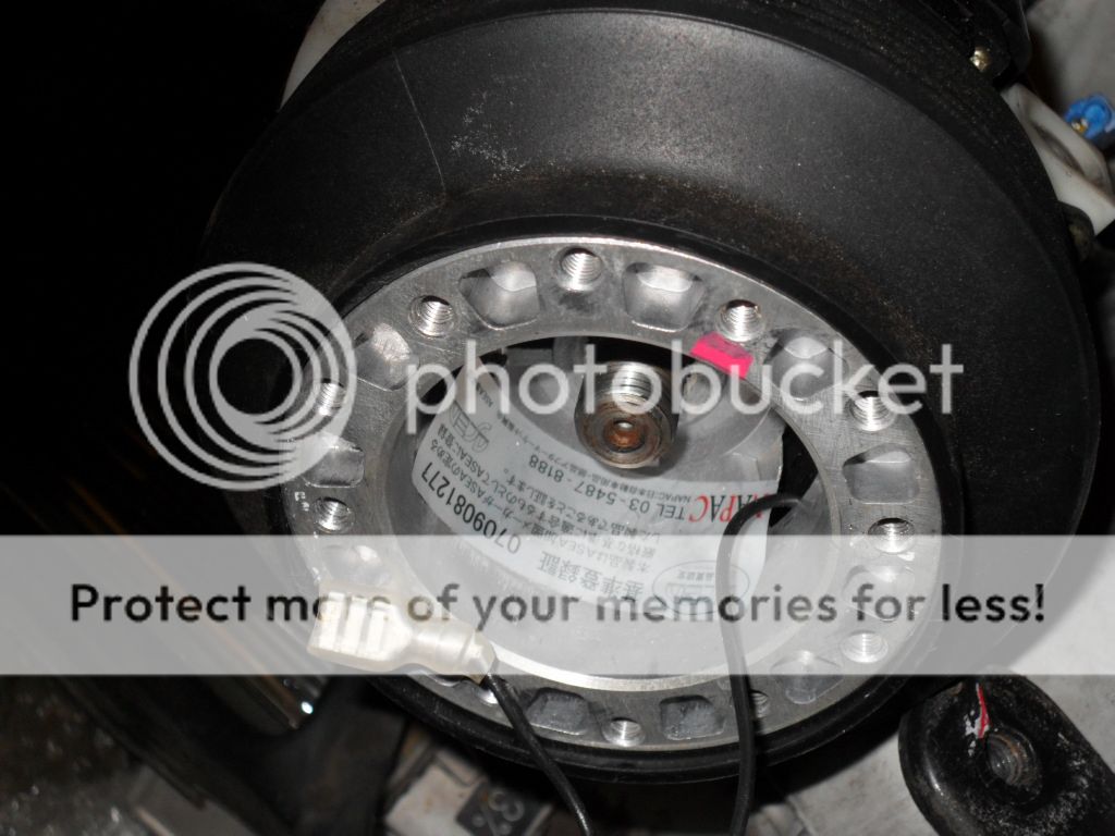

Finally my new momo steering wheel has arrived and I have a Nissan boss which I hoped would fit my steering coloum But it wont fit the first pic is my Nissan boss the second pic is the steering coloum I dont have cruz but still want to use my hicas setup. I did a search and I think this is what I need..........

Gaz,ref the boss the one in your first post(45.00) is the one you need.As for the Hicas light,pull the plug out of the ECU,this way the light still comes on when the Fluid gets low.:chinese:
That's the one mate, TT non cruise control (non airbag)
here's a pic:

To be honest Gary I don't think the zcentre one is worth it at over £70,
I can see from the pic that you already have the small cable for the horn so it wouldnt take
much to fabricate a metal plate that turns the hicas plate and signal cancelation.
