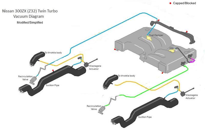

was down at the car earlier and found i had a collapsed vacuum pipe for the drivers side dump valve going to the balance bar :blink: so used a bit of fuel hose for now till i can get a replacement, basically ive got the simple vacuum set up pictured below ive checked all pipes and all but that dump valve was collapsed. looks like ill be wiring up the S2 ptu to see if thats the problem.

EDIT, when i pull one of the vacuum hoses off it verges on cutting out so still could be a vac leak i suppose. but it does seem more a misfire than a vacuum problem

Have you checked all you're capped/blocked bits on that diagram for leaks? Just a rubber nipple may not be enough, I tend to cable tie them on too as they can blow off under boost.
