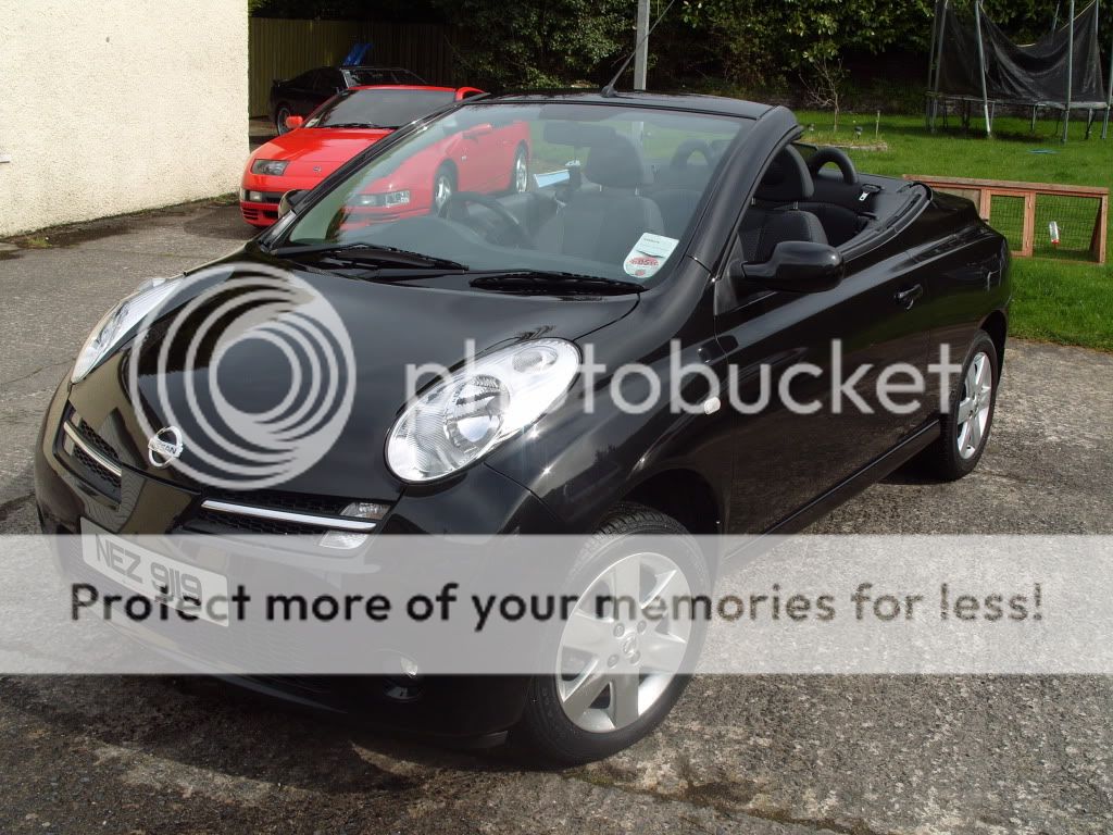

Took my wife's micra to get its first MOT this morning and it passed but he said the numbers on the registration plate were to close together and advised new plates I informed him that these where the plates fitted by the main Nissan dealer when new but he still said they where illegal! So there you have it Nissan dealers are fitting illegal number plates to cars.:huh:
Not his job, if it was in for a test.
If they done the work, they would have to bill. You want to pay workshop rates for tightening that bolt and replacing those bulbs?
Well when I do an MOT I never fail car for bulbs(or anything can be sorted within an hour) just replace them that's the way to keep customers coming back next time :)
Space between characters has to be 11mm. They sold you a car with dud plates.
