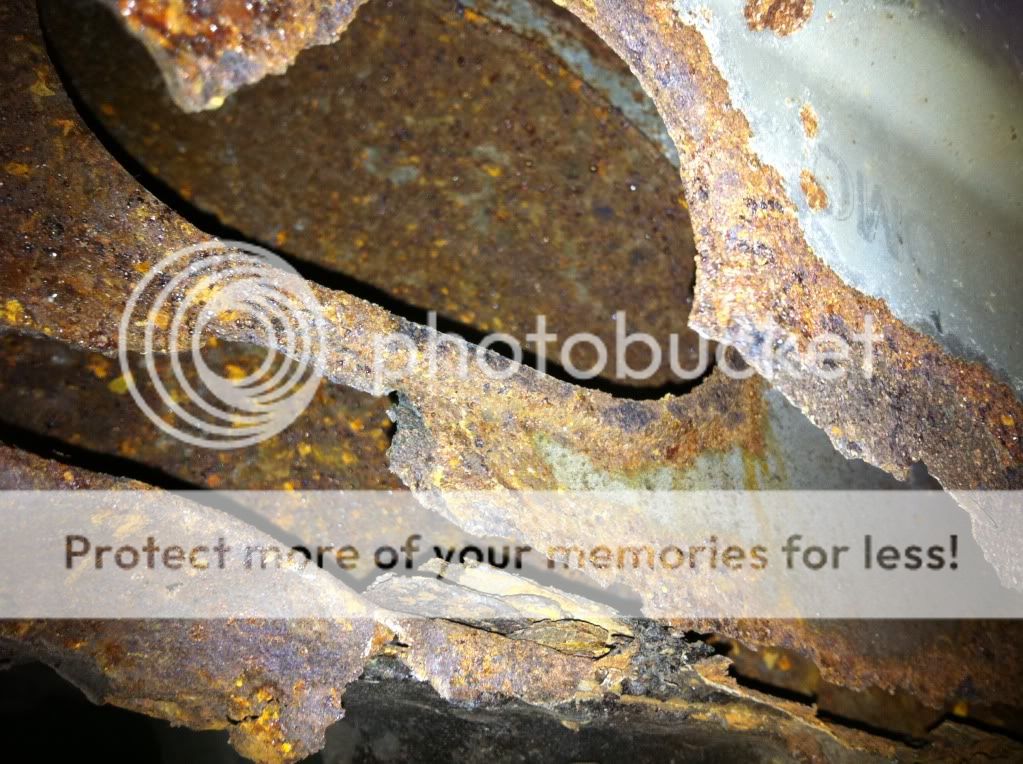

End of the road? or salvageable?

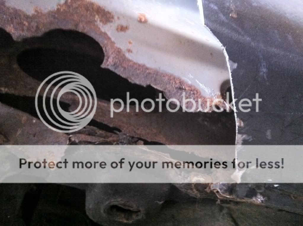

is it the end ? the inner sill is completely detached for as far as I can see !!
I have a mate who can weld it for me and body work I can do myself, just not sure if I'll be chasing my tail!

MJP sells the panels, can be repaired so depends how much the car means to you to be honest mate.
Any idea of costs of inner and outer sills?
You would have to speak to MJP about that bud. as not sure on costs my self.
Anything can be repaired if you have deep pockets and are willing to pay......
.....but that does look pretty bad. If it was my car I'd get a couple of prices for a full repair and repaint; and then compare that to the cost of replacing the car altogether.
