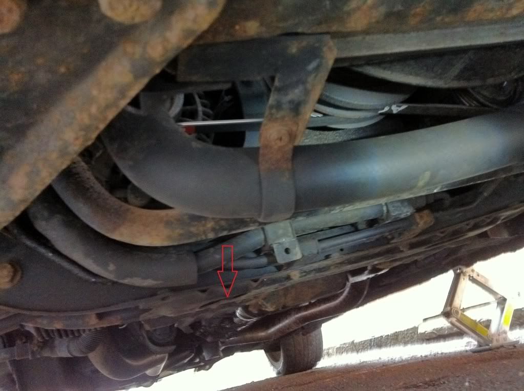

it was leaking oil from the middle of the car, gonna go up and investigate it this morning, will take some pics and hopefully get some idea of wot it is
Good luck fella hope she isnt terminal, easy enough to swap engines though if the rest of the car is good
Mate I was going the other way and saw you on the bridge pulled over! Keep us posted.
ok been up and taken a pic, i know it needs to go on a ramp for a proper look but any ideas, oil was coming form where the arrows pointing......
no its a manual gearbox, gonna get it towed to a local garage tomorrow n see the damage

im clutching at straws but could it just be a seal gone on the gearbox?
Fingers crossed you get it sorted Kev. Where in S.Wales are you?
slight update... just been back up to it and checked engine oil which alough looks a bit dirtier than when i saw it yesterday, theres plenty of it on the dipstick, so it must have been gearbox oil all over the road. im guessing this is a good (cheaper) thing
assuming it is the gearbox, how much we looking at to replace it? as for doing it in a couple of hours, im just about capable of checking the oil and water before a long trip
oh yes matey. box can be out in a couple of hours and you can do it yourself quite easy:). just got to find 1. if it is that:). i might even know of 1 coming up for sale very soon if it is that:)
