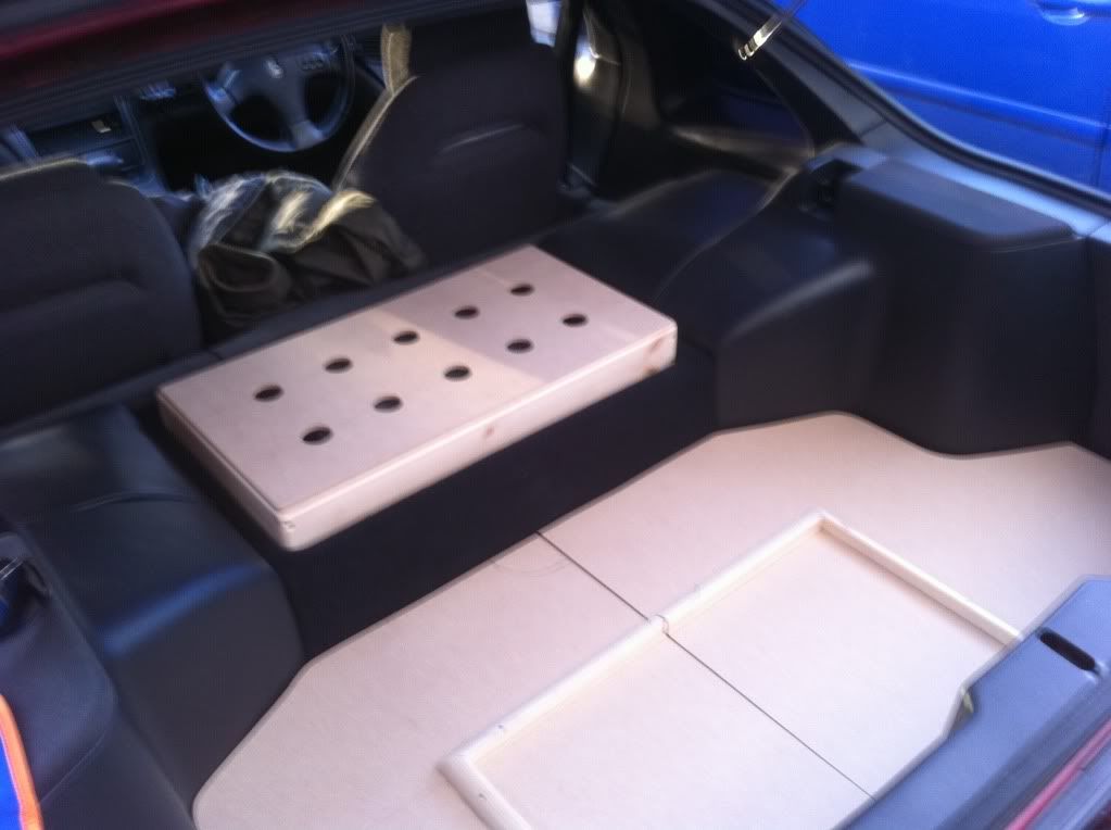

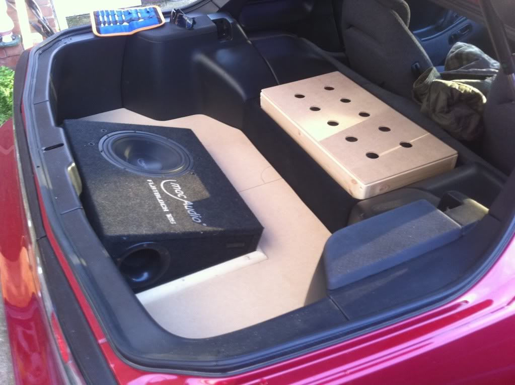

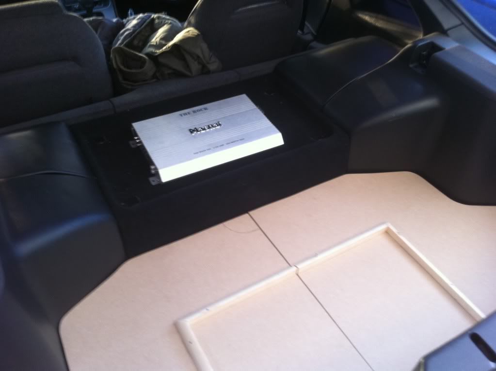

Just thought i'd post a couple of pics of the interim install on my Slicktop. I will update the amp and sub at a later date as and when funds permit. The amp is running the sub and also the Hertz co axials up-front. I also have JL components in the rear Bose boxes. The amp cover and false floor are still to be carpeted, and i'll probably cover the sub as well, most likely in acoustic cloth.
When i do upgrade i shall build a box (maybe 2) out of 18mm MDF that'll be scribed to fit in the corners taking a 10" sub. This will do for now though and if the spare is needed its a case of unscrewing the two wires from the sub then just lifting that out along with the two sections of false floor. Simples!

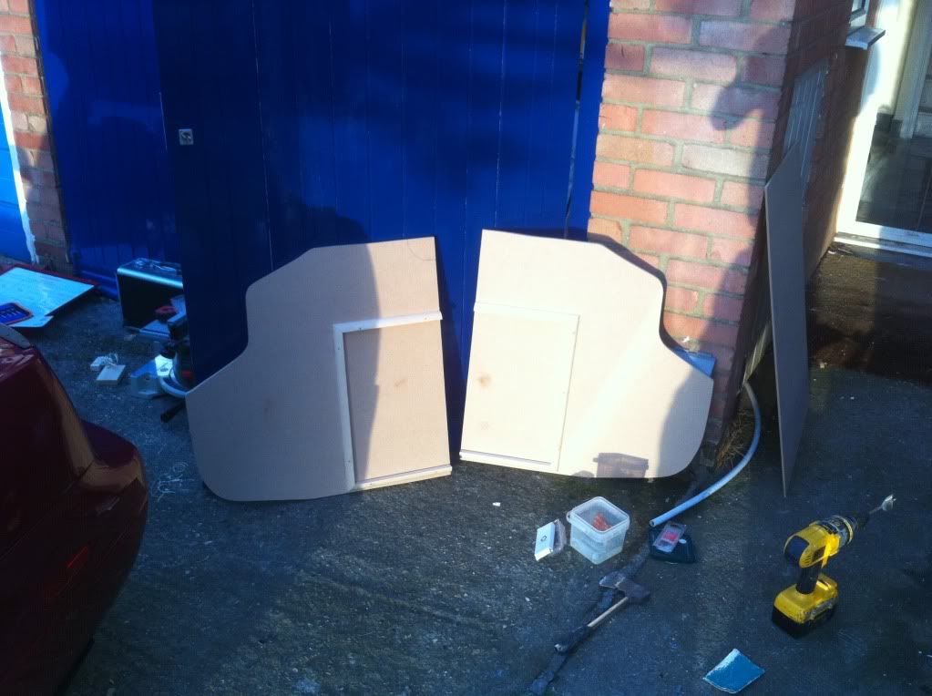

The false floor has to be cut into two sections as the SWB boots are wider at the bottom than the top! I shall probably add a layer of memory foam underneath too.

Hey Daffy, looking good there.
You should consider a job as a carpenter mate!
Looking forward to seeing the finished job.
All these words are gobbledegook to me I'm afraid... can't stand ICE but I do appreciate the work that goes into the installs, and yours looks like a top job :thumbup1:
im the same as bigh..i prefer the engine soundtrack... that looks like quality craftmanship

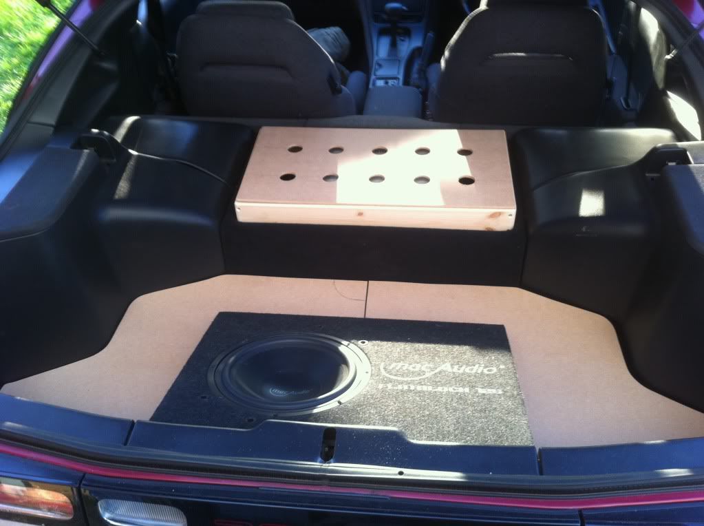

Finally got round to carpeting the falsefloor and amp cover. Here it is finished. Hope you like, sounds awesome. The Hertz components up front are sounding better and better, true what they say about improving with use.
Sorry about shaky phone pics!!

How do you go about making a template so you can get such a good fit ?
Use your boot carpet as a template fella. Whilst it's in situ make a note of where it fits snug/loose to the trim and allow for this when you lay it on your MDF sheet. Then you can offer it into the boot and it should be somewhere near perfect. It's really quite a simple process, but because of the shape looks a whole lot more complicated than it is. Don't forget to leave a gap of about 5mm all round for when you cover with carpet. I took the carpet down and around the edge to help with damping where MDF meets plastic trim. HTH. The 'amp' cover is just basic carpentry, form the rectangle, but allow to round the corners so it follows the 'tray' shape that shorties have.

Use your boot carpet as a template fella. Whilst it's in situ make a note of where it fits snug/loose to the trim and allow for this when you lay it on your MDF sheet. Then you can offer it into the boot and it shoul be somewhere near perfect. It's really quite a simple process, but because of the shape looks a whole lot more complicated than it is. Don't forget to leave a gap of about 5mm all round for when you cover with carpet. HTH. The 'amp' cover is just basic carpentry, form the rectangle, but allow to round the corners so it follows the 'tray' shape that shorties have.
That is so simple - but fecking genius - i was wondering how i would do it myself and never even thought of the carpet!
I know mate, it's simples really. Sometimes it's just too obvious a solution!! If you're handy with a jigsaw you will be able to do it. Now all I need is Craig to see how simple it is and that's 2 jobs I've done myself out of!!! I should be able to pop over Sunday chap.
