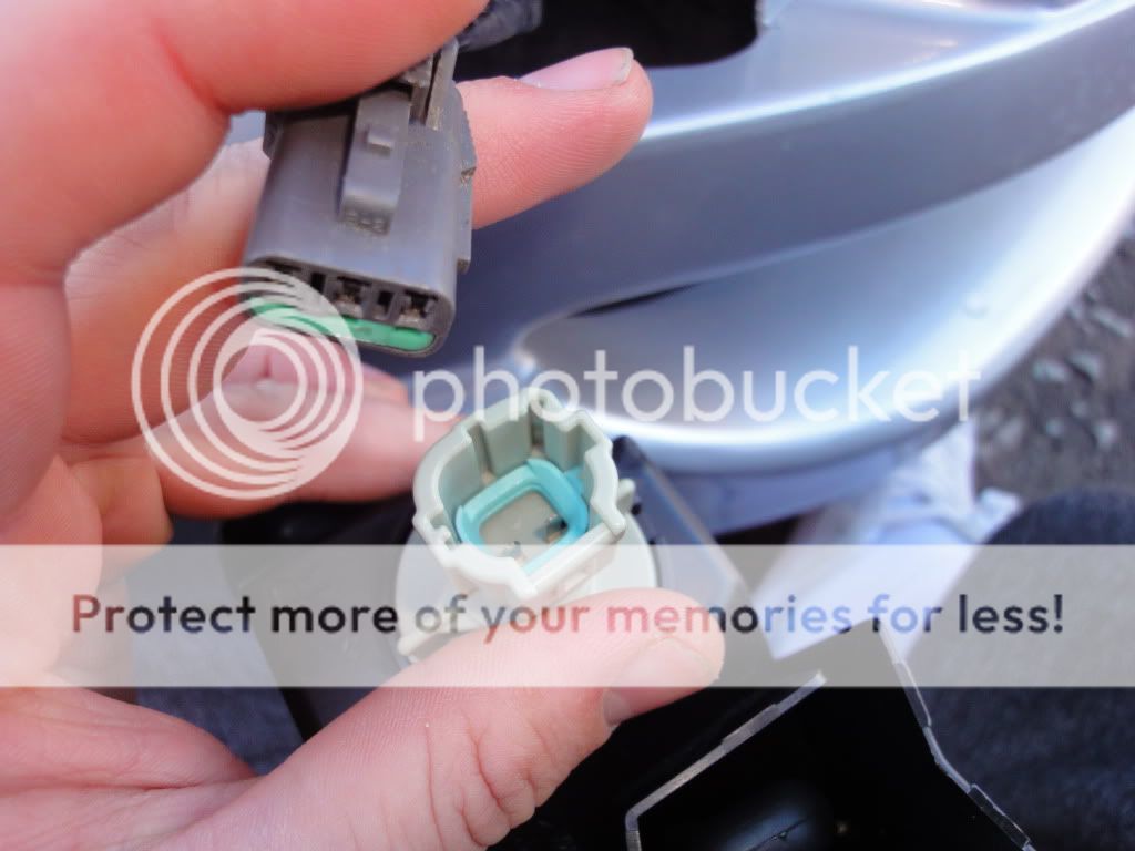

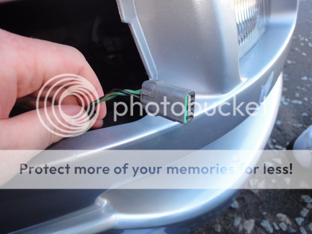

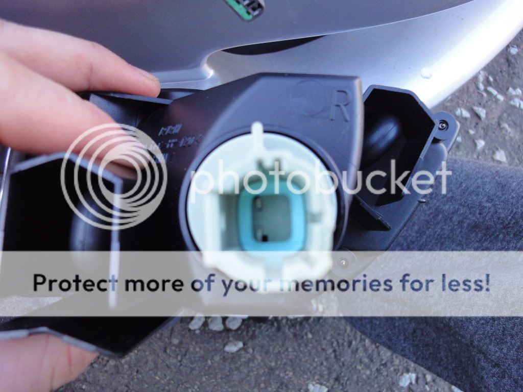

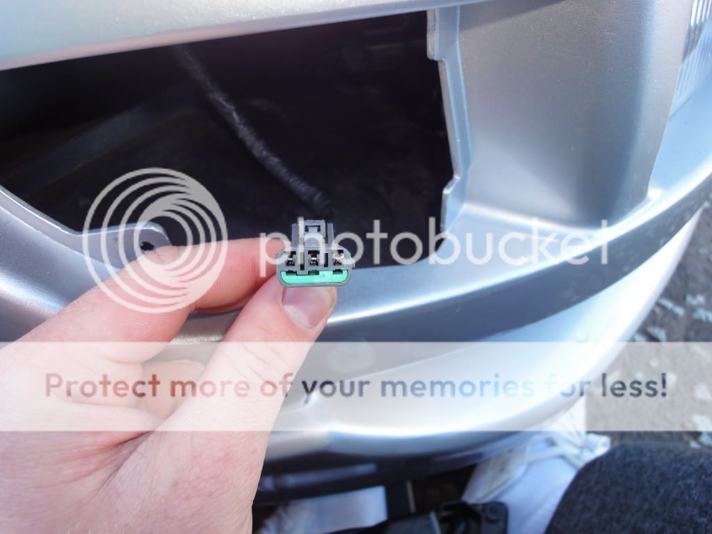

thats photos i took there to show my problem. pritty annoying so it is as you cant cut any wires and solder anything etc due to the connector on the lights.
any ideas anybody?
I don't see why you cannot get the small female spade connectors onto your new lights to generate the two wires off, then at the other end of them again use small male connectors to join into the car plug.
the plastic connector case is solid on the 99spec lights, i dont want to be braking that to try and get into the wires. Tho the indicator side is only showing 2 wires, positive and negative car loom is positive negativ and earth.
Anybody got say an adapter cable that would go in?
Aaah ha. Craig the answer to all your problems is either this
The 1995 Nissan Maxima side indicator has exactly the same connector as the Z32 99spec indicator lights. If you cut the Maxima connectors off, and also your 1990 loom connectors and splice them, then you'll have a conversion cable using all Nissan plugs and connectors.

tbh, i think the easiest option would be to just get the little splicing connectors (as pictured) use them to splice the two cables together to make one, with out the need to destroy anything. shouldn't need to earth it as the neg will go to battery which is earthed on the gear box anyway. then just bung a bulb in a switch on. would also save on shipping.
yeah but looking at that........i would need to cut my plug off my loom anyways to get the sliver to convert to 1 cable, and 1 cable wouldnt be any good.
3 wires from the main loom, 2 from the new 99 spec. splice the positive into the positive using the little clip, and splice the earth into the earth. should only use 2 connections, suppose you could use negative as well, but I'm pretty sure it will be best to earth it. and leave the connectors on the end of the looms

probablyt be best.....not really picking up the splice thing...........so splicing isnt cutting into wires then.......i thought it needed to cut in to get to the intrenal core to allow an electricity flow, which is basically cutting it.
yeah it is, but its just cutting through the plastic casing that goes around the wire. if you took the splicing connector off at a later date, all you would have to repair is the split in the plastic shielding and not the lower end of the loom.
Ok picture didn't come out to clear, but basically the green block is the 3 wire connector on the main loom already on your car. the purple block is the new 99spec wiring loom to the bulb socket. and the blue blocks are the splicing connectors.
at least this way you wont have to hack the ends off and then join them. plus you get the added bonus of being able to reverse this at a later stage with less to do. and you have the original connector still on the loom for both the 99spec and your main harness.
