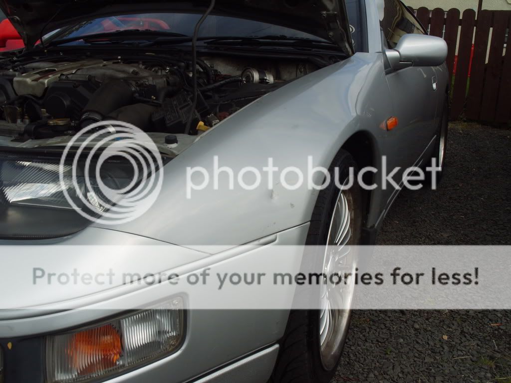

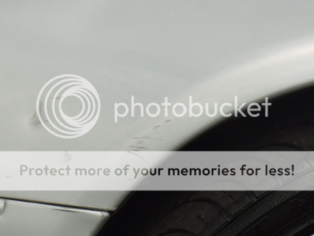

A few dings on front near side wing.

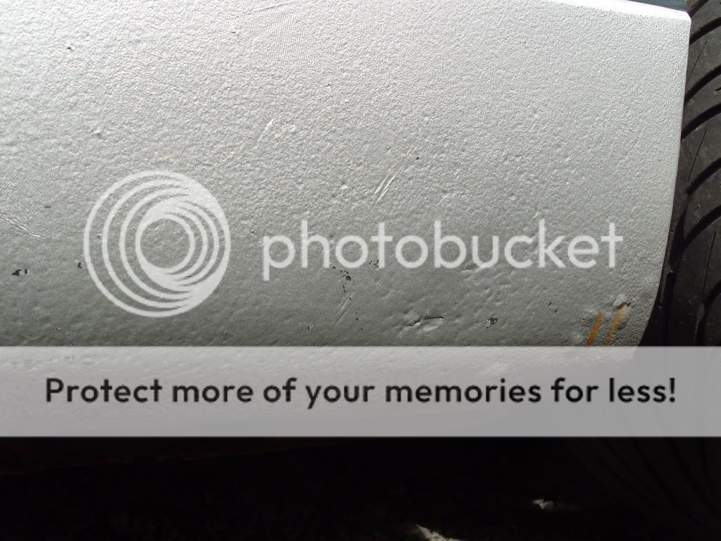

Rust (painted over) on NS cill
Rust starting on RNS wheel arch

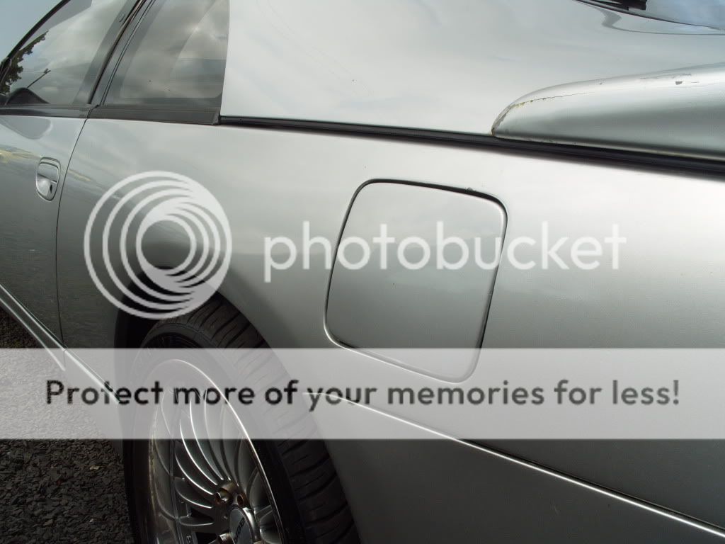

3 feet of a key score on NS rear panel

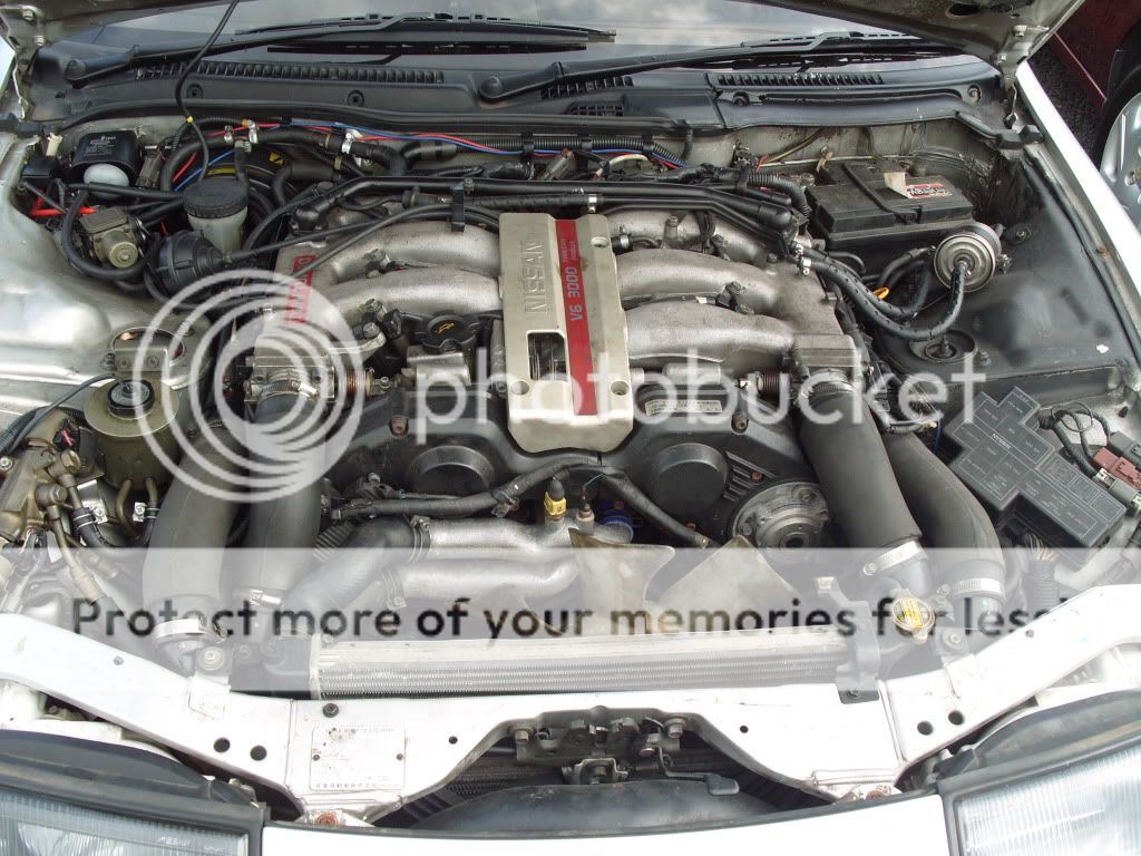

No fan cover in engine bay
NS engine bay painted black?
But what worries me the most is on the test drive although the turbos were spooling up the zed felt very slow compared to mine, exceleration was bad and this was a manual mine is an auto

Some photos comming up of bad points:thumbdown:

The sill lip looks to be pretty rusty, not just the blistering coming through.

The poor performance cause is clear to see in the engine picture, the cas unit is all the way to the right, so the timing is mega retarded or the belt is on wrong!! either way will be a major performance loss, who ever changed the belt did not understand about setting it up after, would bet things like the throttle balance will be wrong, tps, boost leaks all very common issues that get over looked by non specialists, the timing though will be the main power issue.

Well spotted Jeff I so looked forward to driving a manual zed for the first time but something was wrong just no power compared to my auto
why is one strut top silver and the other black???
The near side was painted black my guess to hide somthing but why black and not silver I dont know
