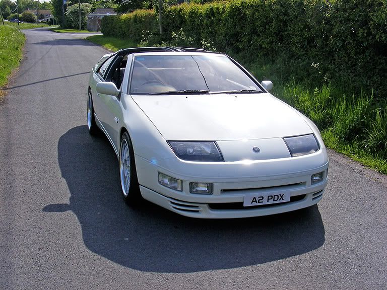

I fitted a 3/4 sized plate. Whilst it's not strictly legal, I've never been pulled over for it in the 6 years I've owned my car. It's perfectly readable (plain font, not nasty colours/borders/graphics) and isn't fitted to some chaved up motor that the police can find any excuse to pull over.

you need to bring that zed over ive never seen it lol...
