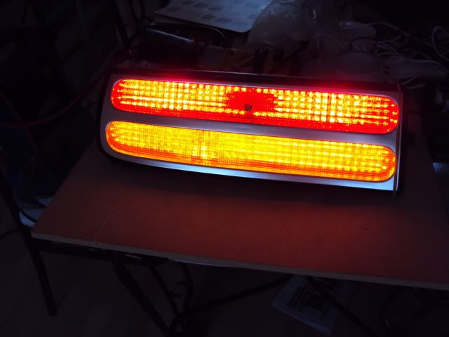

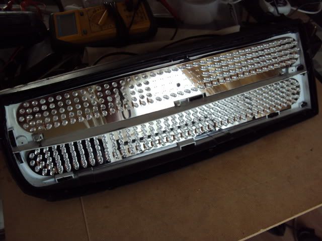

Finally finished installing the components and fitting out the light unit. There is a gap of LED’s in the middle of the top section because this is where the reflector sits on the outer lenses so I decided not to install any LED’s here because you would not see them behind the reflector.
What do you think?
Now for the big switch on...

I just came in my pants. Very nice. Absolutely beats the shit outta the crappy clear-corners ones. Nice work. NEEEEd to see em with the lenses back on.

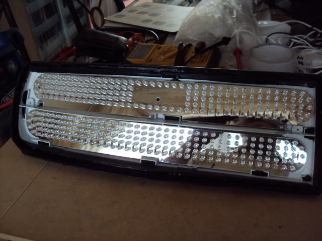

Well done Martin, excellent job. Can i ask why you put the resistors on the front of the board instead of the back of it? there'll be a little heat build up with those little suckers lol

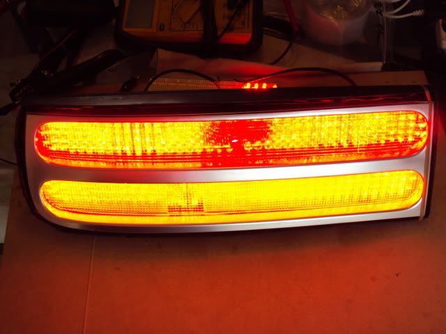

The units i used were slightly damaged when i got them so the lenses arent in the best condition but, i will clean one up and put it on and take some picturers
Thanks Graham. What condition are the unit you have? The lenses on my unit aren’t the best.
The plan was to put the resistors on the back but lack of space on the ends and parts of the mid sections between the board and the light unit put pay to that.
Im no electronics expert so I use a LED array design program, which gives me the resistor, values to use in this case 1/4 watt. Do you think this is enough Graham ?
Hi Bud, i have the 99 spec lenses here and are virtually mint.
They will be fine, having one resistor per line in series is far better and more efficient when doing larger arrays. Top work.

Well the lenses on the units i used are well fooked but tthe bases are a1 maybe we could combine my bases with your lenses and make a good set for testing on some lucky chaps car :thumbup1:?

Can i recommend that you use the diffuser plastic on both the top AND the bottom of the inner casing as apose to the red upper. Seen this done before. Ashleydc has these on her car which she bought from 300zxDre. They look far better than having the red top lens glass. I'd also point out that Andre spent a LOT of money on thses LED lights like the ones you have from the states. between £500 and £600 if i'm not mistaken.
