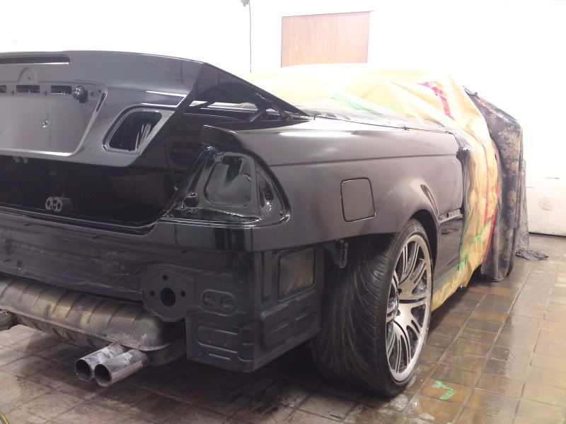

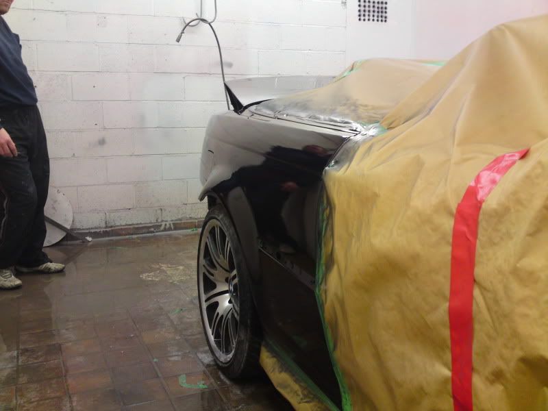

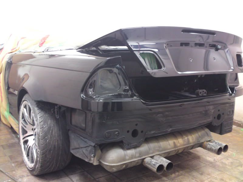

painted in carbon schwartz metallic, its looking great now
Very nice Allan. looking forward to seeing it fully assembled. :rockon:
gonna get it all flat polished during the week and hopefully next friday put it all back together, if all is well then it will be getting mot'd on sat
Spot on mate, have you got a new rear bumper, we havent seen any pics of that yet.
nah mate, got a slightly damaged bumper that is being repaired this week, only just got it, should be repaired and paited for friday ready to put on

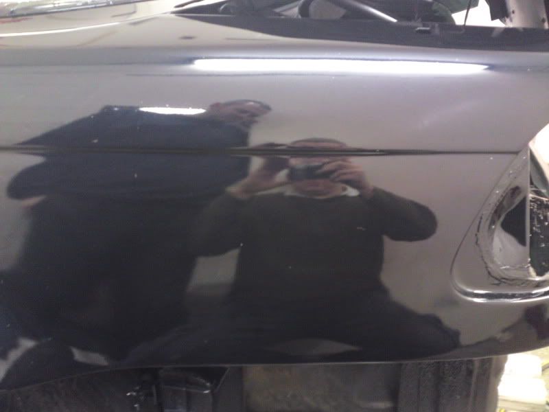

its a really good job, only one bit im not happy with and it wasnt even a repair we done, its a small ripple low down on the qauter that none of us seen till it was laquered lol, but you do have to be on your knees to see it
im thinking of a full respray possible in white for next winter so it will be done then

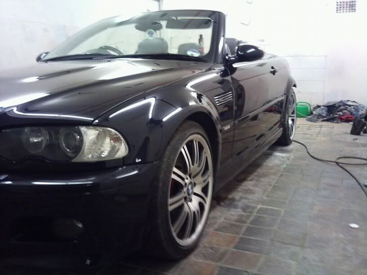

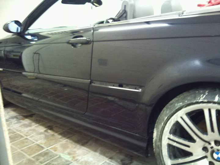

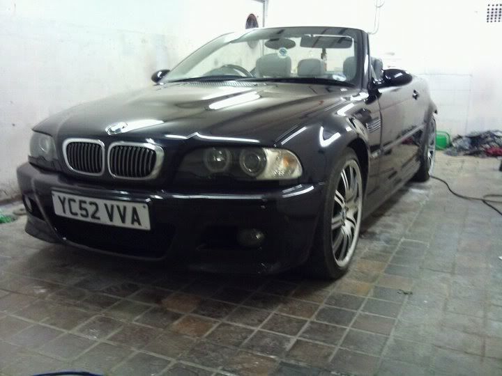

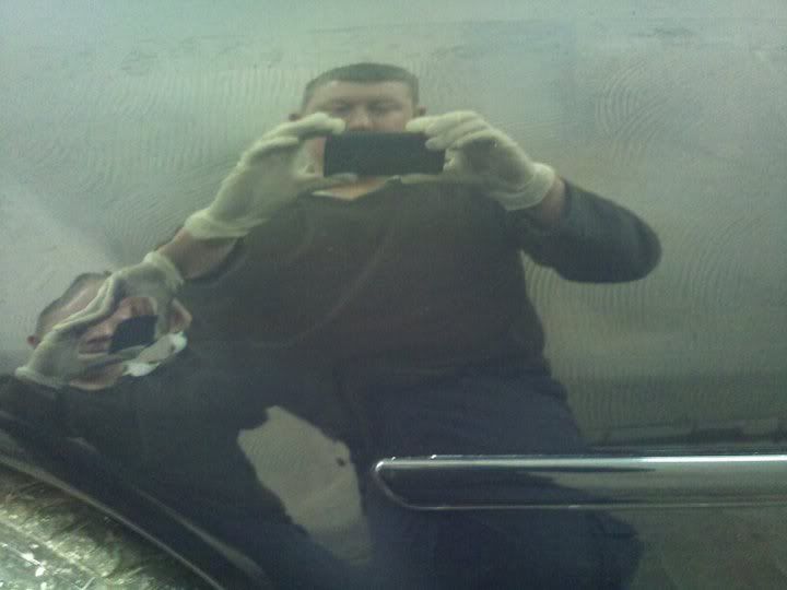

couple of teasers, all flat polished with 2000 wet and dry, then machined with g3 then machined polished with a finishing agent and then waxed with a deep shine wax
been on two days doing this and achieved a mirror finish and im over the moon
Edited by stellaZ
Make sure you use some tyre slick or paint mate. nothing worse than seeing a nice shiny car, with minging dirty grey tyres. looks awesome. very happy for you mate. :cool3:
cheers guys, tell you what though, i dont envy painters or paint correction as a job
im aching all over today after all the polishing

A private plate would be the cherry on top mate ;)
