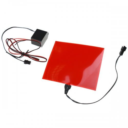

This is the el panel i bought, it comes with the convertor, all you have to do is splice into the rear number plate light. Looks the nuts at night...
http://cgi.ebay.co.uk/1-piece-of-electroluminescent-panel-12VDC-EL-inverter_W0QQitemZ380133436988QQcmdZViewItemQQptZLH_DefaultDomain_0?hash=item5881b7ee3c&_trksid=p3286.m63.l1177

they did glow great but former owner wired them direct without invertors but can get el panels on ebay very cheap to ,they look really nice when working
EL Panel Red Neon Glow Back Light Board 12V DC Inverter
on ebay company name vitual village based in hong kong £7.50 they do loads of colours and products hope this helps

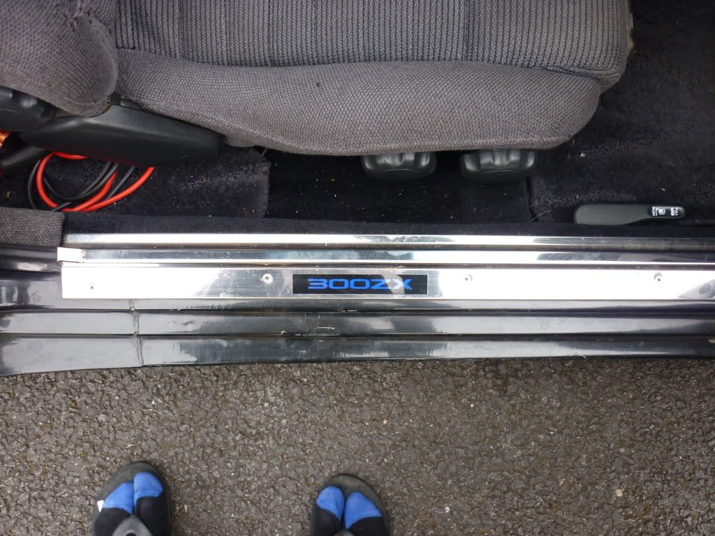

disk005-1.jpg would have made sense to take pic in dark lol
Nice FLIP FLOPS :lol: or are you a camel?
