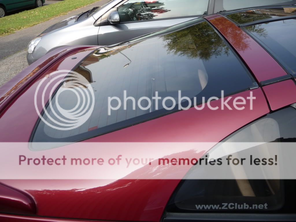

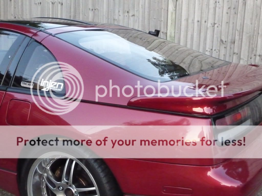

I removed the wiper and squirter as you may have seen.
I have since decided to ditch the grommet idea for the rear screen and instead have used Tiger Seal.
All I did was place some tape underneath the tailgate to sop the tiger seal from dripping through, injected the tiger seal into the hole in a thin layer and allow to set. The next day i removed the tape from underneath then layered some more seal into the hole, this time strengthening it with a metal plate to give rigidity. The following day I filled in some more so that the seal was proud of the screen and then, whilst it was still wet, took a stanley knife blade and dragged it across the top of the hole giving a flush finnish. The end result is a very clean fill in black with almost (but not quite) the same shine as the glass.
What do you reckon???

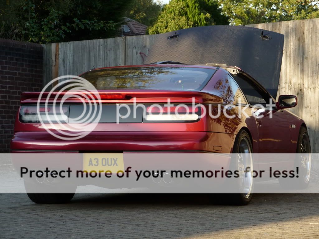

Thanks. The blackened out centre panel makes the rear look less cluttered and not quite so eighties if you ask me. Each to their own though.

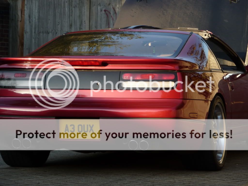

like the look of the rear end . how did u delete the middle panel sign and the little lights ??
Took panel off car.
De-greased with brake cleaner.
Very light sanding with emery cloth to create a key.

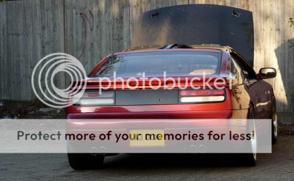

Sprayed lightly over lights to allow lights to shine through when activated with satin black paint and heavily over 300ZX logo.
3 coats of lacquer and then after a few weeks, buffed up with T-Cut whilst on the car to match the same shine as the light panel either side.

Do your reversing lights still show through the newly-painted panel? Is it MOT legal?
Yes Lammypie,
The reversing lights and fog lights still shine through. It passed its MOT no problem on the rear fog.
