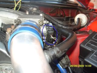

can anyone tell me if this is correct There is a plug with 3 male connectors but only 2 female ones connecting to it, I've stripped it back to see if anything is broken but nothing.
Ok, The injector seems to be firing (i can hear a clicking noise anyway)
which one? cant make out from the pic, can you circle it?
