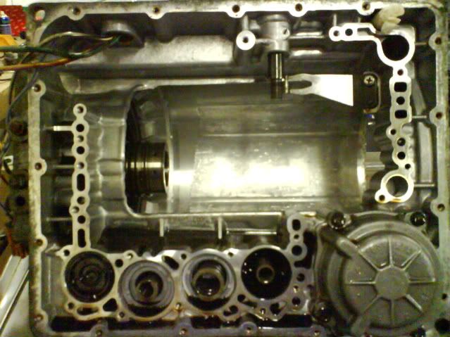

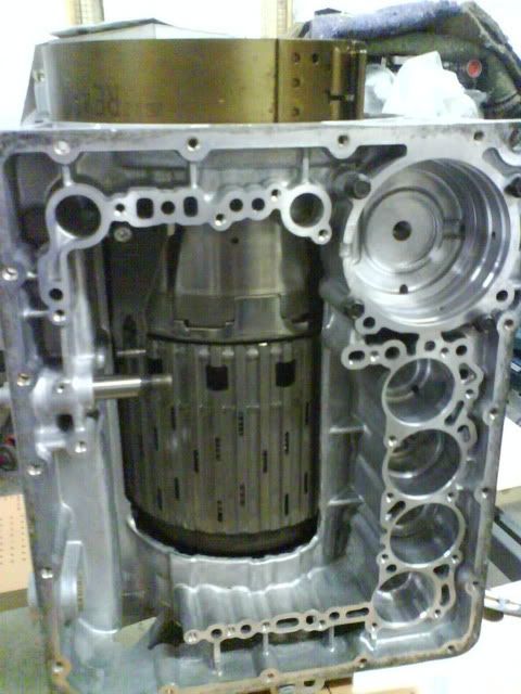

inside main case showing (from left to right) accumulator pistons a,b,c,d and brake band servo.

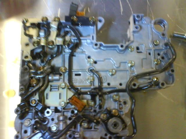

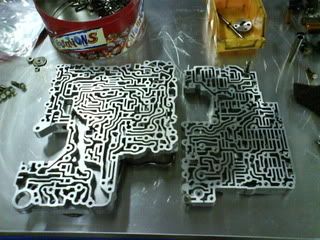

control valve assy.

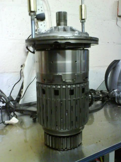

clutch assys as they would be in the case with oil pump on top.

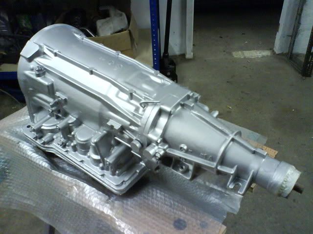

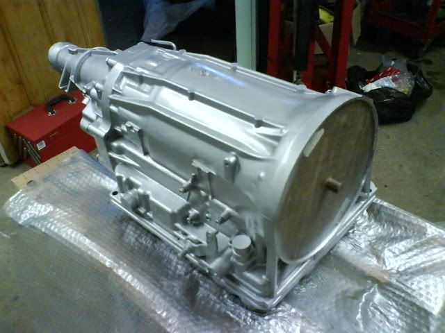

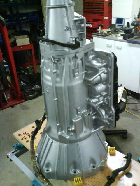

case after shot blast and paint.

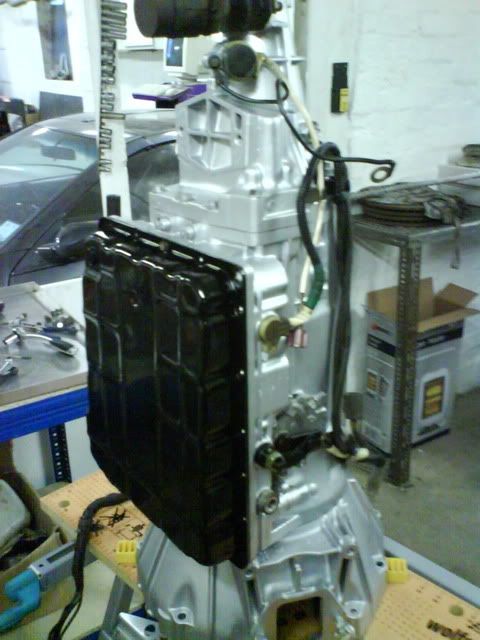

finished and ready to rock.

good pics....what bits did you replace out of interest...and why?
cheers
The box started going the usual way, losing third then not changing at all. I done some fault code checks and then when i checked the oil it was a nice brown burnt colour so defo dead box.
This box had complete set of friction plates and springs, re-bushed, new brake band, new filters, seals and gaskets and a shift kit fitted.

The shift kit comes from the states and is designed to raise the line pressure in the gearbox.
Basically an auto transmission relies on hydraulic pressure to operate clutch plates, which in turn select the gear via the control valve block and solenoids etc.
The clutch plates are like a multi plate clutch on a motorbike alternate steel and fibre plates, which transfer the power of the engine to different clutch assy to give different gear ratios.
Now, when these clutch plates start to slip due to either higher engine output or natural wear and tear over time they generate heat and start losing the fibre material from the fibre plates and the AFT oil starts to deteriorate and becomes contaminated blocking the fine mesh filters in the control valve block. No more gears!
So to cut a long story short the shift kit raises the hydraulic pressure in the gearbox by means of stronger control valve springs and a few mods making the clutch plate’s grip harder preventing clutch slippage.
