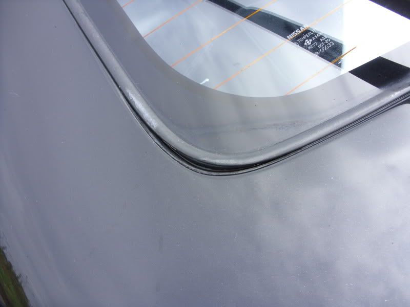

My rear window trim seal has kind of pealed up at the corners (as below). It's been like it ever since I got the car 6 months or so ago.
I've been told that the seals are no longer available new, and a second hand one is likely to be brittle and break if I tried to remove and fit it. Anyone any suggestions?

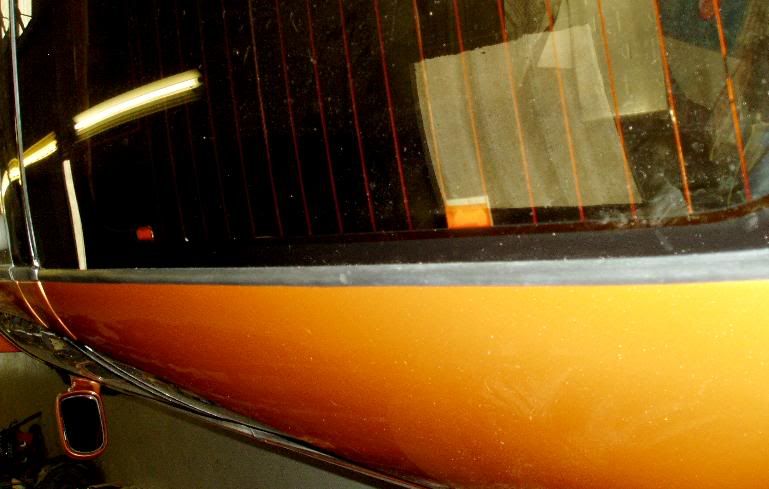

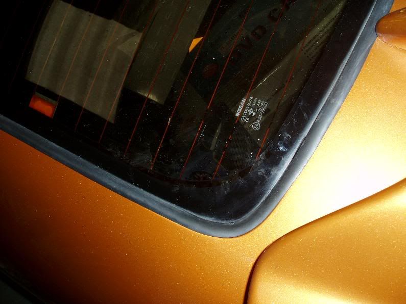

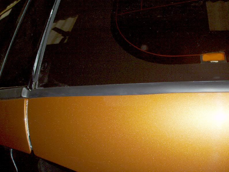

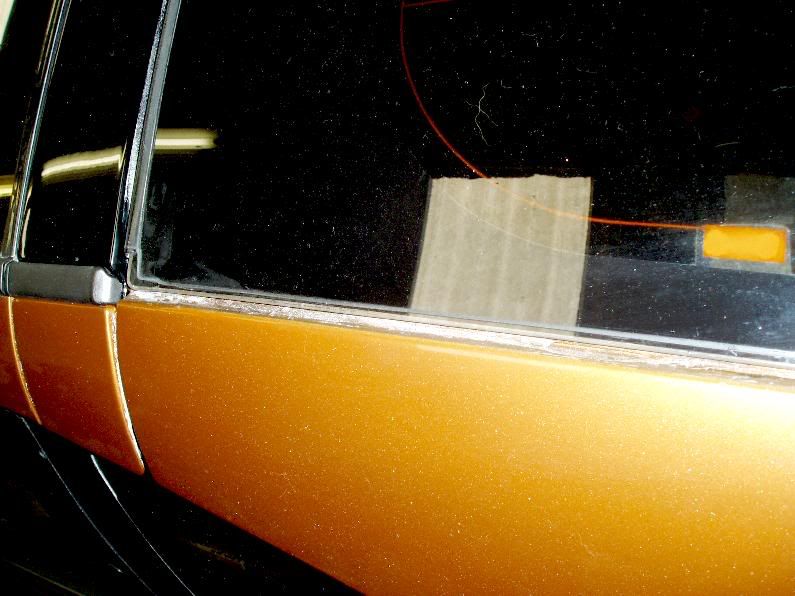

Here you go Phill as promised photo`s of the universal seal before and after fitting, there is still some slight adjustment required to the final fit with some extra soapy water the seal will sit even neater.
Jeff TT

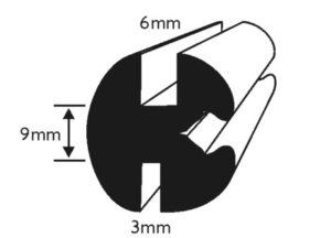

The new seal has a barbed protrusion that is inserted into the gap left between the body and glass, it hook`s in, it also buts up to the top corner trims quite nicely, there are several designs that can be used see below, I have used the fourth one a few times, some you might need to adapt a little, I warm it up slightly and use a small amount of sikaflex on the corners, and a small line run elsewhere, insert the seal and once happy with the fit put masking tape over it every 12 inches and leave over night.
Jeff

Cheers for your help Jeff, the first one I can find quite quickly. The last one, which I assume would be your preferred choice seems pretty hard to find. Once I get the seal i can then be happy with how much material to remove off the old seal. Boot keeps flooding atm which is annoying.
