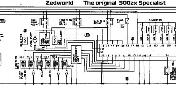

Check out the circuit diagram above which among other things shows the fuel pump relay and the equally crucial coil pack power relay, for the purpose of this illustration the coil pack relay will be focused on but to a slightly lesser degree the fuel relay and eccs relay has the same potential issues.

The coil packs of course have their own power supply, this needs to be switched on with the ignition and of course switched off when the ignition is then switched off. As is common with most car circuits the use of a relay is used to allow smaller current carrying circuit to safely switch a larger one, makes sense from an electrical point of view and power management point of view ( location and running of high power cable)
Ok nearly there now, the coil pack relay has contact in it that is used to transfer the power to the coil packs, these contacts have now been switching and carrying current for near to 20 years on some zeds and we have seen an increase in problems with the said connection.
Basically a bad connection will supply the coil pack with plenty enough power to run and seem to be fine, but as current demand rises the weaker connection reduces the available power to the coil packs in direct relation to demand, so having seen more relay issue arise on a hunch we have done some back to back testing and in something like 40% of cases the reduction in power supply to the coil packs via the power relay has been significant enough to warrant changing the relay,simple...well sort of.

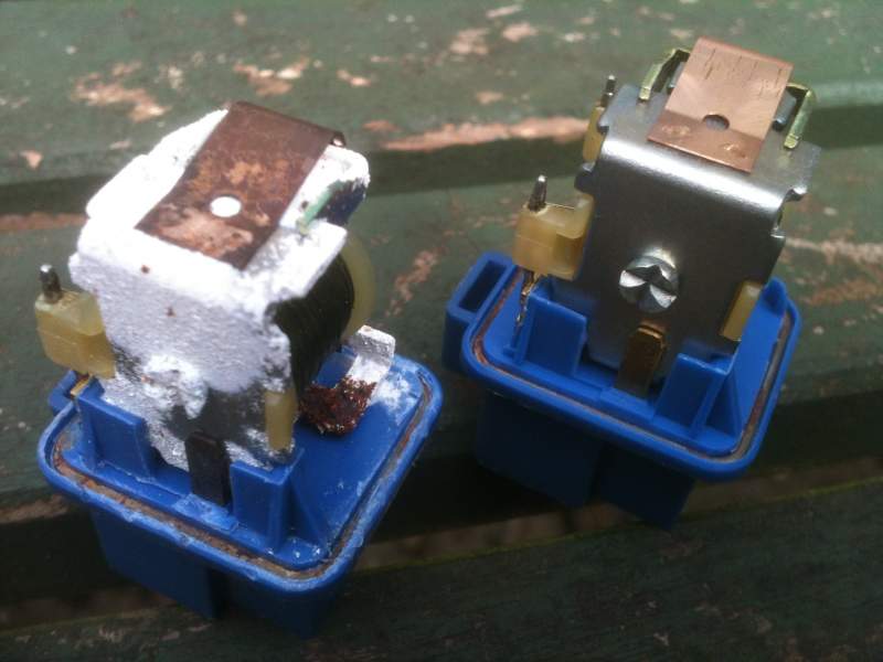

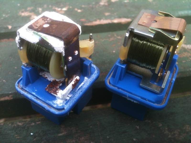

Also to back up Jeff, here are two relays from a 1990 tt one stuck now and then the other fine. As you can see from the picture both was sealed until I cut them open and know wonder it was sticking.

I can also show you a green relay in the same condition as the corroded as the blue one. I might be looking into this mosfet based power relay ....!
