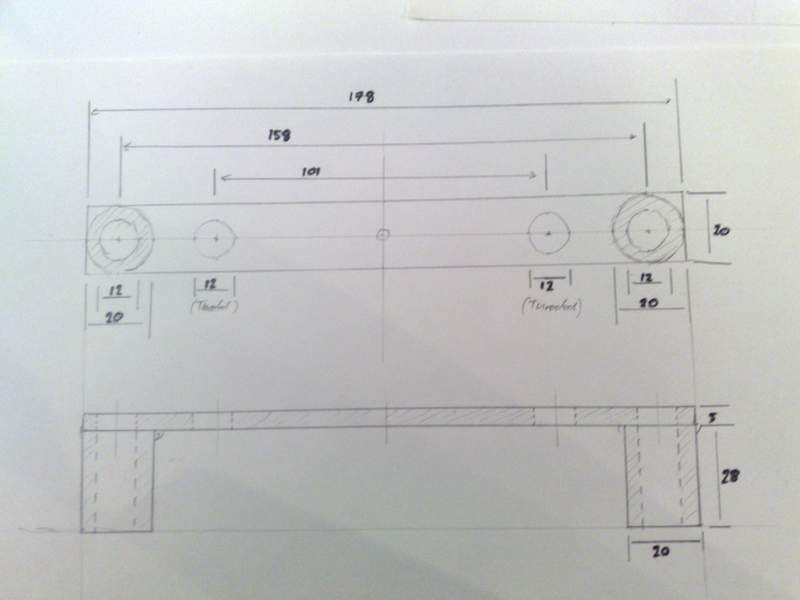

Bought some Evo8 calipers off flea-bay. Seen some of you guys have fitted these already, do you have any pics or diagrams of the mounting brackets I will need to get made?
Have a metal bender at work gonna try and get to make them for payment in beer.:dance::dance:

I've fitted them to my car bud, i'll try find the diagram fo the bracket you need to get made up.

here are my pic's and drawings there was a slight measurment change, can't remember what it was, it was the distance between the holes
I think those are the measurements i gave to the guy that made my brackets, they fitted perfectly...only thing i changed was that instead of tapping the back plate, i had the guy just drill a 12mm hole and i used nuts n bolts.
Just like to also point out that if anyone does want to go ahead with this conversion you will need to modify you hubs where the stock caliper bolts to it...there is a lug that needs to be cut off with a grinder or hacksaw (if you dont mind the arm ache) as you will see in krsmayo's 1st and 2nd pictures it fouls where the bracket sits so needs to be removed...after that though all will bolt up hunky dorey. All you need then is some brake lines made up to go from nissan to brembo. (think if i remember correctly the nissan fittings were different and also the pipe needed to be longer). I made my own braided lines for about £20 so its not megga bucks to do.
