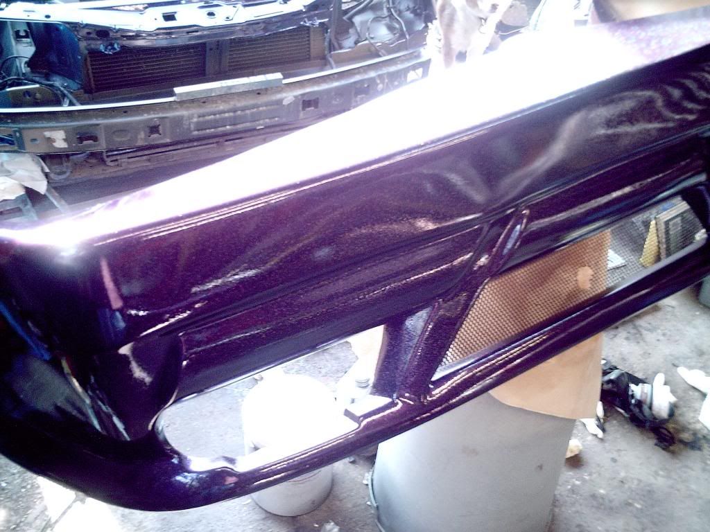

Calibra teaser

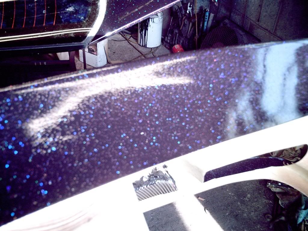

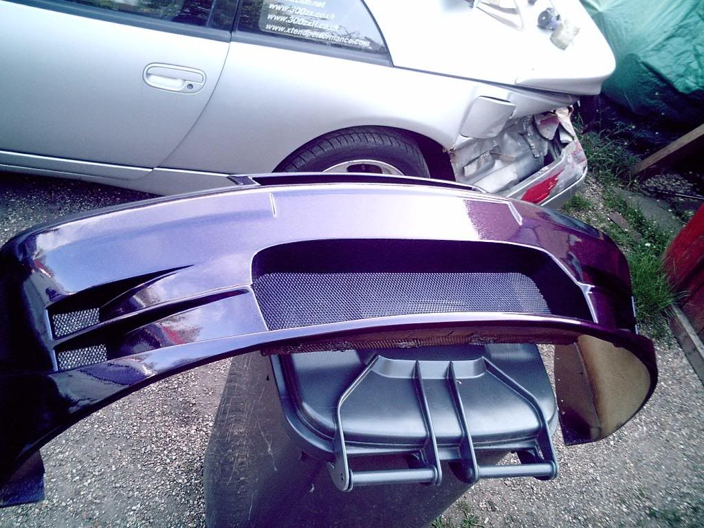

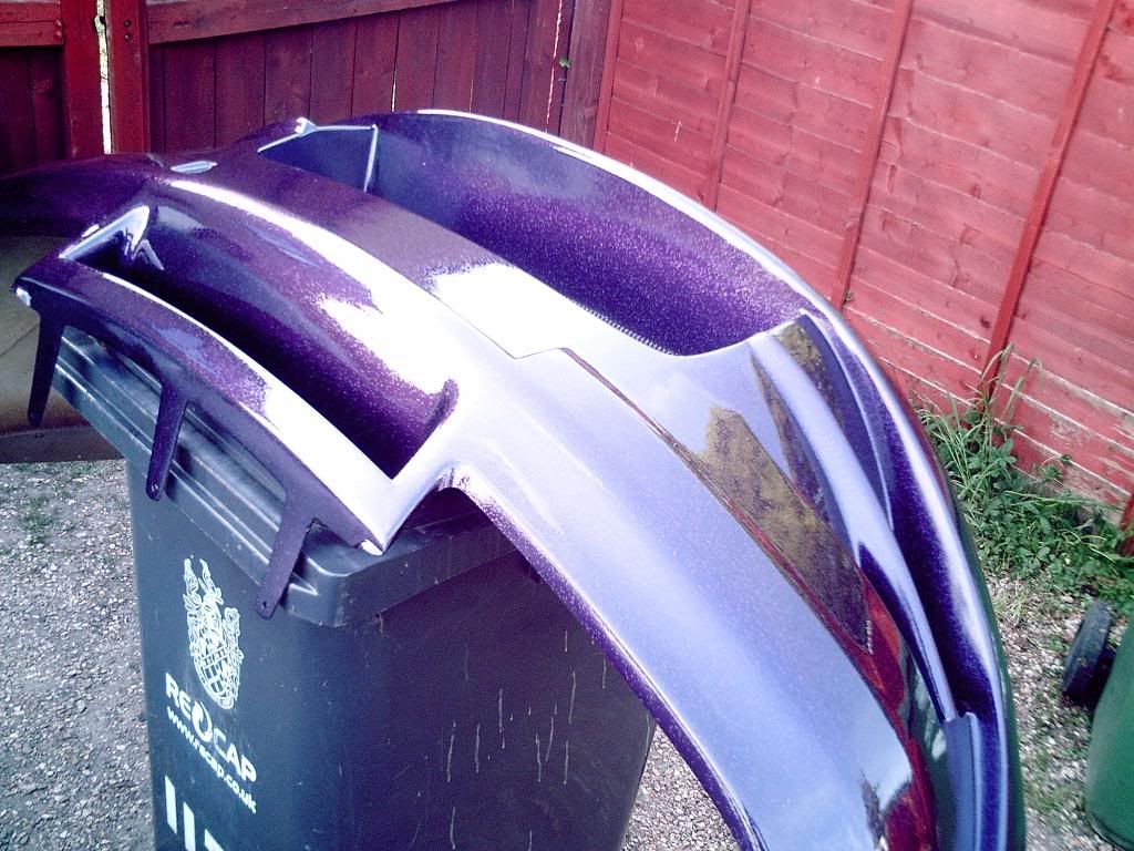

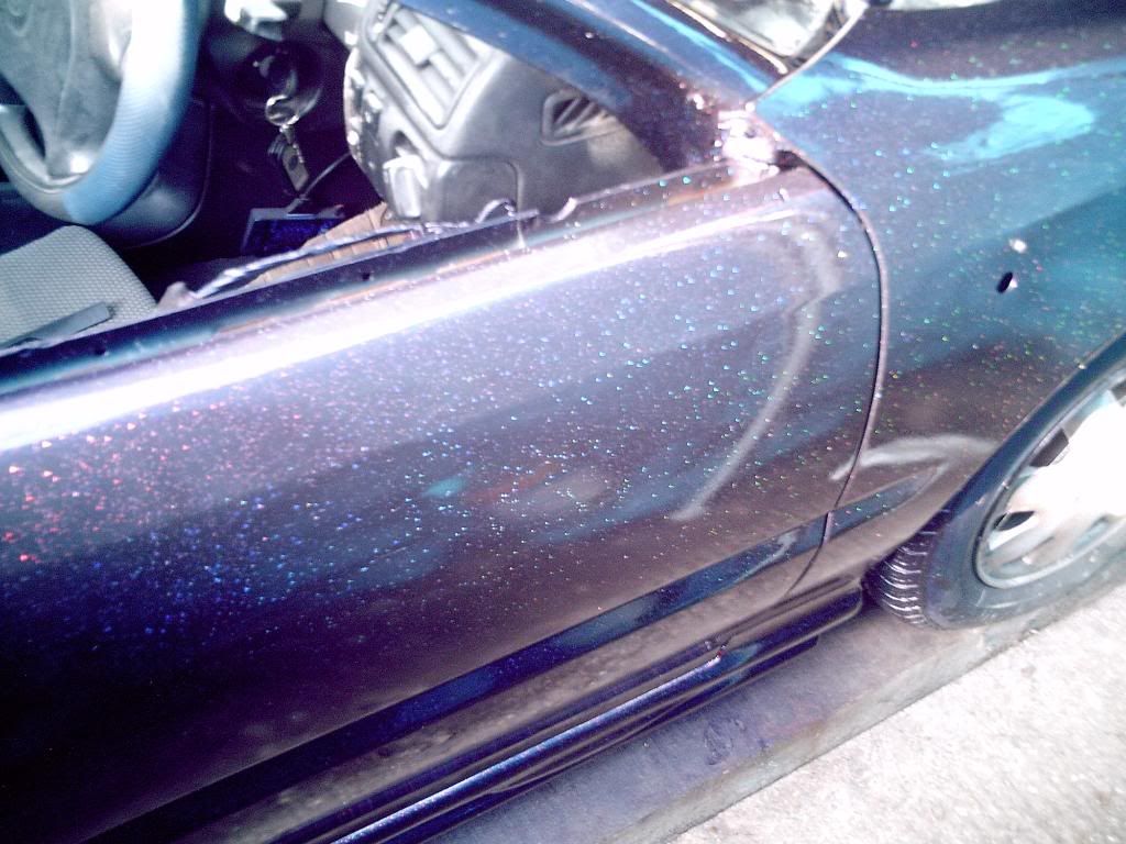

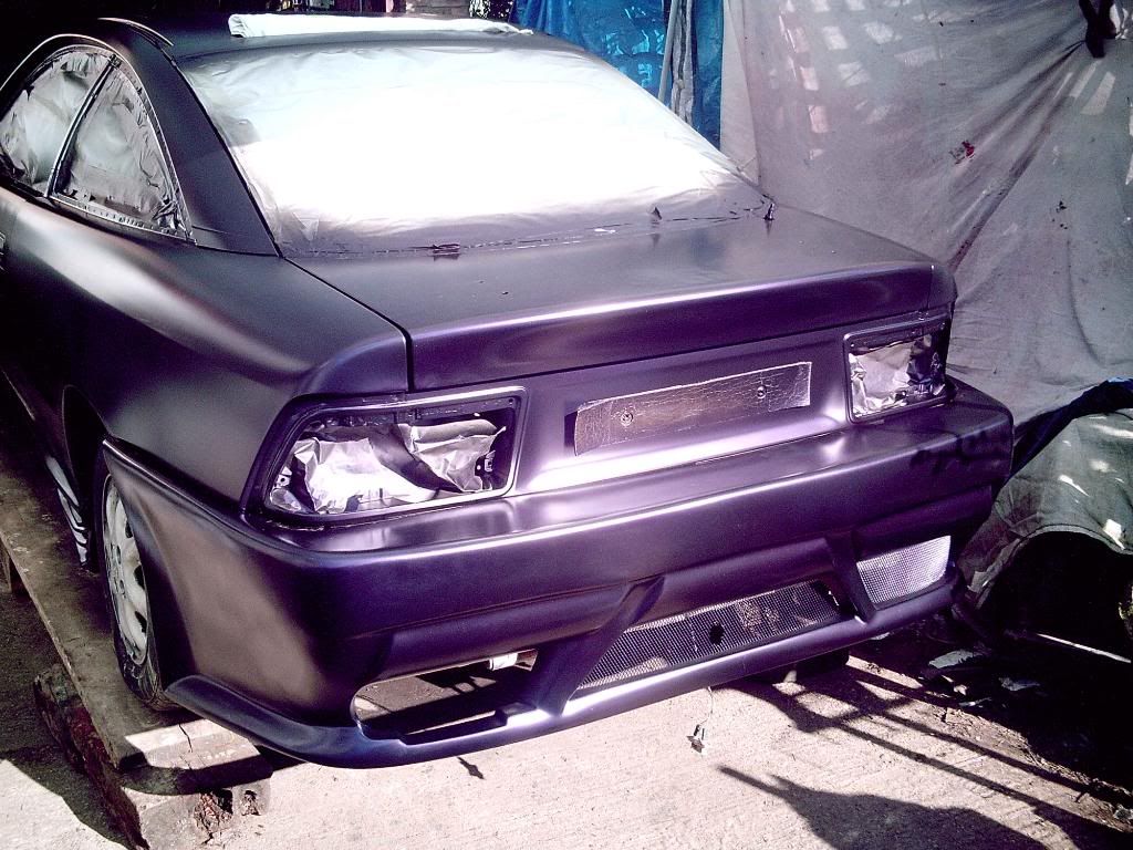

A couple of pics of the calibra rear bumper:hyper:
Looks even better in the flesh, there is a glitter effect as well

All I can see is a rabbit hutch. :confused:
Whatever it is, I just hope you didn't pay someone to paint that.

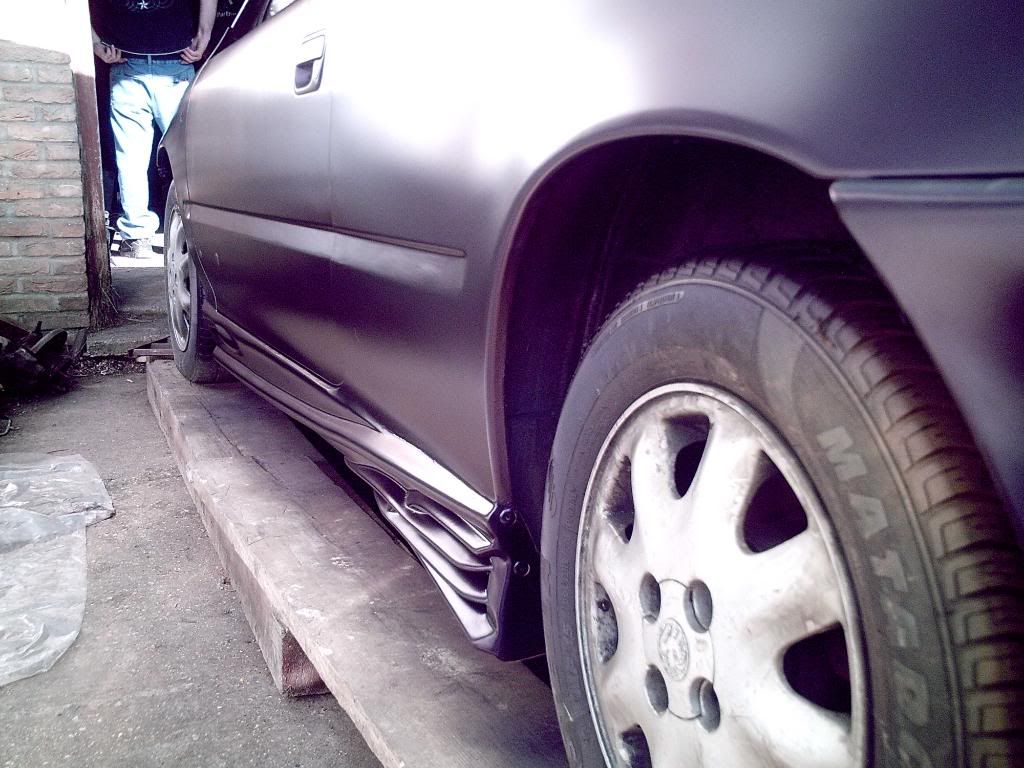

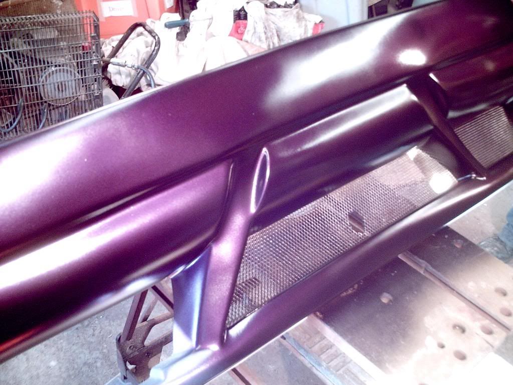

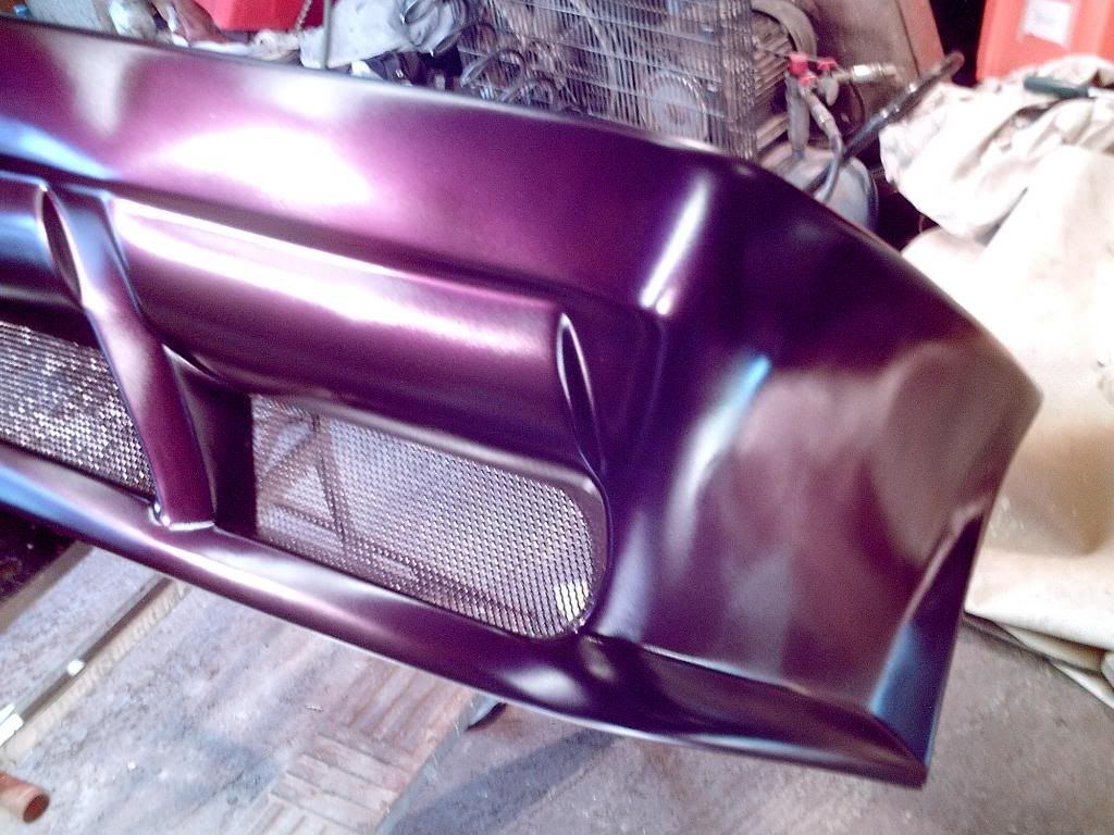

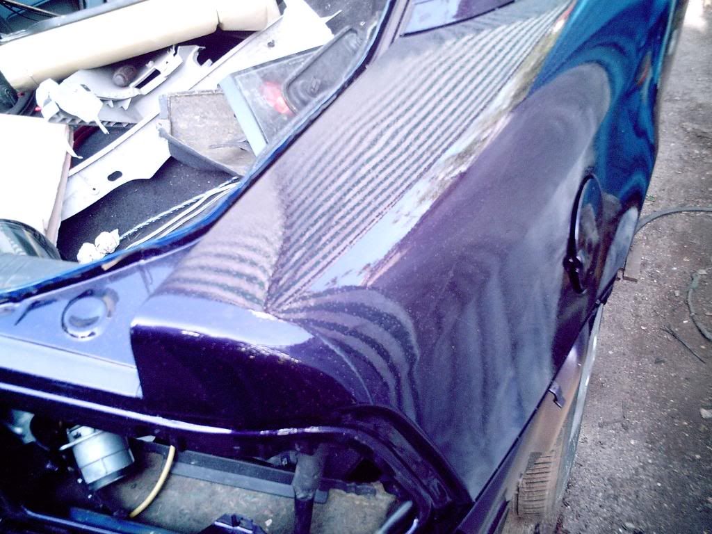

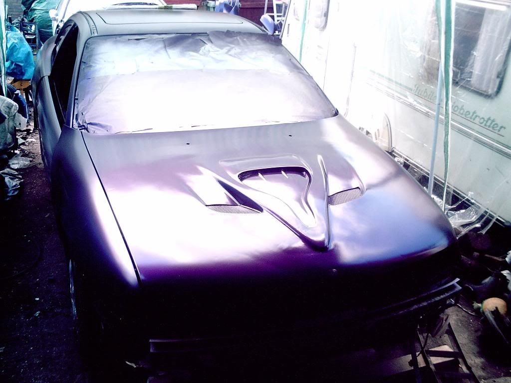

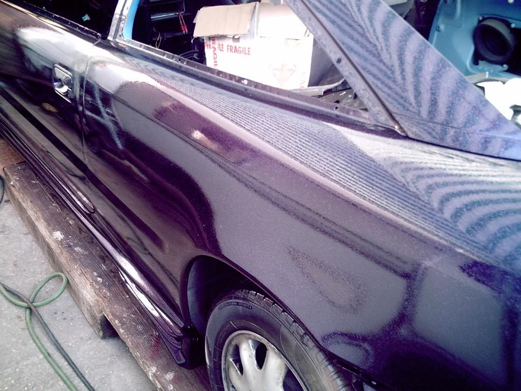

Car is all sprayed in purple, just need to laquer it next weekend.
I've got some pics to put up later, though they didn't come out too well:(

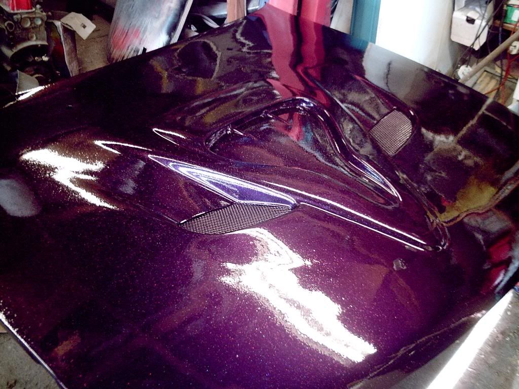

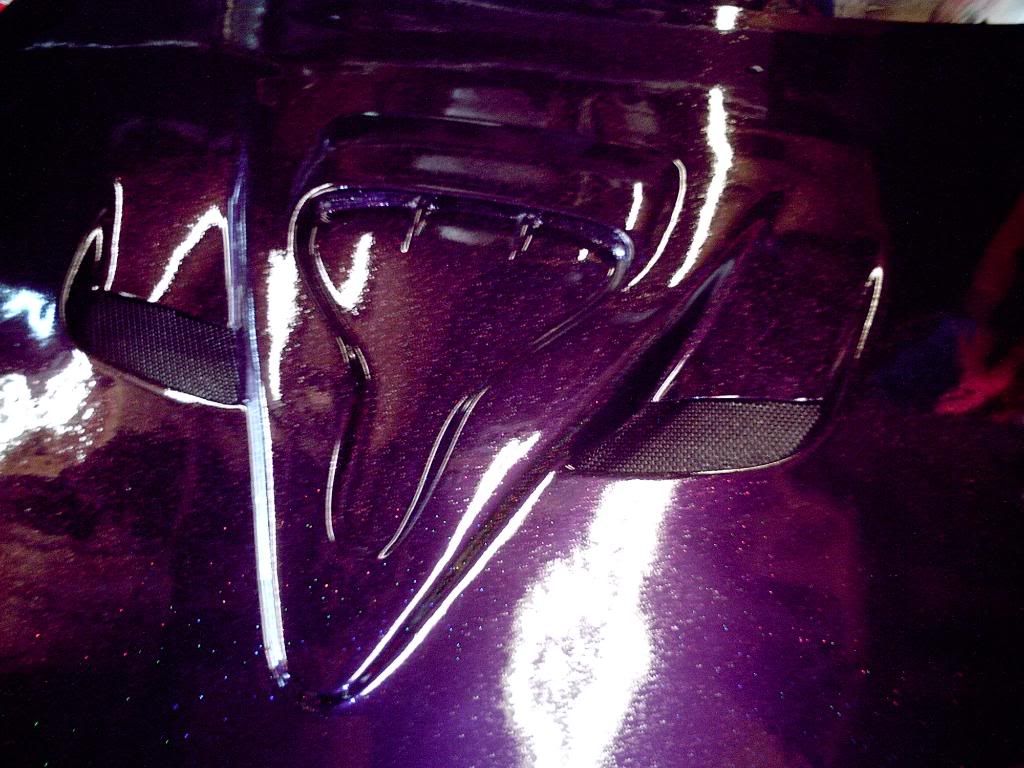

Looking good. is that one of my jap vents??
Remember with glitter paint you will need around 6-8 coats of laqure to get a perfect smooth finish :)

can vouch for that it will go smooth eventually with a buff and a flat but need sooooo much lacquer

No, It's one my misses bought for my 21st, was a few years ago. if you want you can use the pic though
It's had 3 coats of lacquer on it at the mo, might just leave it at that??

Do it properly you lazey bugger :rofl:

Cracking bit of peal on the that bonnet there. Horrible paint, but you've got a pretty decent coverage of the flake. Good luck with the flatting back, hope you've got plenty of clear!
