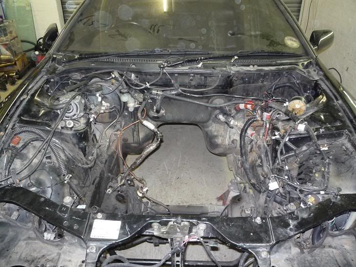

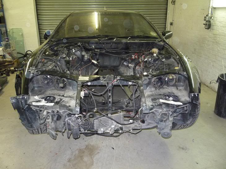

Here are a couple of pics of the car as it looks now down at Custom Exotics.
Thanks,
Ant
This is was a week ago when it arrived at Custom Exotics
Pics from today

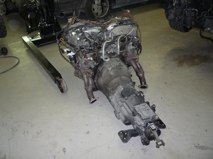

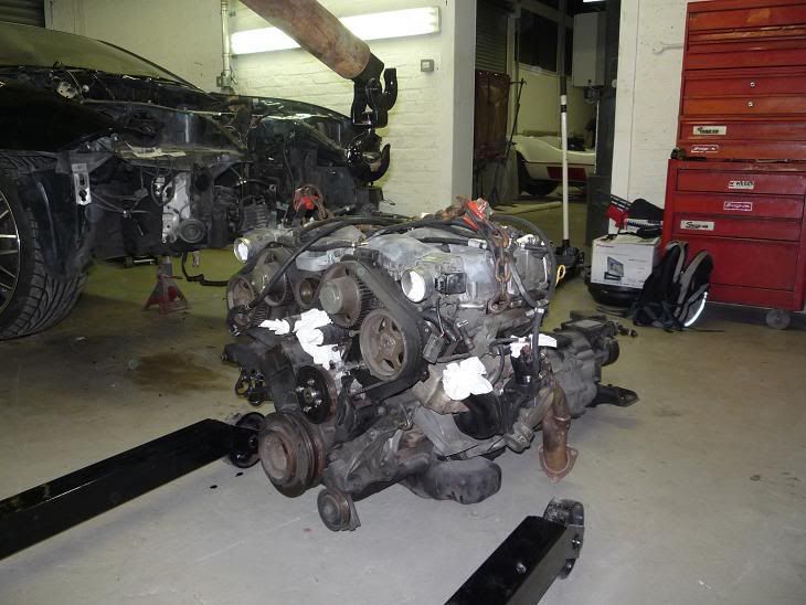

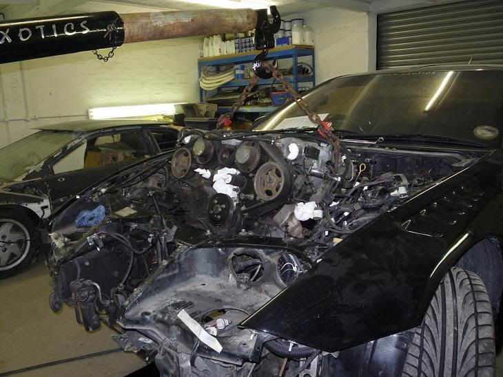

I managed to get more done on the car this friday. I got the remaining items removed and disconnected. Brett at Custom exotics helped me with the final little bits like the cross member and engine mounts.
We was then ready to lift the engine out. I gotta say that it came out easy than I expected. There were only a few things still connected that I had missed. That being the oil cooler lines to the engine and the big old earth connection by the battery. Other than that It came out relatively easy.
I was pleased with how it went as this is the first engine pull I have done and was expecting to have missed loads of stuff, instead had managed to get most of the stuff removed and disconnected.
I'm now looking forward to stripping the engine ready for the rebuild and hopefully learn a bit more :)
Still can't believe how many wires and vacuum hoses there are in the engine bay that make it look messy and untidy.
Well I took yet more pics :D

just curious as to why you have removed the front bumper and lights?
The bumper needs a re spray due to very high speed bumps I came in contact with ;) Also I'm replacing the light adjuster cogs on the lights so needed to remove them as well

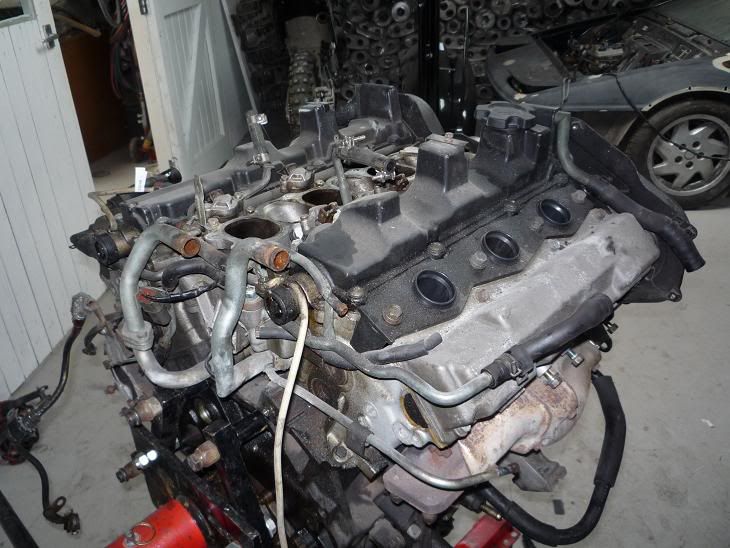

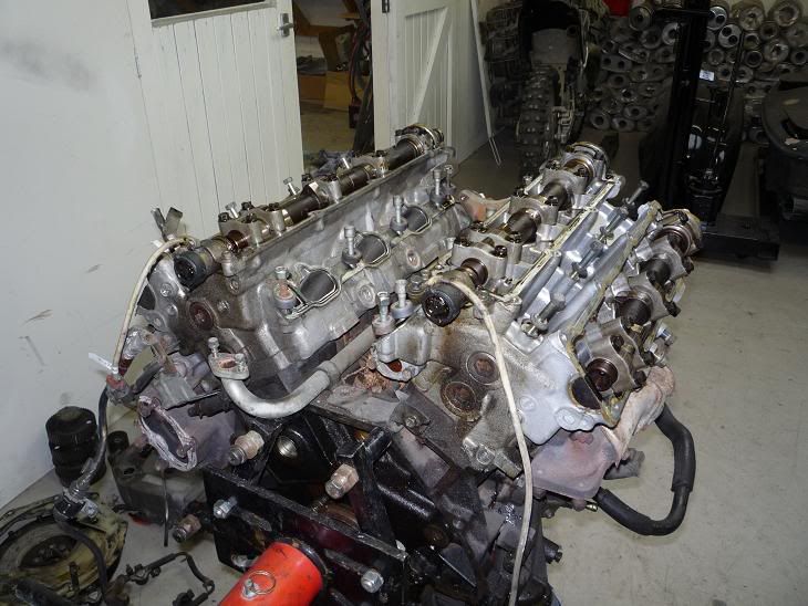

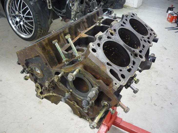

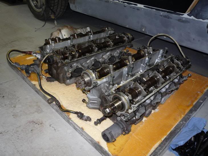

Some more work has been done over the last week.
Got the plenum off, as well as the tubs and both the heads. Couldn't believe the difference in size of the standard tubs compared to the GT28r's. The cylinder walls look good with no marks, so was pleased with that.
I will be back down there this friday and monday to strip a bit more ready for it to be cleaned.
I'm still enjoying the work I have done and learning a little each day.
More pics, hope you enjoy.

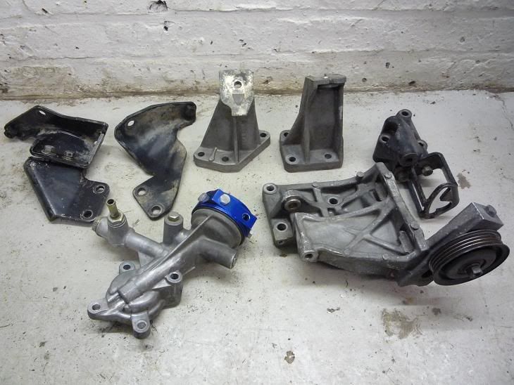

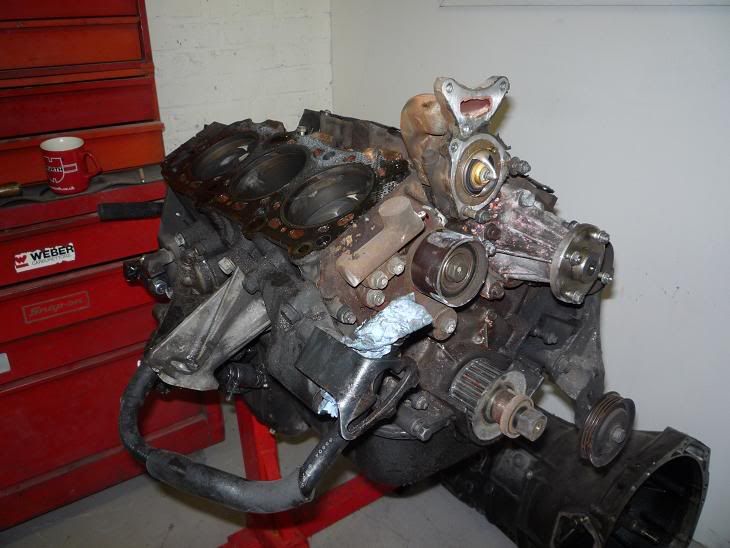

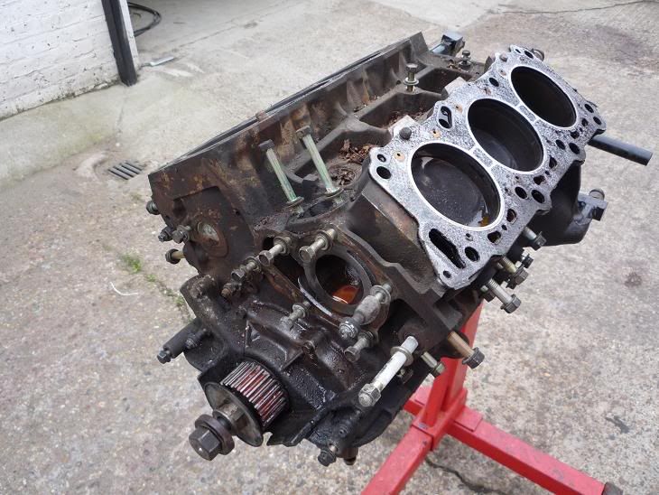

Spent another couple of days stripping the engine. The oil pump was a right pain to remove, never ever want to try and do that again. Took me half a day to remove with the help of Scott at custom exotics. Managed to get it completely stripped in the end and started cleaning it getting all the dirt and grease off. Got some of the smaller parts cleaned too, all ready to be sprayed, yet to decide on a colour.
Should be able to get down there again on monday to do yet more cleaning :D
Some more pics...

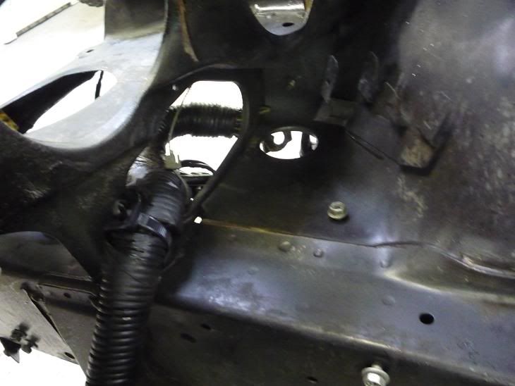

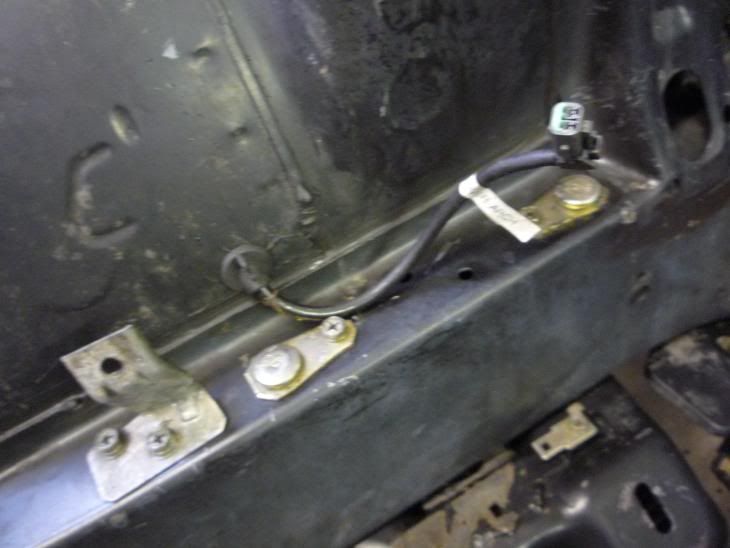

I went and done more work on the car on Monday. I decided to have a go at fitting the HICAS elimination bar. Halfway through I got side tracked and ended up in the engine bay lol. I had a look at the EFI loom and disconnected more connectors and took more pics and labeled more things. I also removed the oil cooler and the air con pipes ( which I'm still not sure if I should keep the air con) Took off the brake and clutch reservoir tanks. I am trying to clear the bay a bit ready to be cleaned and painted, also trying to decide where to relocate bits so I can simplifier the bay more.
I also got the ok from my girlfriend to put a few bits in the dishwasher to clean them up. Don't know how :D
Not much was done on Monday but hope to be down there again on Friday.

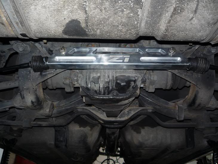

I managed to remove the whole Hicas system, from the rear Hicas system all the pipework under the car and the solienoid was removed ages ago. Replaced this with a Z1 Hicas elimination bar.

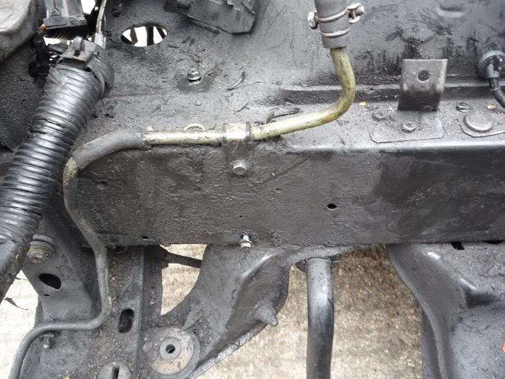

I then moved onto the engine bay, removing a few bits ready to clean the bay up. Sealed a few bits up that I didn't want to get wet then went at the bay with some good old Gunk. This is the first time i've really used this stuff on some really thick ground in dirt. Applied then jet washed off, I done this a couple of times and this stuff is really good and removed some thick old dirt. I also cleaned up a few more small bits off the engine.
I am thinking of relocating the battery to the boot and next I have to remove the battery tray as this is rusted up quite a bit. I also removed the brackets on the wings that held the hicas solenoid to the car.
Hopefully the bay will be ready to rub down and spray up soon.
A few more pics below of the before and after the cleaning of the bay.

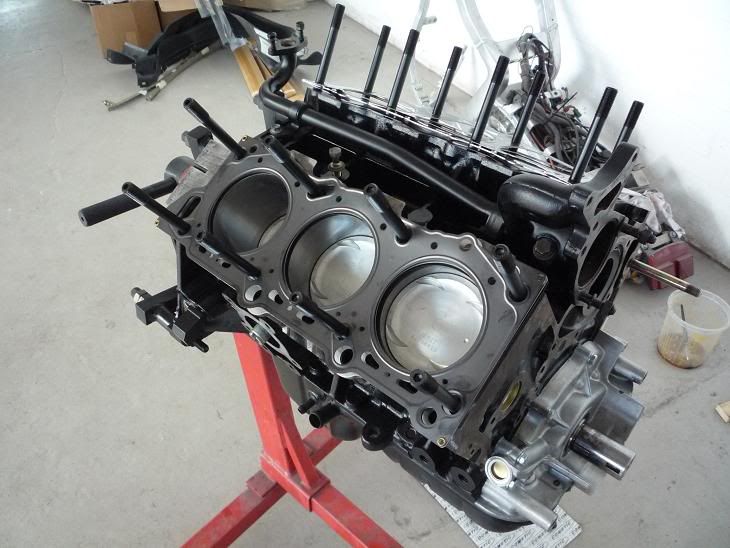

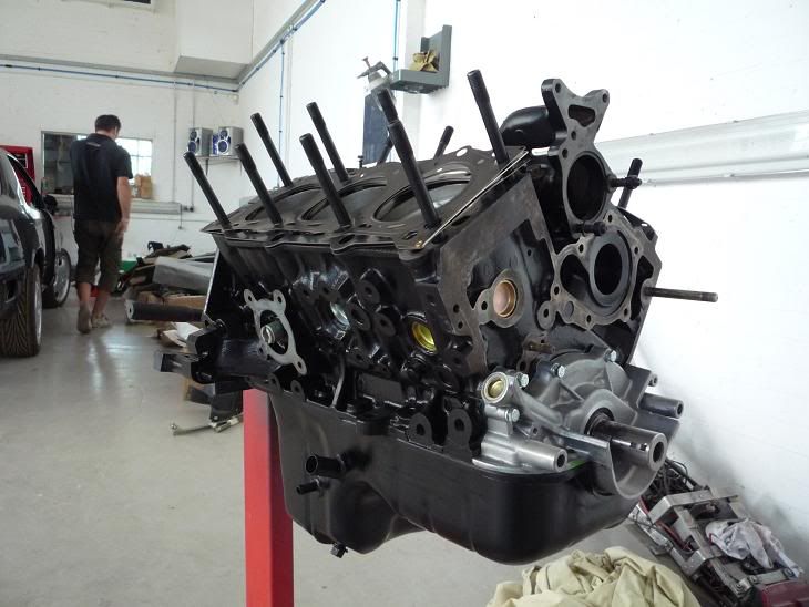

Been a few months since my last update. It's been a bit slow recently, i took my block heads and crank to ctm performance to have the engine work carried out. They said that it would take 2 weeks to carry the work out, 4 weeks later and i get my engine back but still had to wait for the bearings as no where in this country had them. After 2 weeks these turned up too.
Scott at Custom Exotics sprayed the block and a few other bits and i was then able to start putting things back together.
As you can see from the pics i've manged to get a few bits back and gotta say thanks to Brett and Scott for the help i've had so far with a few little things. Got to get the knock sensor ordered quick as i don't want to get to far and not be able to fit it.
I am going to have another colour in the engine bay too, but not going to tell you what colour it is :D Going to have a few bits chromed as well.
Really looking forward to getting it all done, i have enjoyed building it so far but bound to have some bad moments.
Here is a few pics, hope you enjoy.
