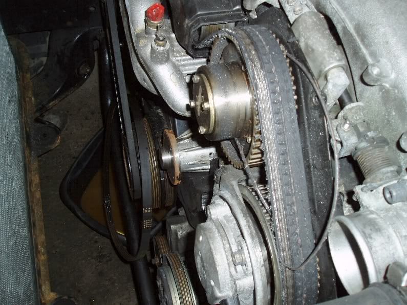

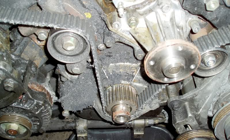

The background to this particular fault is as follows, a rebuilt engine from a small company with in house engineering cnc machining, heads and turbo rebuilding facility.
Car was collected from said builder and around 60 miles later the following was discovered after an engine noise was heard and seem to be getting worse, the noise was semi metallic with a scrapping noise in time with engine speed.

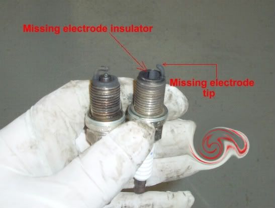

Ok another poser for ya, take a look at the spark plug with the bits missing, see who can guess correctly how the damage occurred and why, it may not be quite what you think.:x:
Jeff TT
Edited by JeffTT
Is this a cause of Detonation ? and / or over boosting :confused:
Edited by zogg
All kind of right, yes it was caused by det but why did it det so bad that it needed the following.
Jeff TT
Edited by JeffTT
Turbo boost too high ?
Oh your all so close your so ALMOST there, Ok 21psi with a standard ecu, the cylinder the plug was in had 0 psi compression, bits from the cylinder had gone through the turbo, replacement engine too then:(

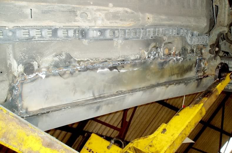

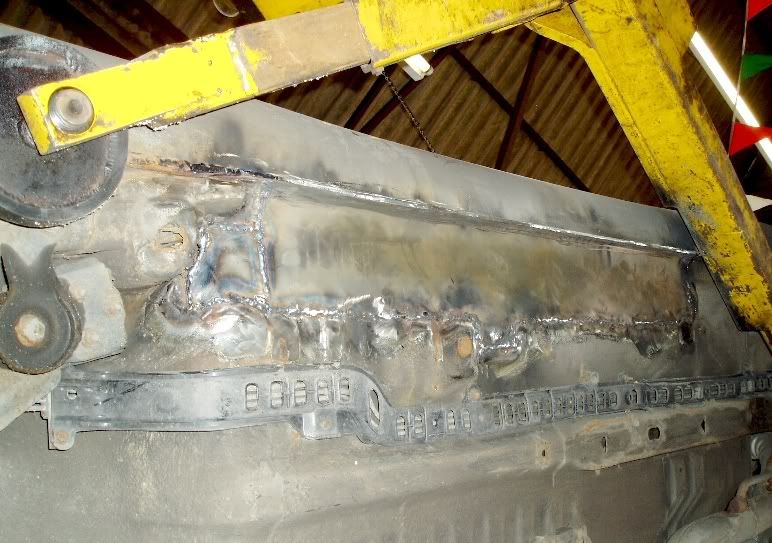

Remember the corroded floor? the end result after welding

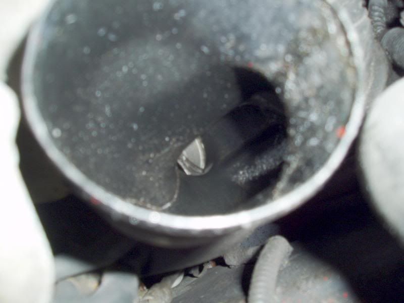

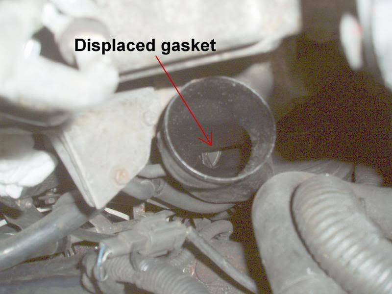

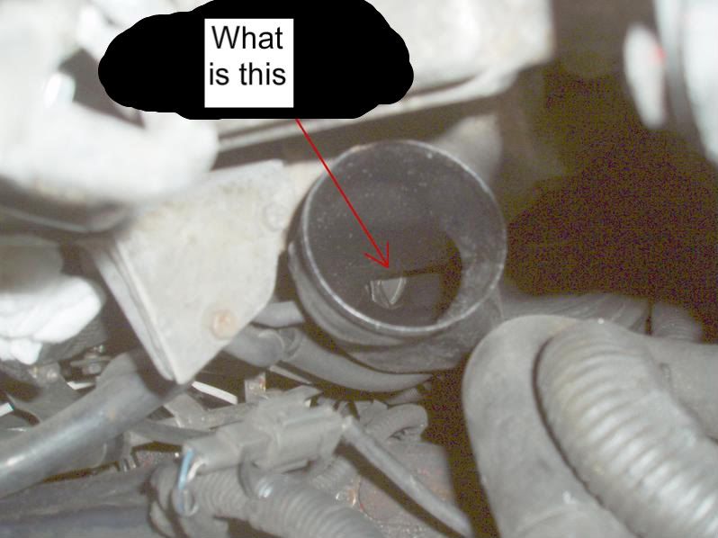

Ok try this one, foreign object can be just seen down the drivers side turbo as viewed from above, the engine was not boosting well.....at all.
Guess what it is?
Jeff TT
Ohh good guess.........but wrong :D
Jeff TT
Is that the turbo outlet pipe (compressed air)?
Yes the one that goes to the intercooler.
Jeff TT
A blade off the compressor wheel?
Nope, another clue is the turbo`s had been recently changed.
Jeff TT
part of turbo bearing/thrust collar? or wild guess wastegate flap (but thats exhaust side so cant be or can it?
Edited by j1mmytt
Piece of tissue or paper used to block of the intake.....

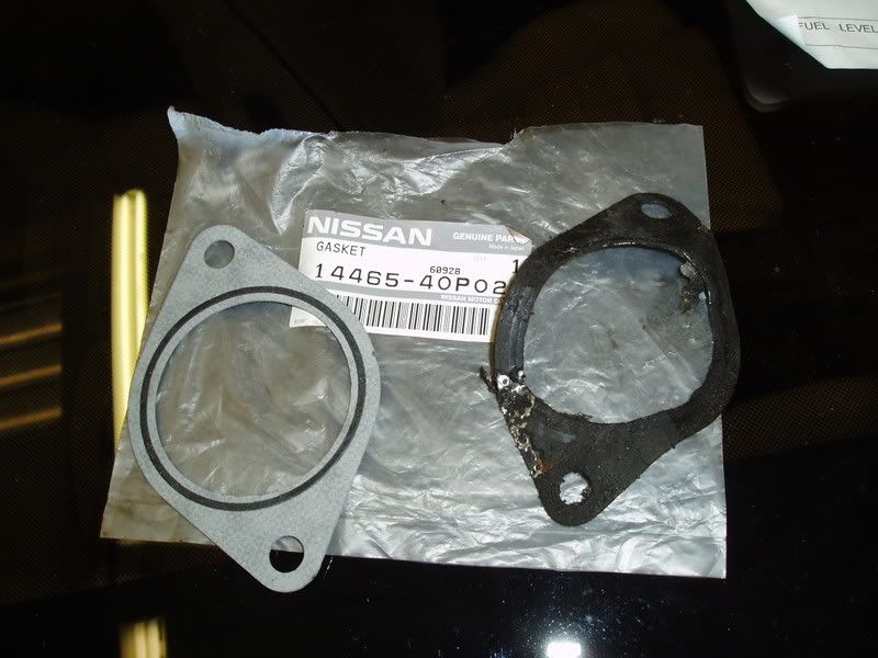

could it be part of a gasket
WINNER :dance::dance::dance:
Jeff TT

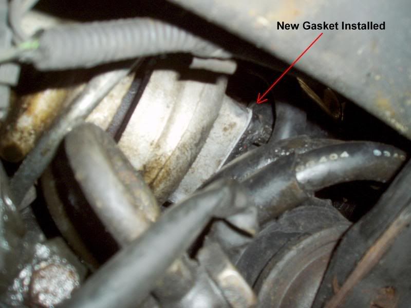

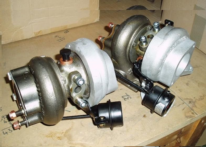

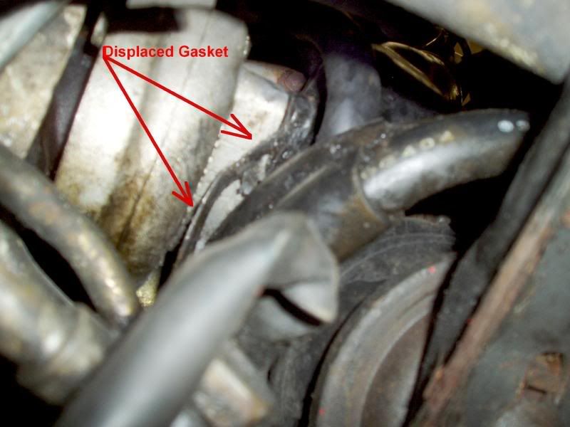

Sorry should explain, the gasket must of become dislodged when the new turbo`s were fitted by the owner ( yes he did it ) and when the bolts where tightened it crushed the gasket between the flanges.
The engine performance was returned to what it should be, now the turbo could spool up and the flange was not leaking.
:shock:
