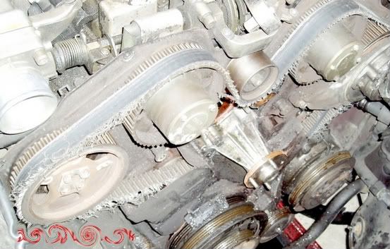

The background to this particular fault is as follows, a rebuilt engine from a small company with in house engineering cnc machining, heads and turbo rebuilding facility.
Car was collected from said builder and around 60 miles later the following was discovered after an engine noise was heard and seem to be getting worse, the noise was semi metallic with a scrapping noise in time with engine speed.
Jeff TT
  • Replies 161
  • Views 9.7k

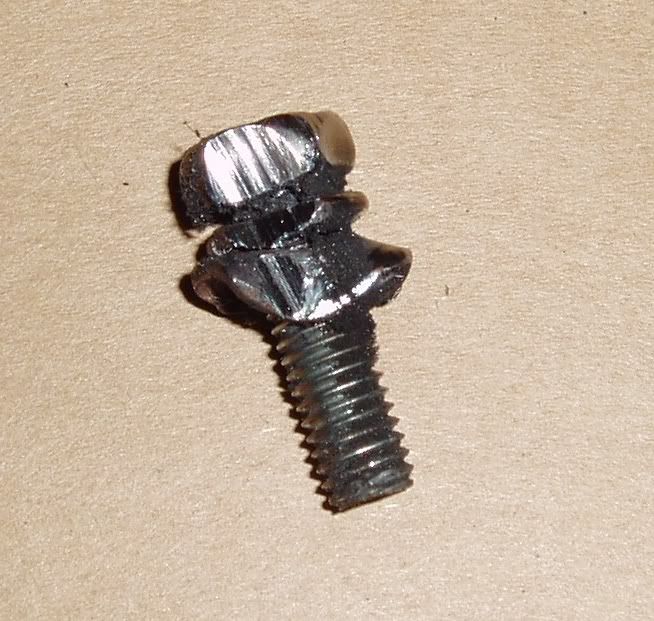

I would say a bolt came out like mine, but there's too much dust
Have seen similar results after a washer had been dropped into the lower timing cover and jammed underneath crank idler. Although the belt was even worse than that, shredded into 3 individual belts.
Well guys your all flipping close you clever lot.
Culprit below.
It was caught under the crank sprocket. Real worry is the "rebuilt" engine water pump was not replaced, did not bode well for the rest of the rebuild, however the engine had not been damaged.
Next mystery why the hell was that bolt there? never goning to know that one.
Jeff TT
Had the same on mine, got it out before it did any kind of damage
One thought I had was if it was the bolt used to release the belt adjuster after the belt was fitted and was left screwed in the adjuster slightly and worked its way out?

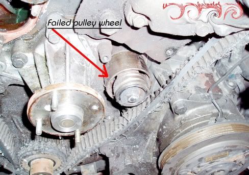

Ok another one for you, no foreign parts in this one so what do you think cause this?
Jeff TT
Bent idler stud perhaps causing belt to ride off or washer left off that sits between crank sprocket and damper?
HELLRAISER IS THE WINNER
Nice one matey:bow::bow::bow:
Culprit below
Jeff TT
Did that drive in like that Jeff?
Amazingly yes :shock:
Jeff TT
Jesus !! That must have been making a row.
Just a bit.

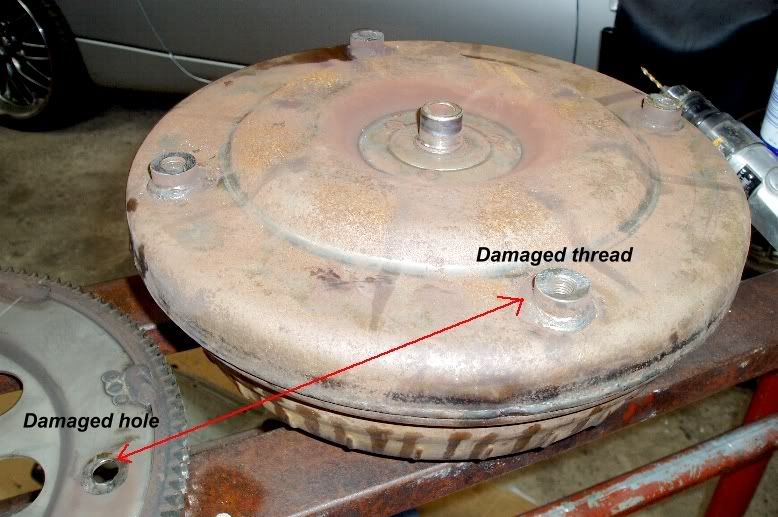

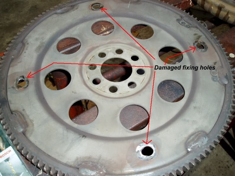

Ok another one for ya, what cause this damage? the noise this was making was amazing, owner thought it was his engine making the noise and needed replacing.
