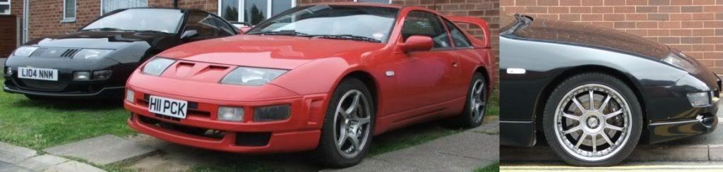

IMO, upgrading brakes and having a partially working ABS system is unsafe. Both of my cars have big brake upgrades, the black car has 345mm discs & stock calipers(abs removed) and the red car has Wilwood 335mm discs & calipers but still has the ABS system intact and active. But the first time it does something strange I'm ripping the entire system out, no question.
